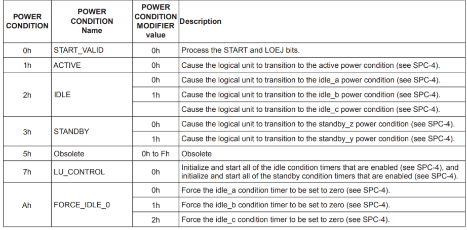

you can run sdspin sdx down or sdspin sdx up. Which vers of OS are you on as in 6.9.2+ the UD devices should spin down automatically.
if you want to use sg_start
sg_start  --readonly --pc=3 /dev/sdx
pc is the power condition. 1 is active, 3 is standby.
