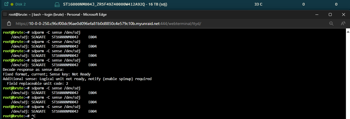

17 hours ago, doron said:
@valiente, can you, after the device spins back up (ie after the SMART message), issue, again, only the last part of the command (the "sdparm -C sense /dev/sdi" part) and post the result?
Here is the result, ran it a couple of times before forcing spin-down, during and after:
root@brute:~# sdparm -C sense /dev/sdj
    /dev/sdj: SEAGATE   ST16000NM004J     E004
Decode response as sense data:
Fixed format, current; Sense key: Not Ready
Additional sense: Logical unit not ready, notify (enable spinup) required
  Field replaceable unit code: 2
Drive is still not down:
Oct 22 09:45:45 brute emhttpd: spinning down /dev/sdj
Oct 22 09:45:45 brute SAS Assist v2024.02.18: Spinning down device /dev/sdj
Oct 22 09:46:05 brute emhttpd: read SMART /dev/sdj
I was doing this with SDJ drive today as SDI was being used at the moment.

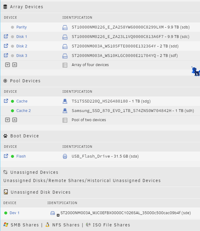

Helo! Would this able to Spun down Unassigned Drives? Have a Issue where the plugin seems to works just find with drives in array but seems to failed to spun down a unassigned drive(At least the lights stays green on the UI)
I'm planning to use the unassigned drive as a backup just in case something died while I'm gone
Edited by LunarstarPony

5 hours ago, doron said:
What hard drives do you have in your UD where you experience this?
It's the ST2000NM003A, tho I do have the exact same drive in the array which spin down just fine.
The only drive that failed to spin down is the one that's unassigned.
What do you see in the log when you try to spin it down? Do you get a "spinning down" message? Do you get any "SAS Assist" message?
Dec  1 05:13:14 Lunar-UnRAID SAS Assist v2024.11.25: Spinning down device /dev/sdf
Dec  1 05:13:24 Lunar-UnRAID emhttpd: spinning down /dev/sdd
Dec  1 05:13:24 Lunar-UnRAID SAS Assist v2024.11.25: Spinning down device /dev/sdd
Dec  1 05:34:09 Lunar-UnRAID webGUI: Successful login user root from 192.168.214.152
Dec  1 05:36:44 Lunar-UnRAID emhttpd: spinning down /dev/sde
Dec  1 05:36:44 Lunar-UnRAID SAS Assist v2024.11.25: Spinning down device /dev/sde
Dec  1 05:36:52 Lunar-UnRAID emhttpd: read SMART /dev/sde
Here sde is the unassigned drives, sdd and sdf is 2 of the other drive that get shutoff automatically. seems to do a smart read a lil after.
Like in other cases reported here, seems like something is spinning this drive back up right after it's being spun down. That could be code in UD (scanning?), in which I'm not too fluent. Will try to take a look later.
Couple of complement questions - just ruling out different angles:
- Do you have other, non SAS drives in your UD? If so, do they spin down properly and stay spun down?
- Do you perhaps have this drive mounted with a file system that's being used?
All the HDD drive in my system is SAS which all seems to spin down just fine beside the only one thats unassigned, as for mounted it shouldn't be, at least I never manual mount it.
Here's the diag attatched if required
lunar-unraid-diagnostics-20241201-2029.zip
