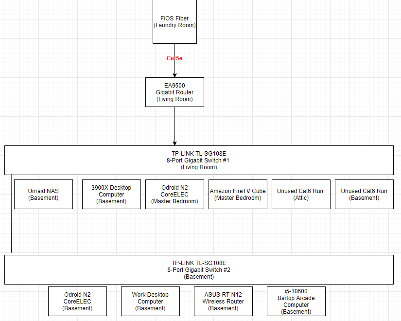

While I won't pretend to know much about iperf, I ran a few tests and confirmed that when there are NOT heavy downloads, there is 900+ Mbits/sec between my Unraid server and the Kodi clients. I've also confirmed that when there is heavy downloading on the network, the iperf test results drop accordingly to about 60Mbit/sec, so clearly it is having an impact.
I've attached an image of my network. I was under the impression that using Gigabit switches would enable 1Gbit/sec across each ethernet port -- which is to say, I could have a computer pulling 900+ MBits directly from the internet, while the Kodi devices also pulled a combined total of 900+ MBits from the NAS.

Which computer(s) is the Internet download going to on your chart?
Are both of N2's buffering and does it occur at the same time.?
There are firmware updates for the TL-SG108E.  Have you applied them?   (I normally do NOT like to do firmware updates on devices like switches unless I have a big problem.  But you have a problem and a firmware update could be the solution. )
Is this a continuous download that is running for hours on end?   The reason I am asking is that this is about a 100GB of data in twenty to thirty minutes.  In approximately two and half hours, you would download a TB of data.  (In the time, we have been discussing this, you should have downloaded more than 10TB of data.)
EDIT:  They are up to version 5 of the hardware.  What version(5) are your TL-SG108E's?

Bartop Arcade is the device downloading
Both are buffering, yes. They are on separate floors so I can't test at same time, but if one is, the other would be. I've never found that it to be random.
Yes, continuous download that is running for hours.
Version 4.6

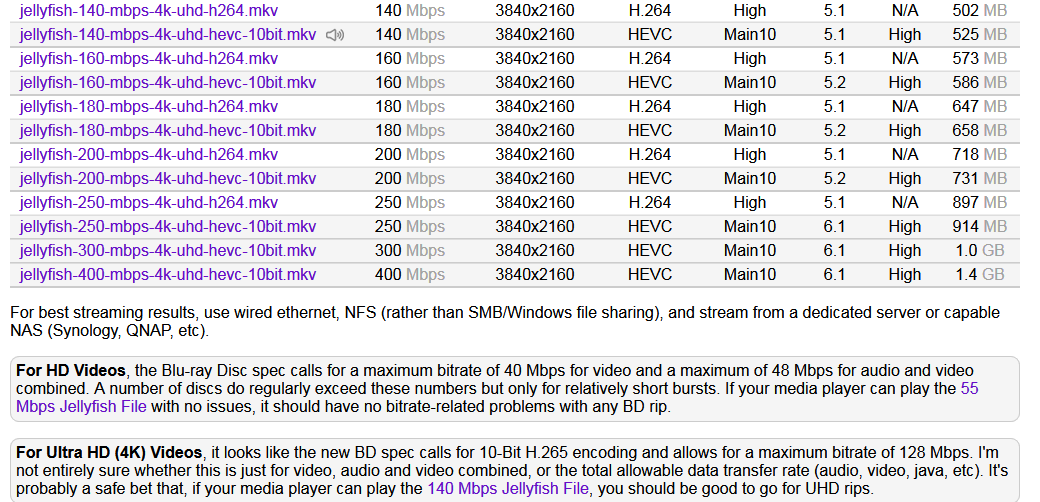

Quick aside question... For 4K playback, what is actually required? I keep seeing from Kodi wiki that you want to be able to play up to 140Mb/sec for stable 4K, but looking at Remuxes, I have yet to find anything over 80Mb/sec
There is one experiment that might be worth conducting.  First, look at these couplers:
      https://www.amazon.com/Coupler-Ethernet-Wenter-Extender-Adapter/dp/B07R5XBWY7
I see you have a 'spare' CAT6 run between the living room and the basement.  Plug the living room end of that spare cable into an EA9500 port.   Now use coupler(s) (and other CAT5/6 cables as required) to connect that spare cable so you have a direct connection between the EA9500 and the Bartop Arcade. Test and see what happens now.

UPDATE: Happy to report that replacing my Linksys EA9500 router with an ASUS RT-AX88U AX6000, turning on Adaptive QOS and prioritizing Streaming Media fixes the problem so effectively that I am now able to watch two simultaneous NAS to Kodi box streams of Lucy (4K Remux), WITH 100MB/s download going on. In real-time, the router essentially deprioritizes the 100MB/s download to about 80MB/s and the streams both are 100% stable. I'm shocked. Not to mention, with WIFI 6 speeds, I'm getting over 500mbps from the router to my computer which is in the same room.
