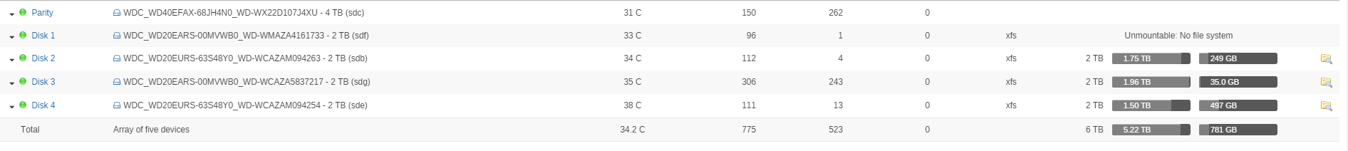

I was using the Parity swap method to replace a bad drive with a larger than parity drive so I followed the guide. I "copied" to the new parity and after that was done, it was doing a data rebuild on the Old parity drive (in the bad disks slot) and now it shows this:
I attached my Diag.
EDIT: I should also point out that the Unmountable Disk was my old Parity drive (that I thought was still good) but I do have a new 4tb drive I had planned to replace that disk (disk1) with after this process was finished. Don't know if thats still an option or if I lost everything on disk1 already.
