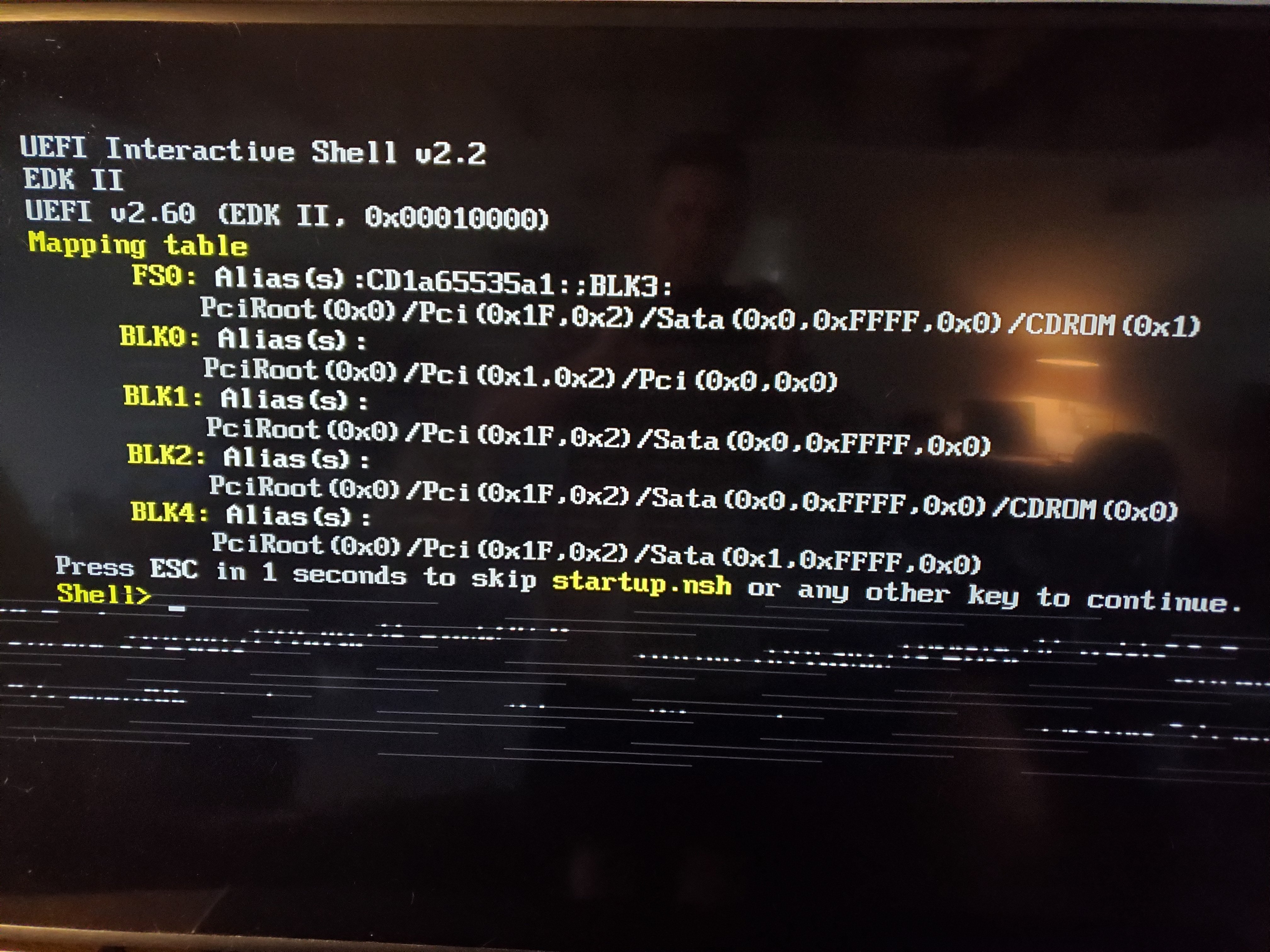

Can reverse proxy affect my W10 VM?
I have a Windows 10 VM that I havent started in a week or so but it had been working perfect and very stable. I even ran speed tests on it which stressed the CPU and GPU to benchmark them....it was all running excellent. Something I have changed over the past week has affected the VM and now it wont boot up. When starting it goes into the blue screen where it has options for trouble shooting or power off and I cant find any way to get it to boot up.
I setup reverse proxy with Swag for Nextcloud and also have Sonarr, Radarr, Lidarr, SAB running through the reverse proxy.  I don't see how it could be affecting a W10VM but maybe something going on behind the scenes that I don't understand???
OHHH, I also have my network cards configured differently since then where I bonded Eth0 and Eth1 together making "br0".
In my VM I just tried br0 and virbr0 but neither made a difference....however could this be affecting it??  Do I need to add "new route" in the routing table of the network module?

Its been working fine, I even had the GPU passed through (Radeon RX580) and have used them a lot and started/stopped the VM many times.

Well I've gone about as far as I can with this....I'm not sure what it going on. I've tried changing several different settings. Not sure what the issue is.
Hoping someone can look at some of this that I posted and give me ideas of directions to look into. I REALLY dont want to have to delete it and start over from scratch, reinstalling Windows, getting it all setup, downloading updates, etc.  I'd prefer to just figure out what is wrong with this one and get it going.
Try creating a new VM, but select the current vdisk. It's the equivalent of moving a hard drive to a new tower.

Before I ask these stupid questions, let me paint the scene a bit....I'm not a 'computer guy'....prior to a month ago I'd never even heard of a VM and didn't know it existed. Unraid, servers, VM's, networking.....all this stuff is very new to me so please overlook this ridiculous question  lol
Okay, so to clarify.....I think I would need to delete my current VM before I can create a new one, right? Then in the new one, I would point it to mnt/user/domains/Windows 10/vdisk1.img  <--- that is what is listed in my current VM in the field "Primary vDisk Location:" its set to "auto" but then in gray, out to the side it shows that pathway.
When I do that, it will keep my windows and everything with programs/updates I had installed in Windows, ect? All I need to do is create the new one and redo the settings in the template, correct?
I ask about deleting the old one because when I tried to create a new one I got a error saying "
VM creation error
operation failed: domain 'Windows 10' already exists with uuid 09cbf08a-64ac-043f-8c29-115e7e5b5fb6"
So I'm guessing I need to delete the old one before I can create a new one.

Recreating an entirely new VM didnt help. I made a copy of my original VM that was working great then I deleted that VM with its disk. Then recreated a new VM from scratch using settings that had been working.
It starts then brings up this screen, then the screen tears and I cant go anywhere and have to do a force stop. Also, eventhough that screen says press ESC or any other key while doing a 5 sec countdown...I've tried ESC and other keys several times and neither do anything....it finishes the count down then just sits there.
Any thoughts on why I am getting this screen?
