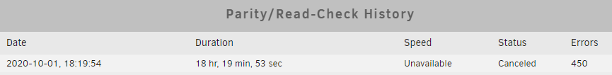

So today I ran a monthly parity check on my 34TB array.
A little over 9 18 hours in, I checked the status and saw that there were 450 errors listed.
Checked the current log and looks like one of my disks (Disk 4 / ata7) was playing up and having an issue.

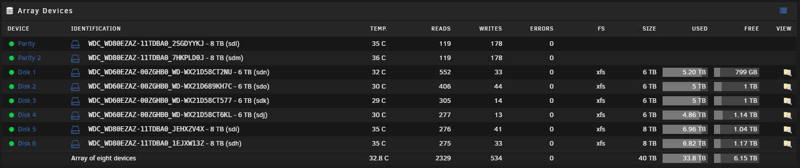

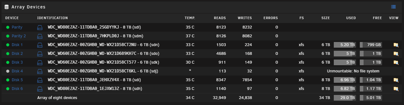

Now the array is mounted, Disk 4 is showing "Unmountable: No file system", with the option to format the disk available further down.
The files missing were still missing, but after a short time seemed to have reappeared. I haven't verified everything.
The array usage now seems to reports what looks like incorrect total usage:

Thanks @JorgeB looks like the array started back correctly:
I tried to browse for lost+found and couldnt see the dir, but I'll check with cli.
For now looks like its working.
