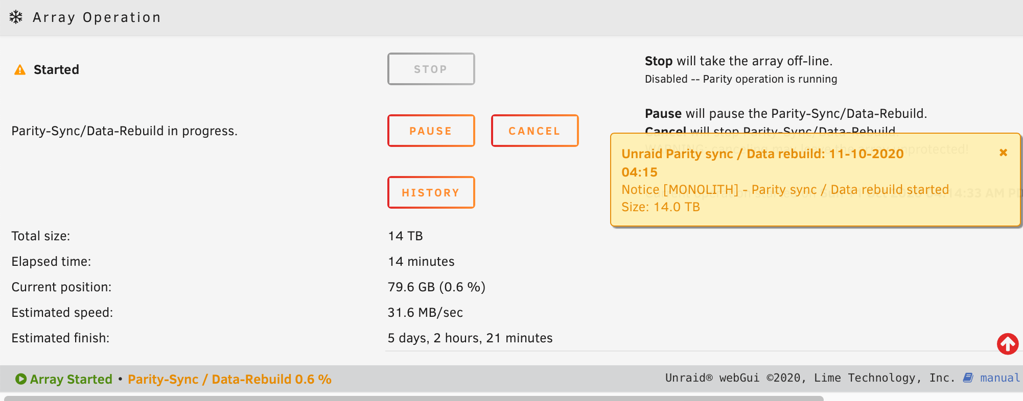

No still locking up, at 0.6% 14minutes in. Is there something else that I could be missing?
Are you using the server for anything else during this?
It was through the web browser on another machine and it had 3 tabs one was the router to get the ip of the Unraid machine, another with this page open and the last the was the unraid web gui. I have not set anything else up as of yet. I have been unable to complete the 1st parity sync. the furtherest I have got is 0.6%.

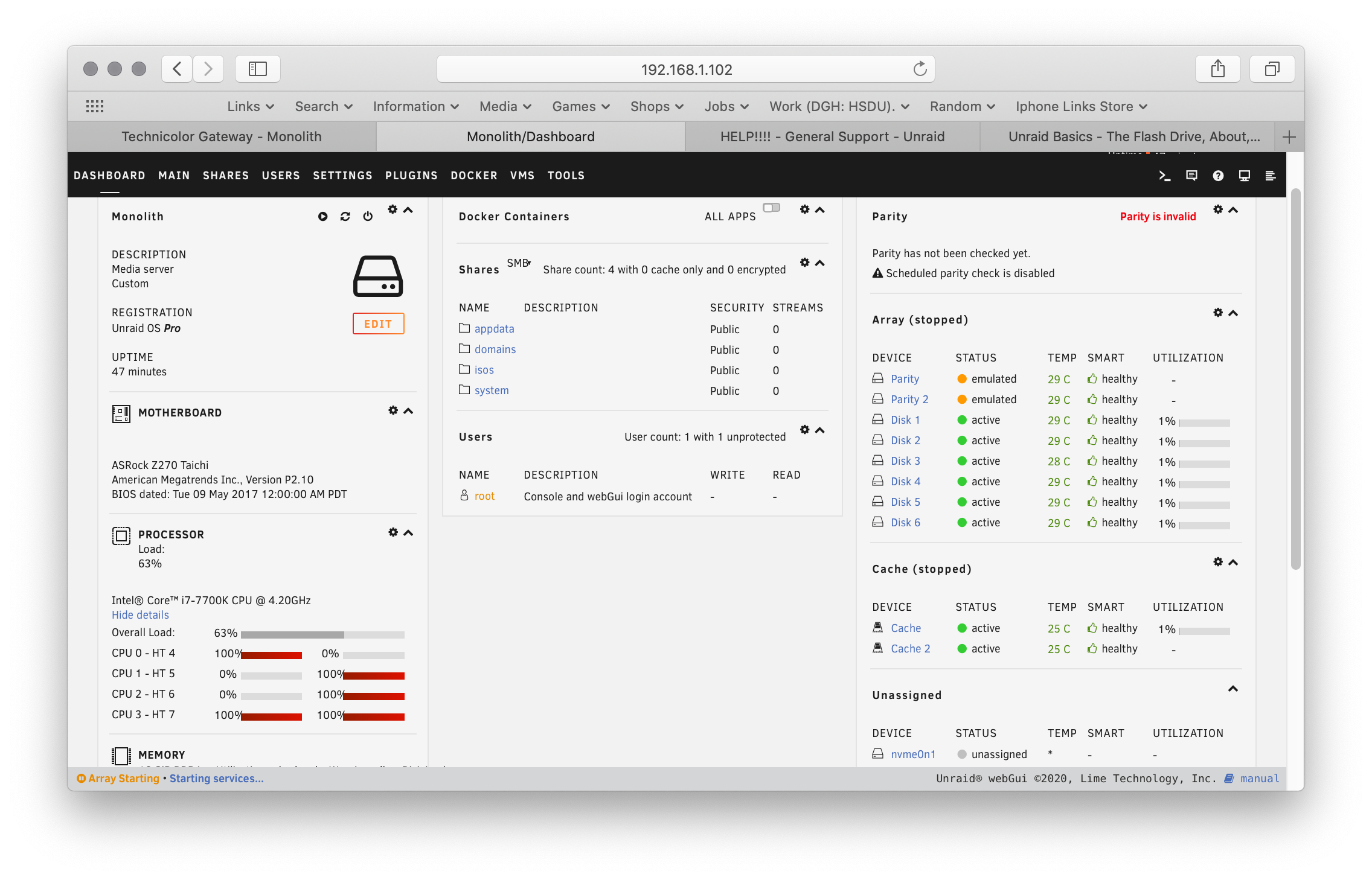

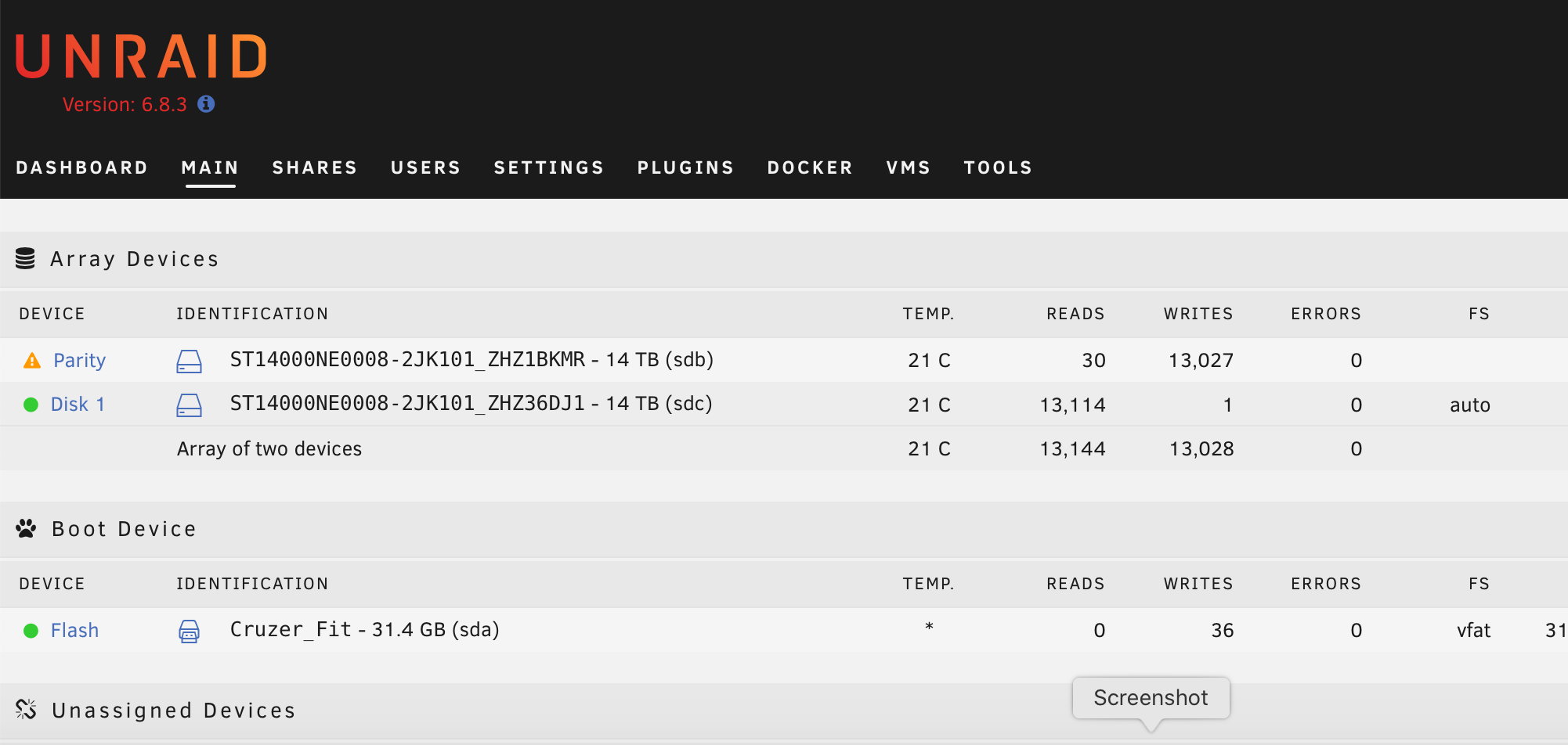

Okay something is wrong? it is saying the parity is invalid and on the main page it saying starting services but it has not I am not seeing the parity check?? but it seems that it has not crashed. What do I have to do?
sorry I forgot to add this screen grab to the lat post

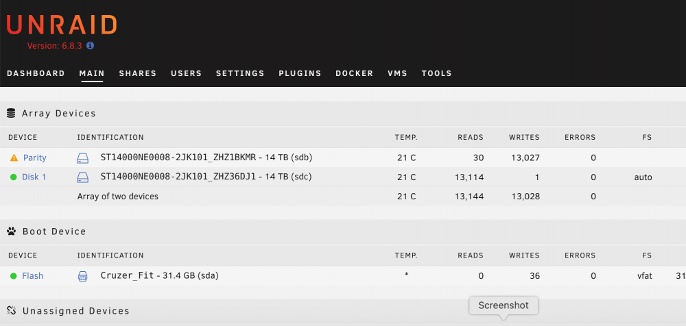

and it has locked up once again :( on 6.8.

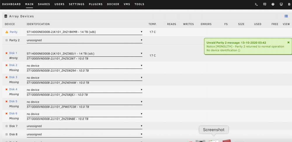

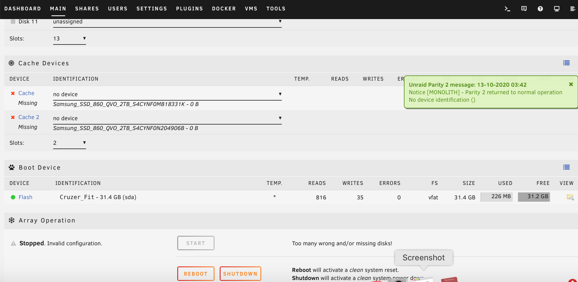

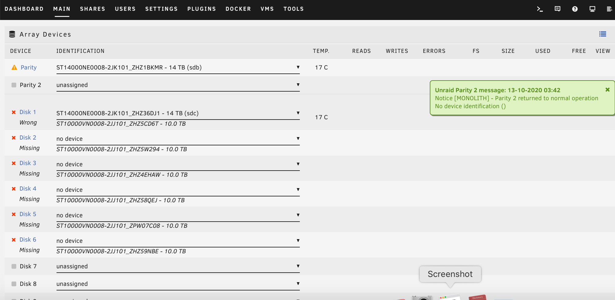

Hello. Sorry I did not get to looking at this yesterday. I disconnected all the sata drives apart from the parity drives and selected one of the parity drives on data 1 but it will not let me start an array because it is saying too many drives are missing? what do I do to get around this?
On 10/11/2020 at 4:06 PM, jonathanm said:
Set a new config
tools, new config

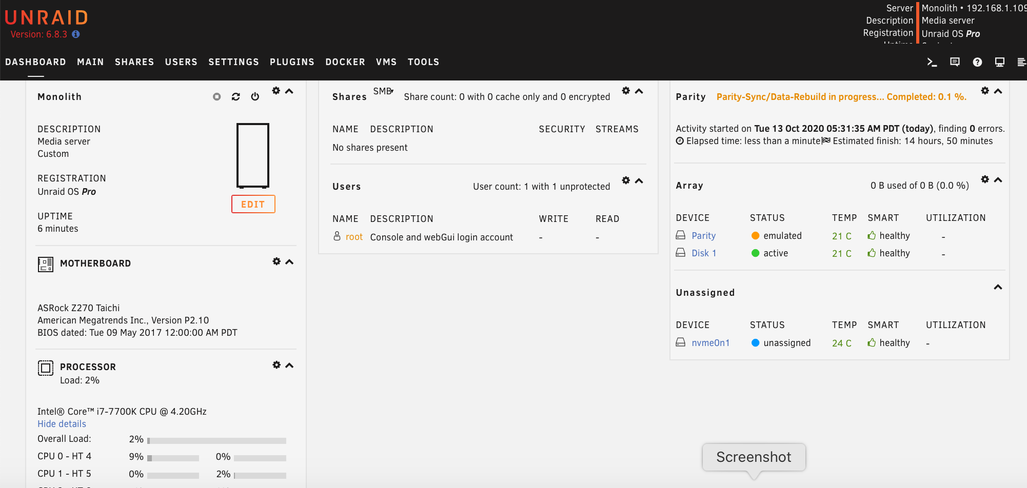

Hello, Sorry I done the new config and just started it going. One 14tb as Parity 1 and the other 14tb as data 1.
We'll have a result soon, since previous runs wouldn't go beyond half an hour.
