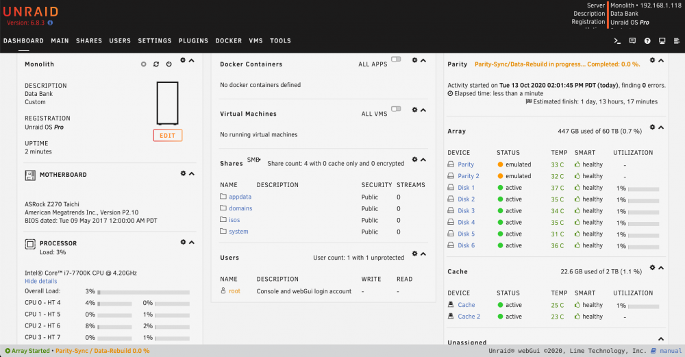

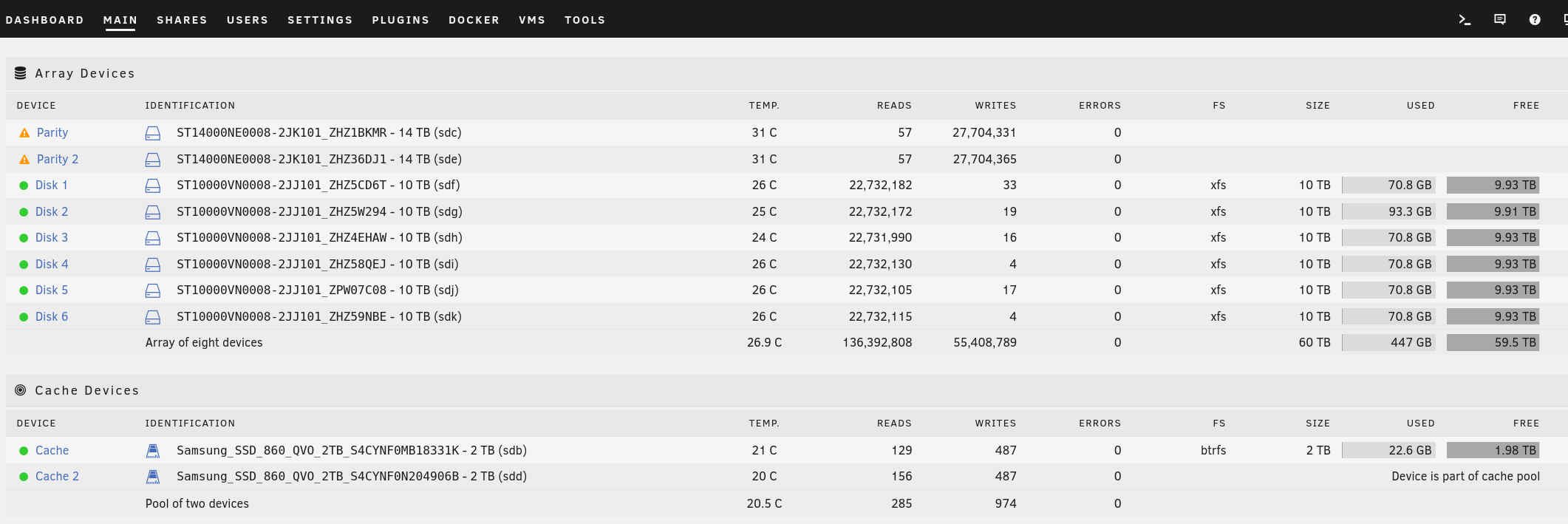

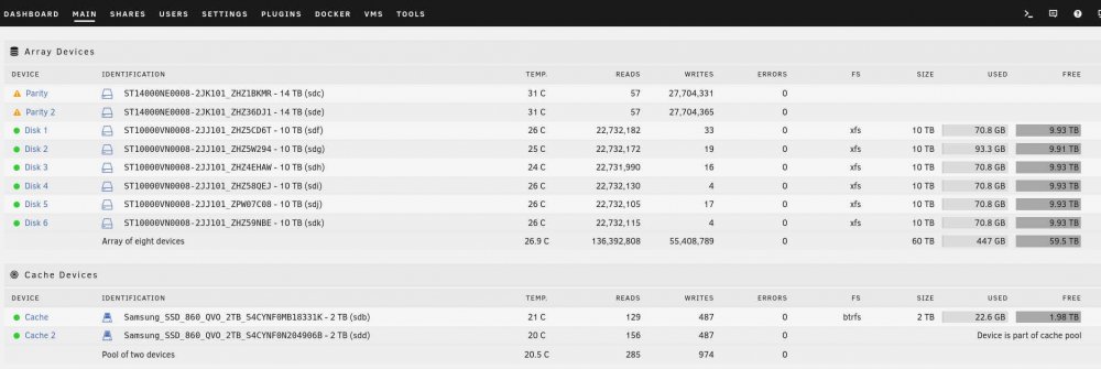

okay the full array 2x parity, 2x cache, 6 data drives and the m.2 unassigned.

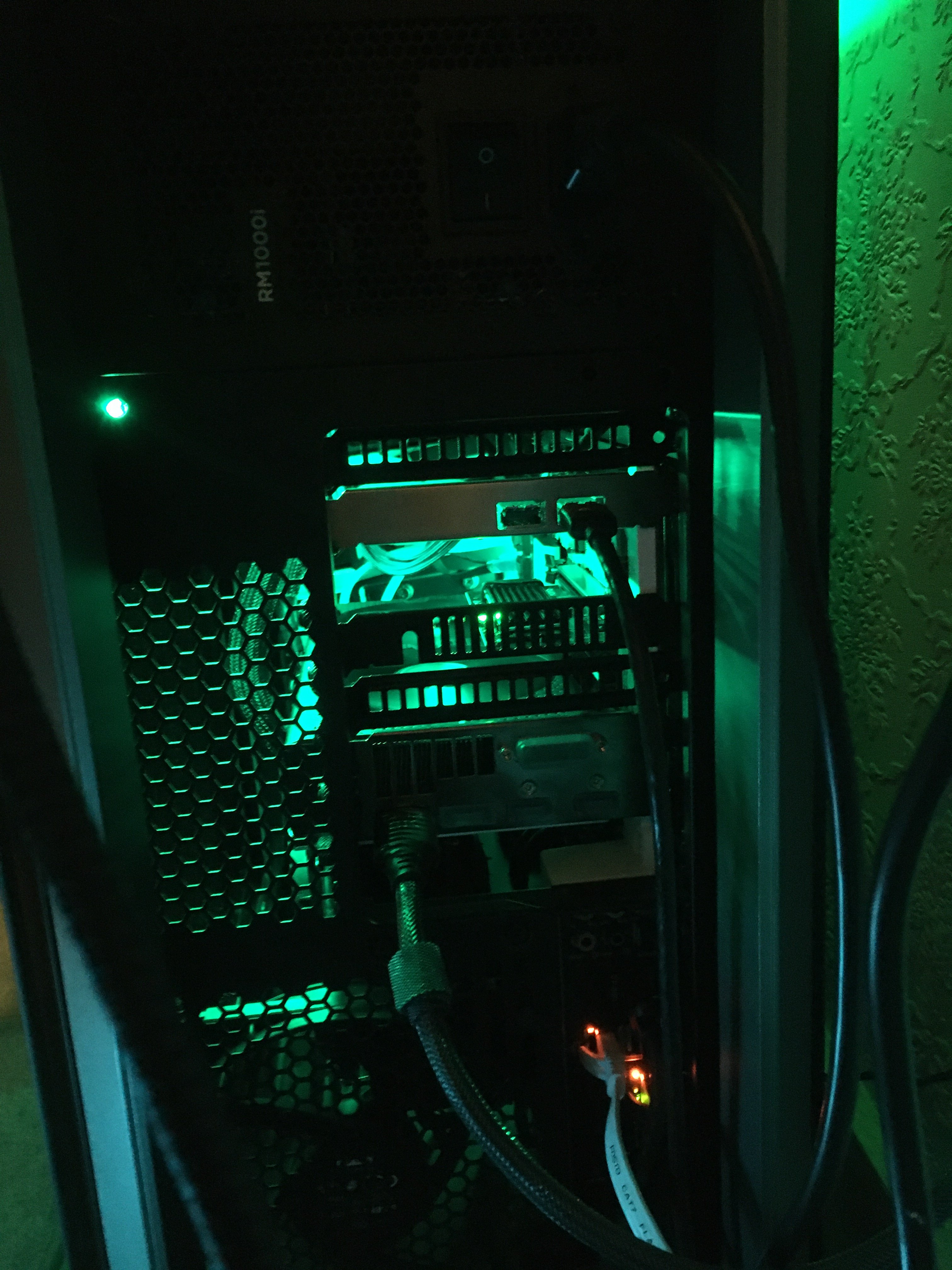

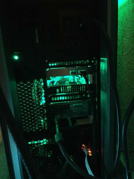

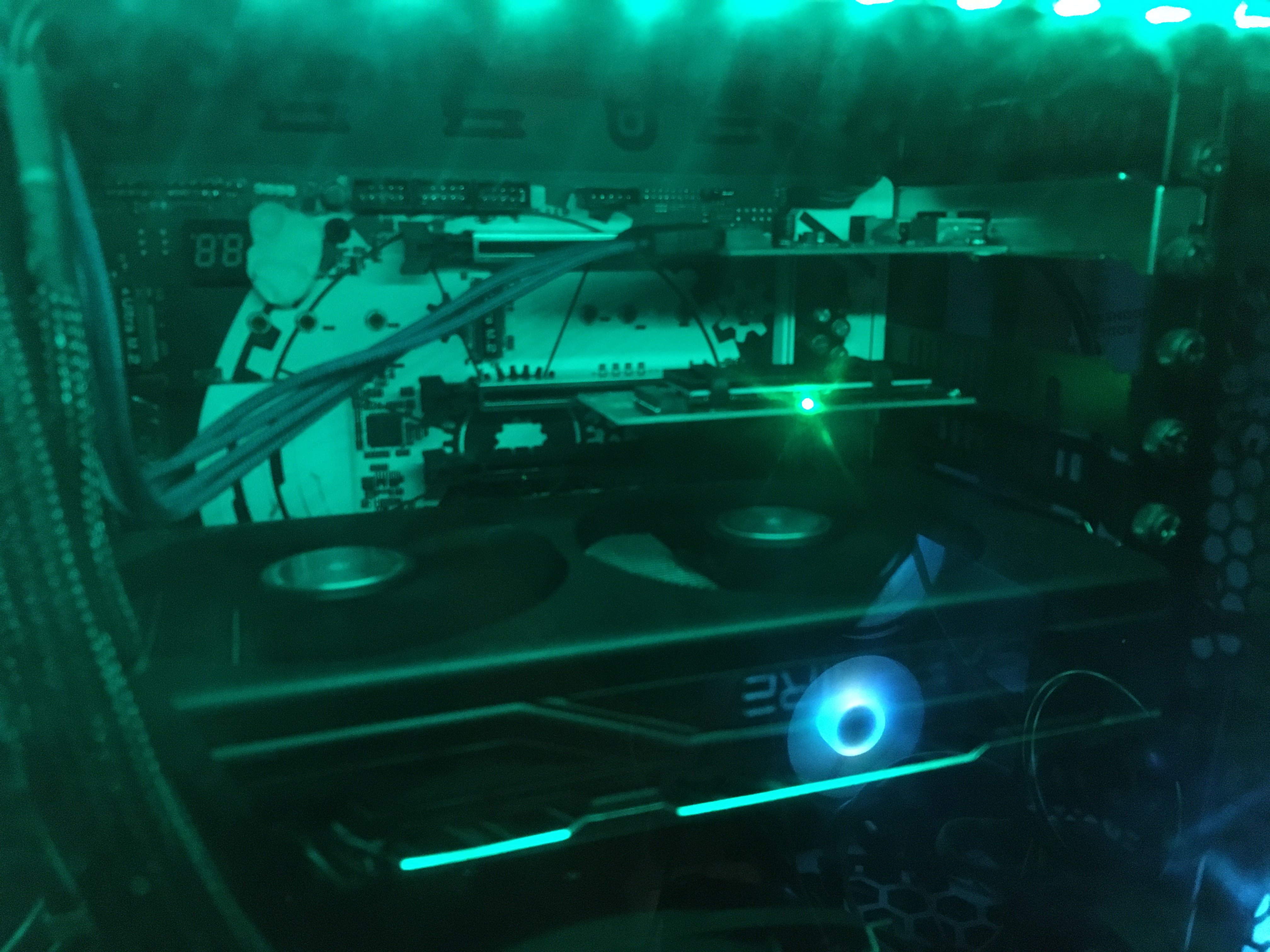

Sorry to bother you guys further are you aware of any good step by step guides for setting up a windows 10 vm with it's own dedicated gpu (AMD Raideon 580rx), its own dedicated USB ports (on a PCIe usb3 card) and using a persicfic drive the M.2 drive (samsung 970 eve plus 500GB)? and is there away of dictating one of the two networking ports on the motherboard? so I can basically use the unraid server as a windows 10 pc?
the pictures show the PCIe cards for the proposed vm, sorry I know the I/O pic is not easy to see.

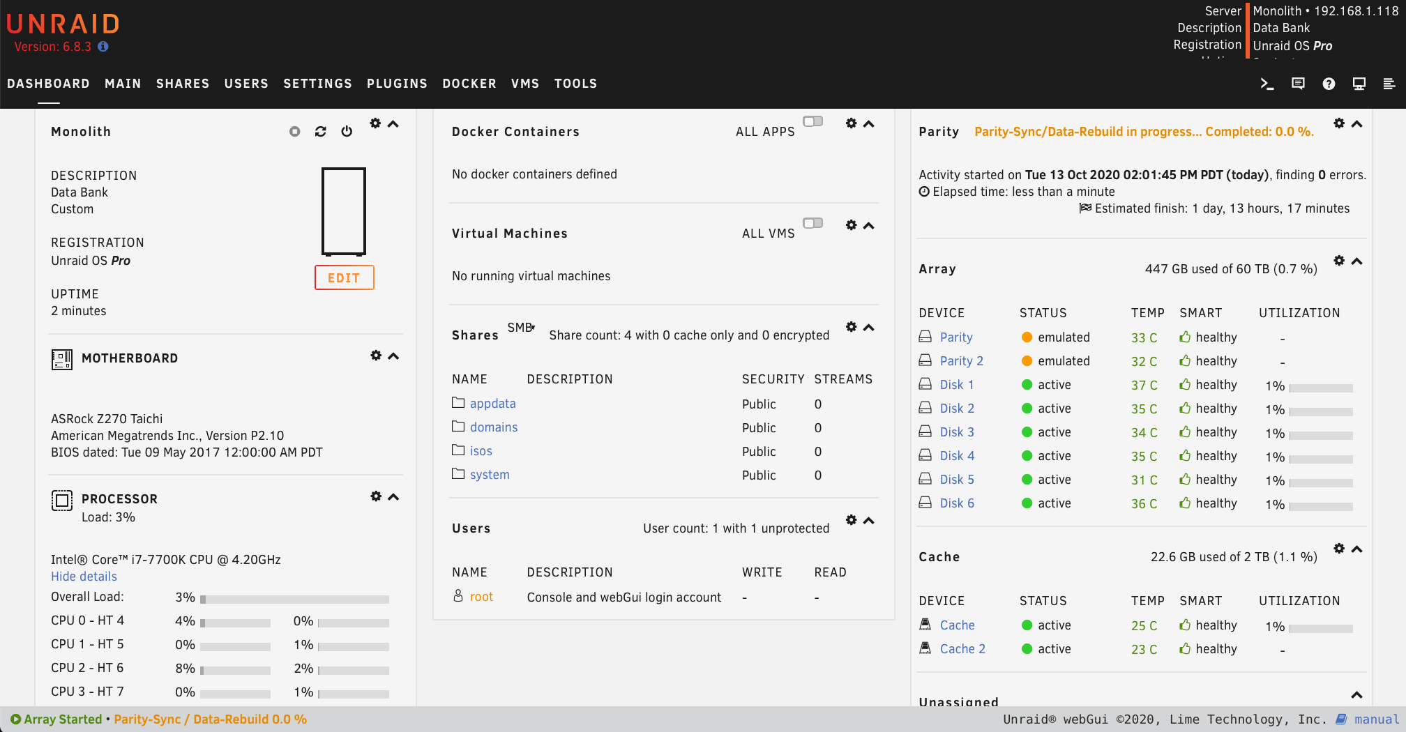

Let us know when parity rebuild completes.
Hello, Yes I will let you guys know I started the array up this morning (08:30) doing its parity sync and it is expected to take a day and a half! I do have a question If want to use the M.2 (at present unassigned) as the windows VM's 😄 drive do i need to add it to the array or can it be used as separate entity?

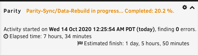

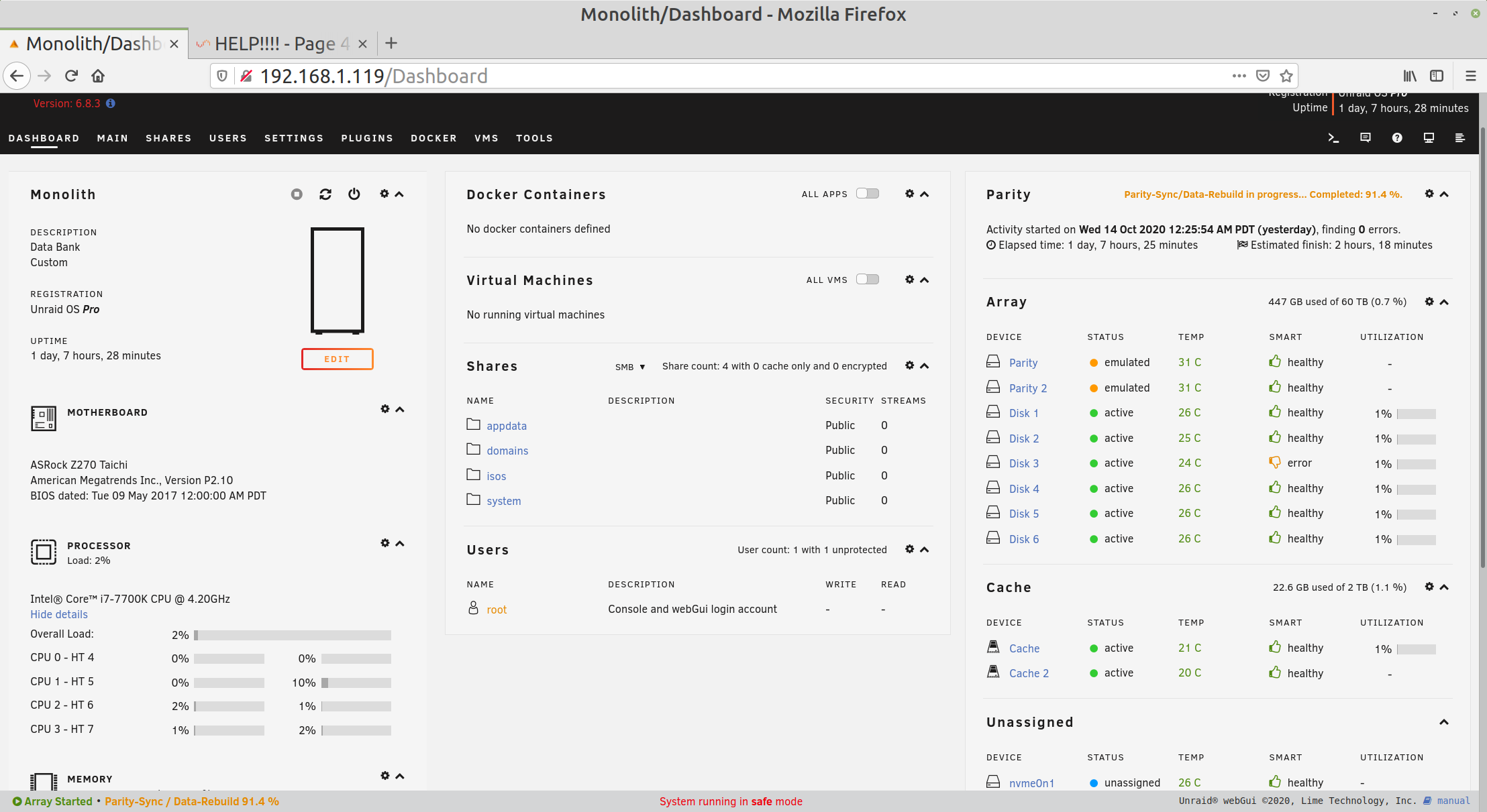

Hello just got in from work and it is at 20%
Okay nearly there. 2 hours+ pending. but looking at it is it saying 43,70 and 93 Gb used!? I am failing to see how since I have not put anything on there seems a little odd or are these for the the system?

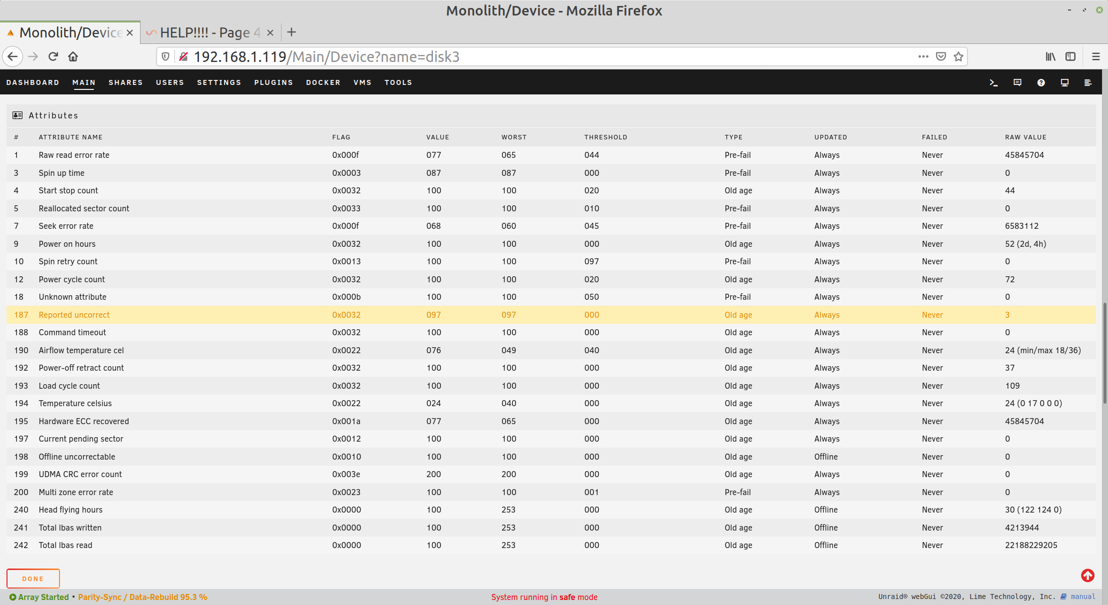

Report uncorrect: 3 ?
I hope that makes some sort of sense, because I have not got the foggiest?
but no that drives page it has highlighted the following
Once the parity build is done, I'd run an extended smart test on disk 3. I wouldn't be happy with a brand new drive kicking out errors like that.
It's possible that drive could have been the cause of your initial issues.
I agree I am not happy that disk three has errors I just do not have a clue what error is? and have got 20mins left for the parity snyc.
If you don't mind, I am going to break for an hour for food. then if you do not mind telling us how to get the extended testing started.

just done the short smart test downloaded the report (I think I have) and the result of test complete without error going to do the longer test test next
monolith-smart-20201015-1106(1).zip
How long is the extend smart test run? because it seems to be at 10%  now and is has not moved on.

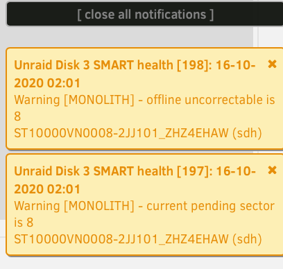

SMART test failed, disk needs to be replaced.
