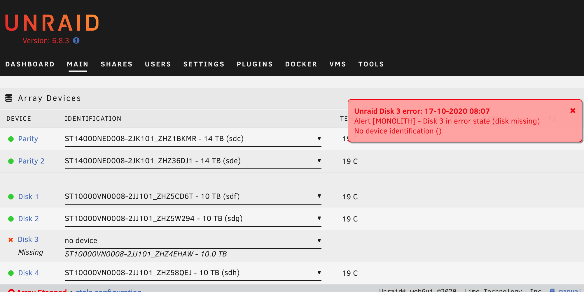

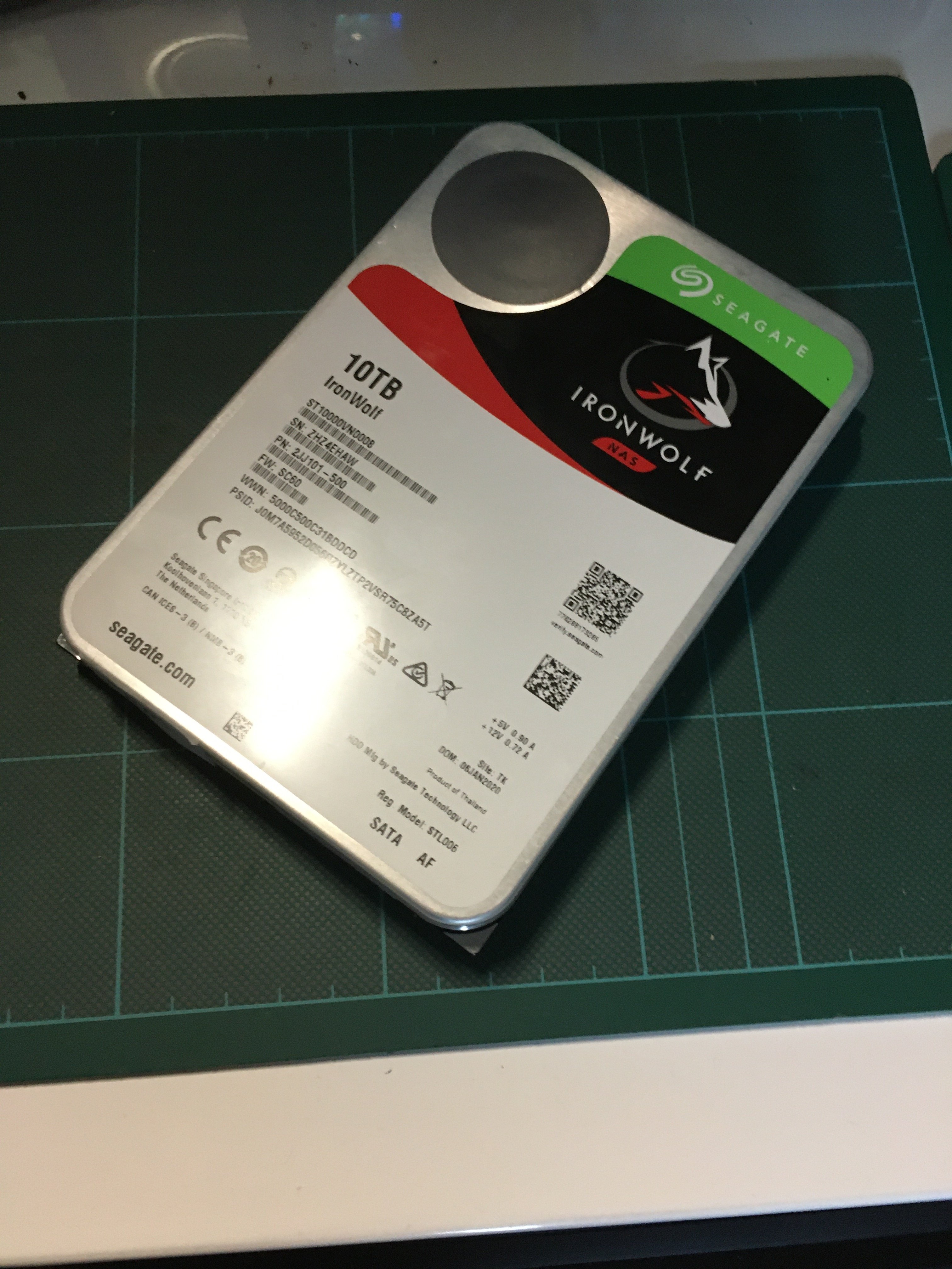

???? odd it is a brand new drive. could other factors that could of produced an error reading for instance a loose connection or something?
  • Replies 112
  • Views 9.5k
SMART test isn't influenciet by cables, disk should still be under warranty, and a failed SMART test is more than enough to get a replacement.
Probably got dropped on the floor at some point between manufacturing and now.
If possible you need to return for refund and get a new drive, manufacturers warranty will likely replace it with a refurb.

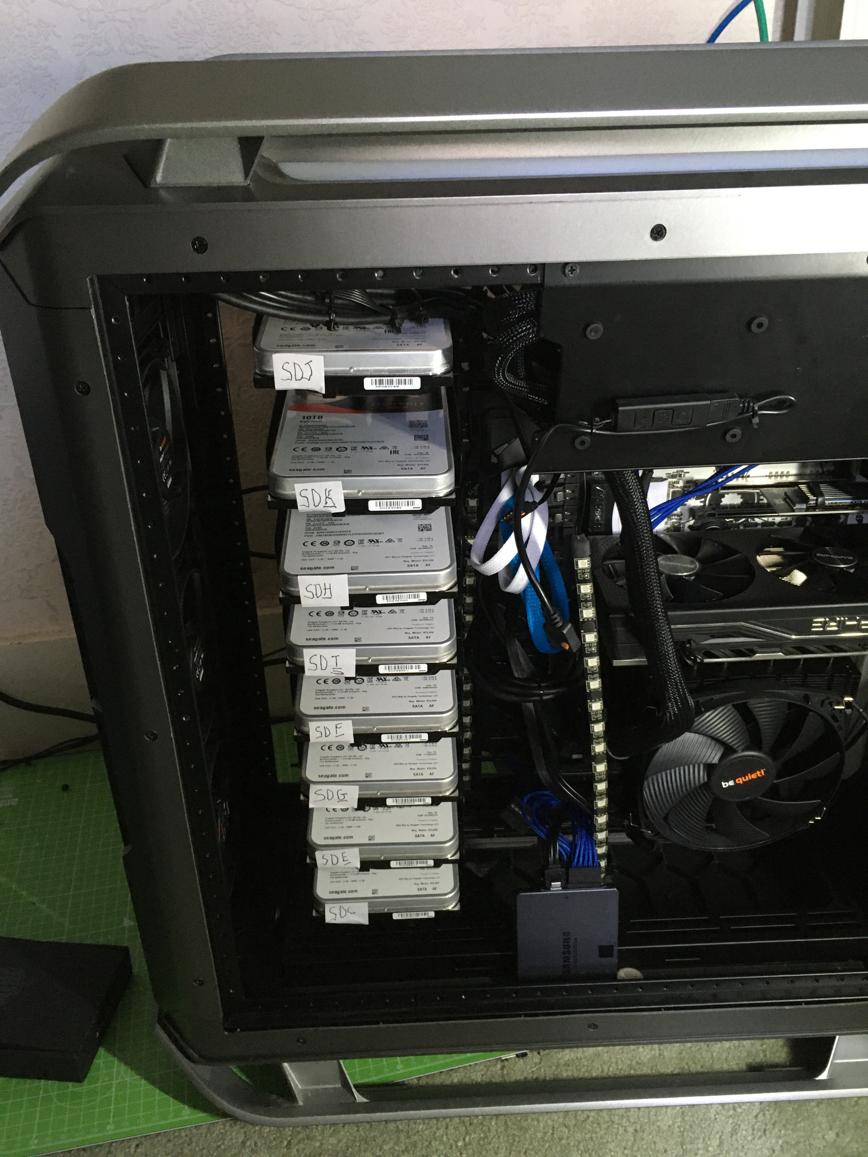

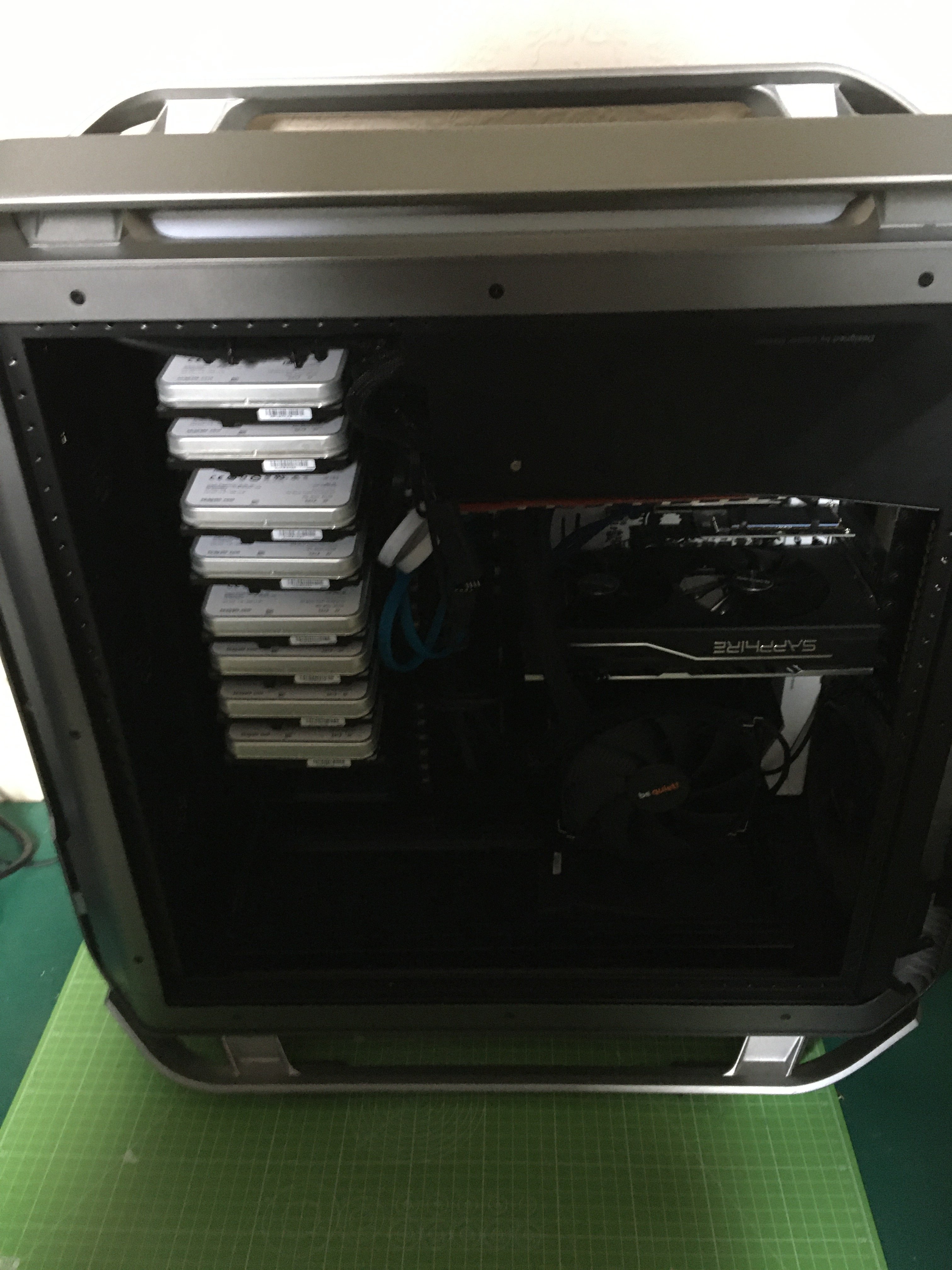

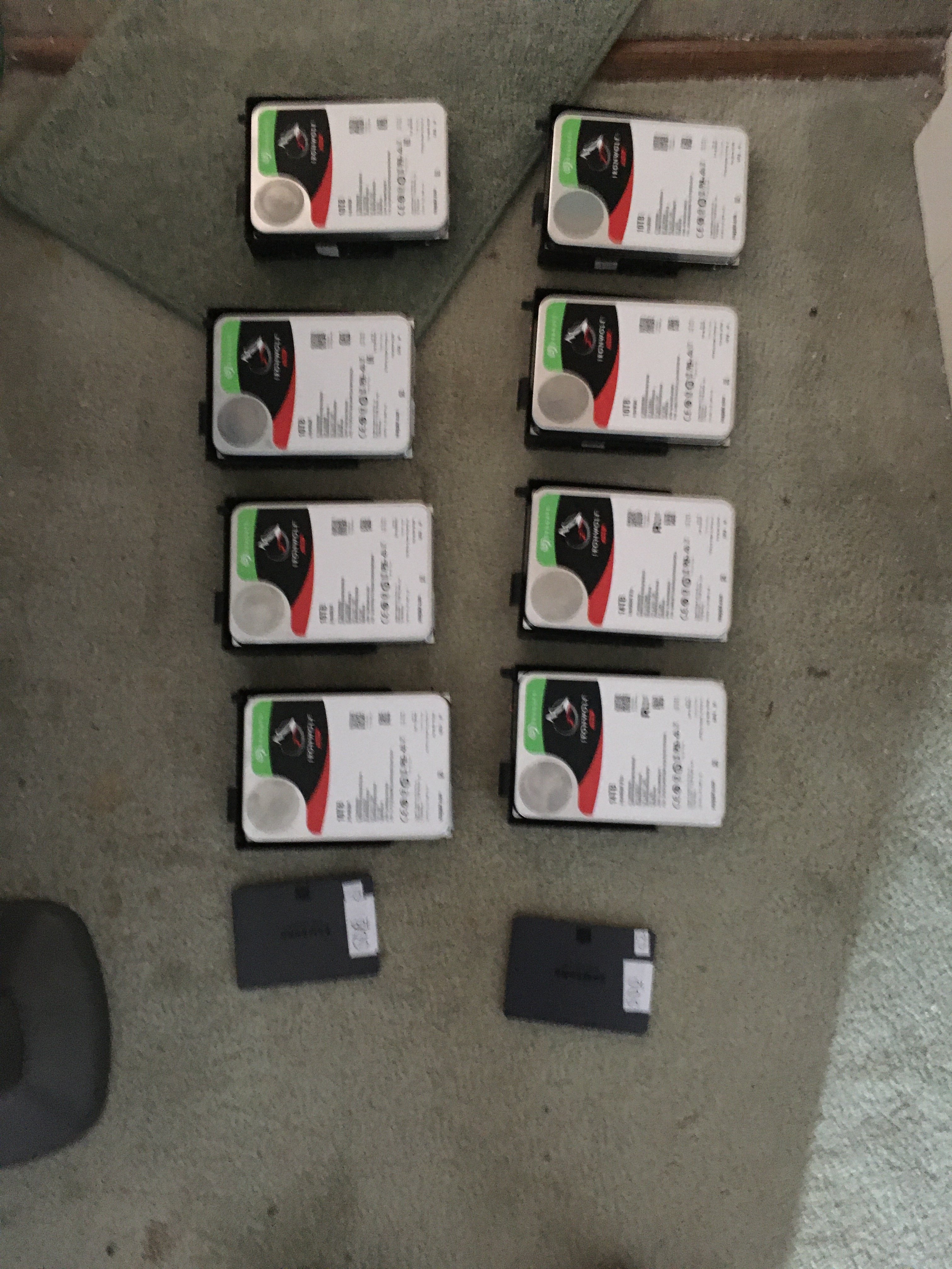

now I have got to find that 1 out of the 6! is there away that the system can Identify the hard drive name serial to a sata port?
Simpler and more certain to just look at the serial number printed on each disk label.

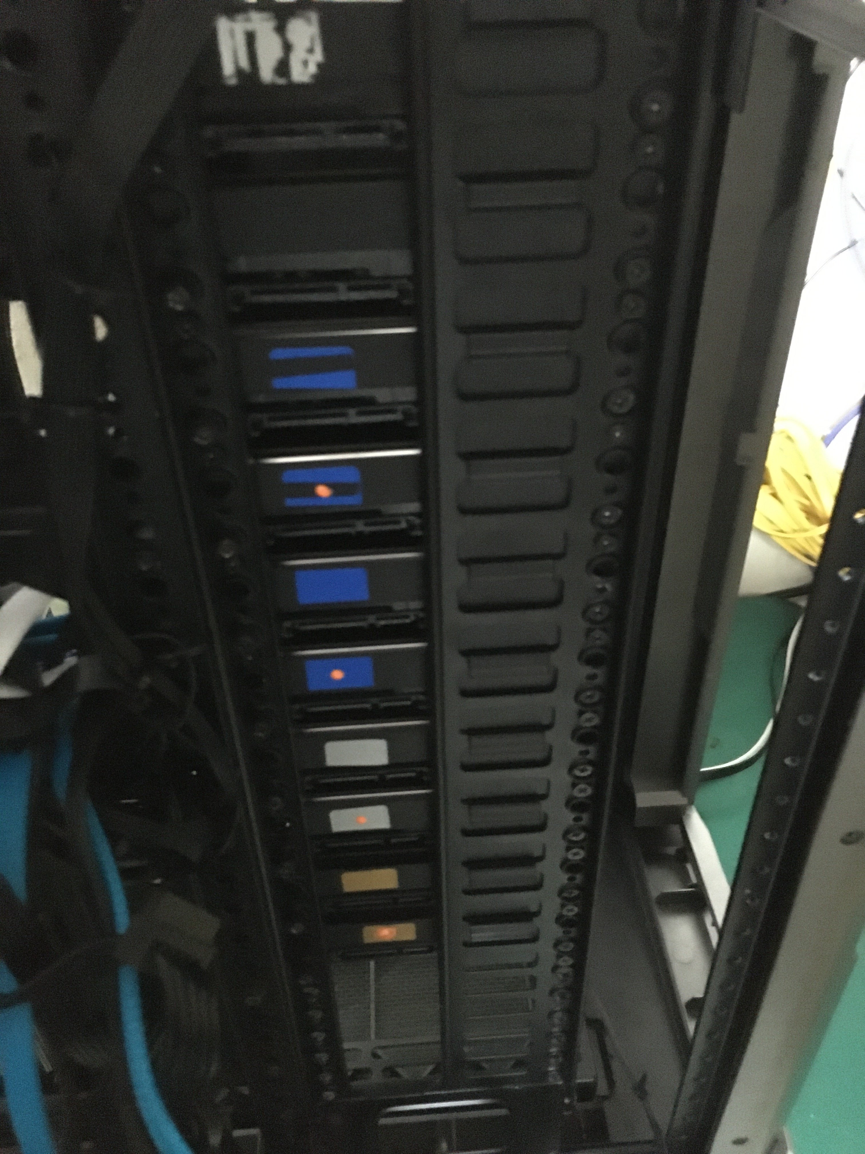

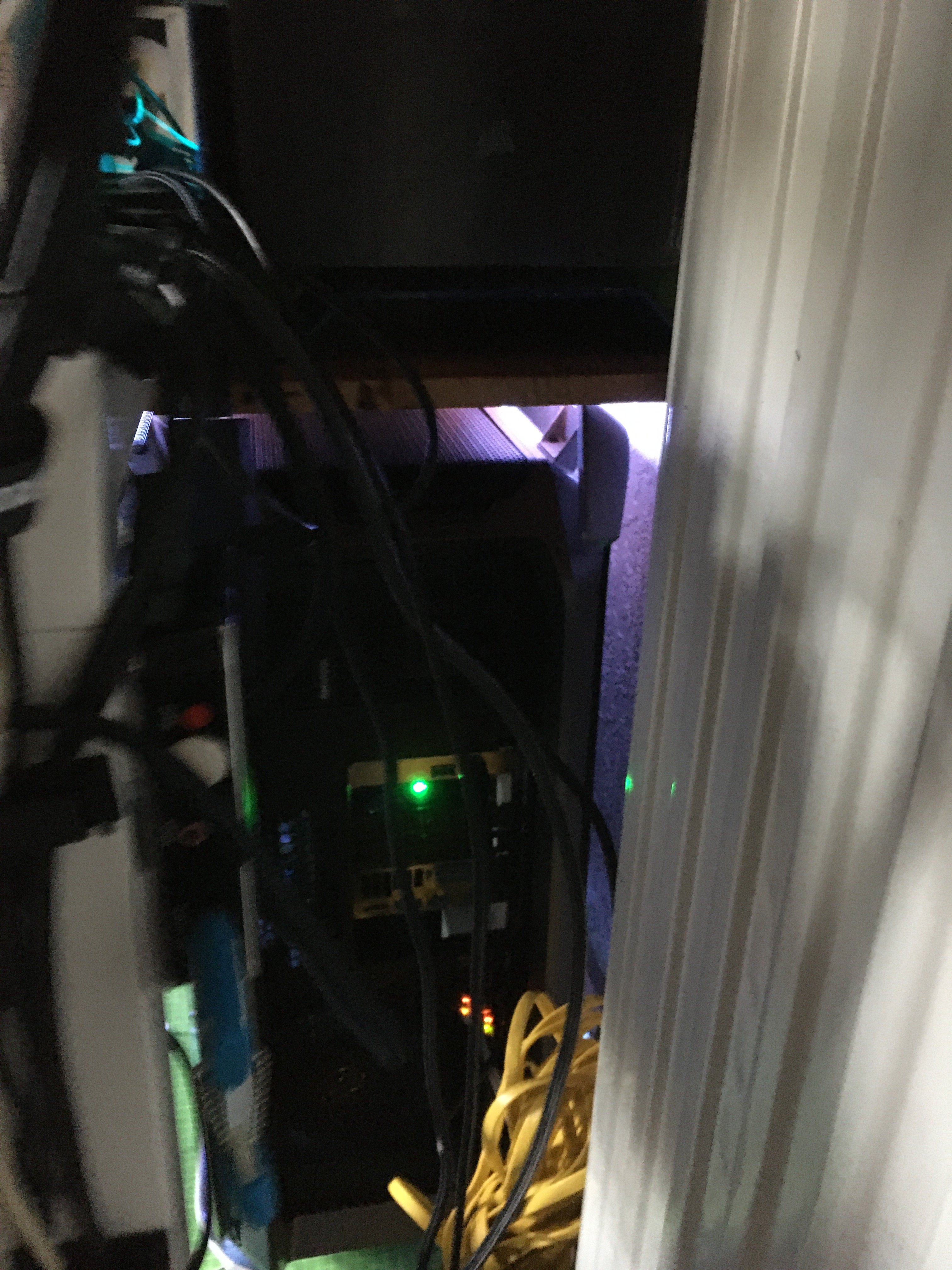

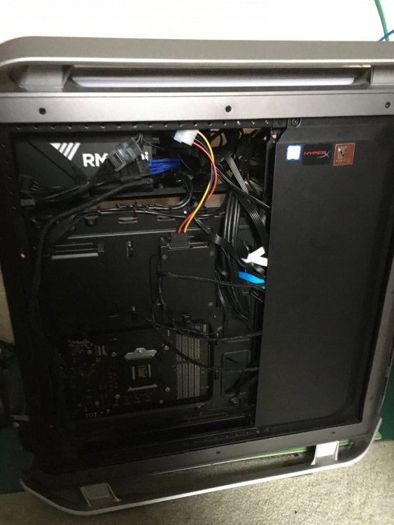

Hello Sorry about responding now I was making space to remove that one bad drive.
So to stop me have the issue of Identify which drive is what drive on the system. I have gone and labelled each bay by disk number and suck another label on with the drive letter eg she, she... but getting to it was the biggest problem since it is behind the desk and wider another tower it has take from are last post until now to retrieve that one disk.
I wish they put their label in large print (16ppt +).
The letter designation is not guaranteed to be the same after each reboot, and will often change when changing disks. A more useful descriptor is a few characters from the serial number that are different between disks. For many models, the last 4 characters is enough.
I will change the labels next time I am needed to go into the case. I just finished with the tidying up. I am also a bit unsure if all are correct because at 8x magnification the O's and 0's look very much alike :( on the drive labels. at least with a label change over I only need to get to the one side that is facing me under the desk :) thank you for the heads up!
Okay, just of an update: Got in contact with where I got the drive form and they forwarded me on to Seagate. I did not know doing a return was such an big production, but is was kinda self explanatory. So I am hoping to get the drive in the post tomorrow. Hopefully soon a replacement that works back into the system. just thinking that might have to be a weekend job. So please do be surprised if there is no activity on there until the replacement drive appears. the opportunity of replacing the drive gives me the chance to update the labels as suggested.
Update: The replacement drive has shown up today :) I will not be able to install into the machine until the weekend :( So fingers crossed.....

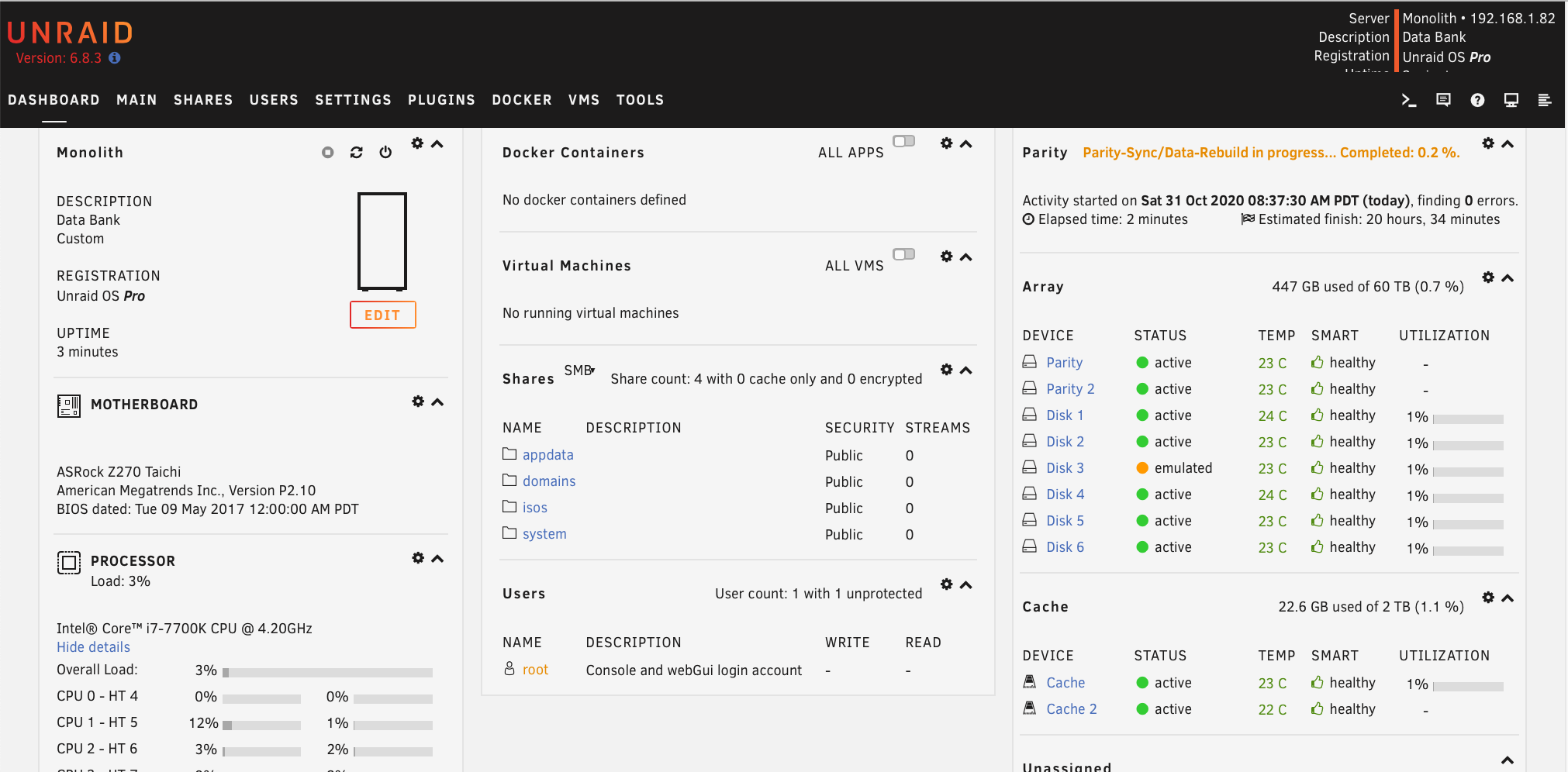

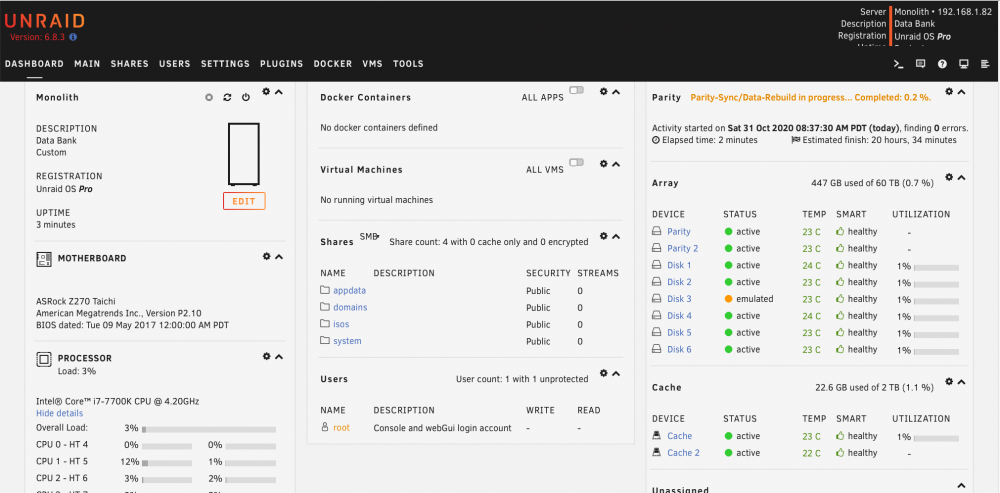

Got an update for you, the replacement is in and is rebuilding the array on drive 3/sdh which is the replacement.
Only 20 Plus hours to go. Fingers crossed that there is not another problem waiting in the wings to rear its head.

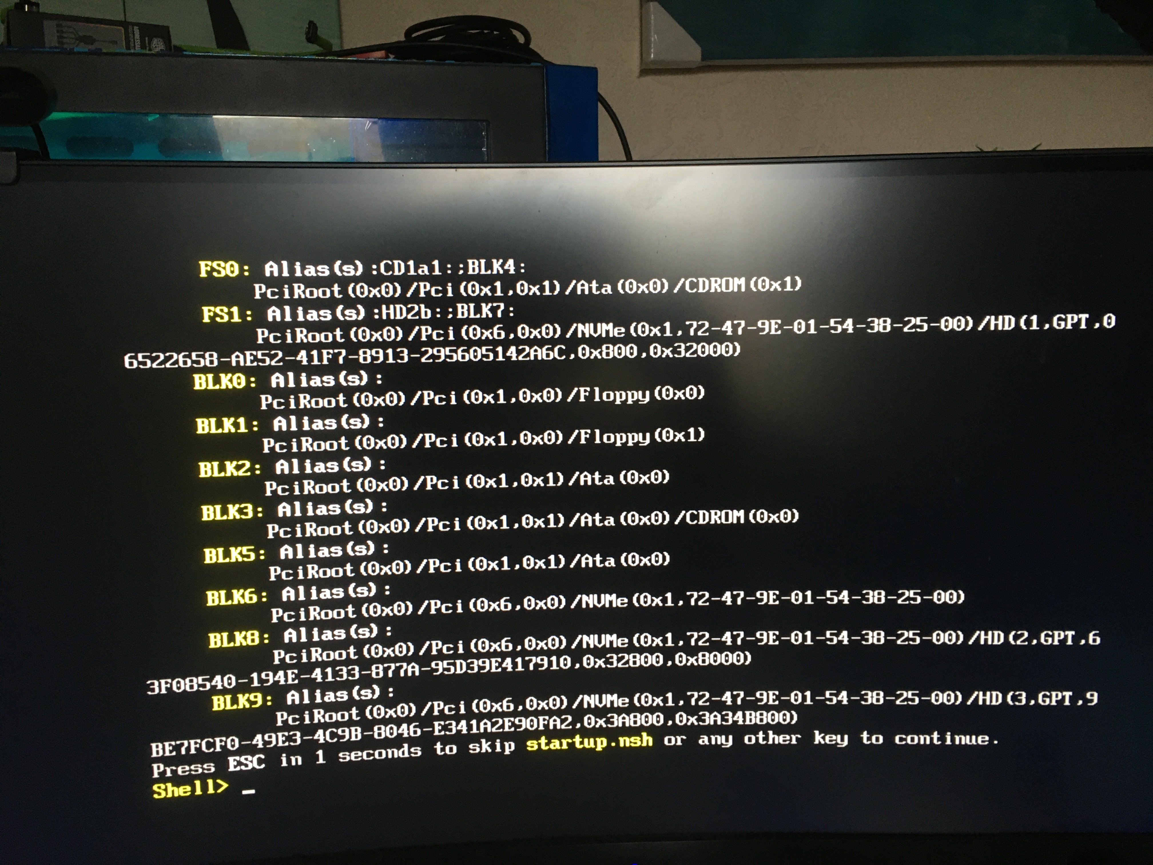

Sorry to call on you guys again.
but I having trouble with setting up a windows VM.

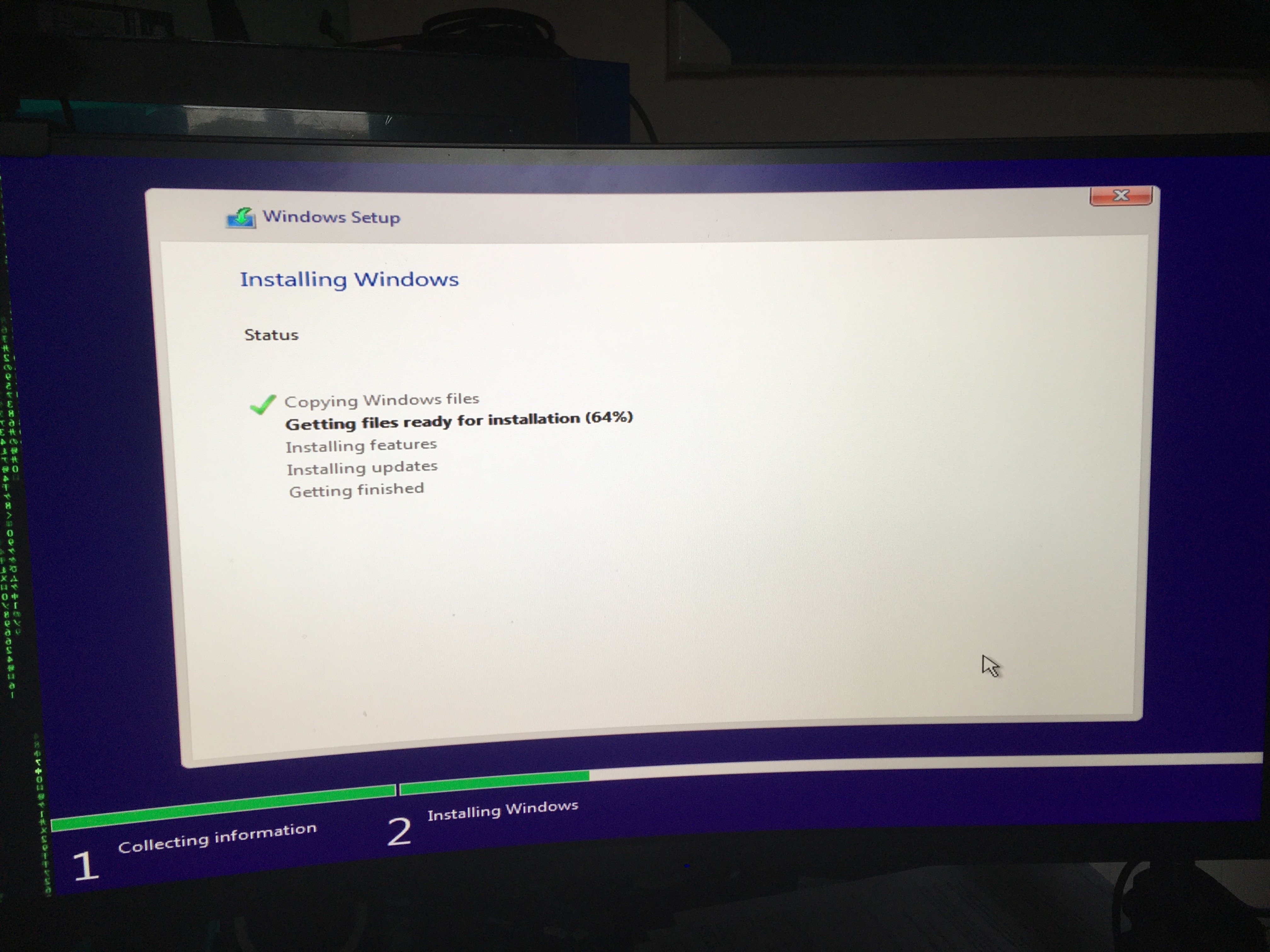

the farthest I got so far is I got to the windows installer choose a C : drive location and entering a licence key then it rebooted a few mins after and then I got to a UEFI shell text screen that doesn't seem to go any where
yesterday I didn't even get to the ms installer
my 1st issue was a blank screen which I found out was down to I thought I switched the onboard graphics as primary. So when I went to the bios that said it was set to PCIe so i switched that back.
So, that fixed the blank/black screen, phew.
This is when I 1st encountered the UEFI shell text screen after you hit any key to boot from cd
and it responded by putting up a text screen which doesn't seem to respond to the keyboard i tried hitting ESCAPE and typing exit to no luck there?
this is when I thought I will totally start again today:
checked the graphics in the bios that the onboard is primary and the virtual settings are enabled, which they are still.
redone the VIFO config tool.
graphics selected
graphics sound card selected
M.2 drives selected
and the USB3 card selected.
all in there own iommu groups thanks to the override in the vm manager set to downstream it separated out what was required.
I even used a freshly downloaded win 10 iso file from the microsoft site media creation tool.
and today got as far a couple of minutes after entering the licence key.
Please if anyone can point me to what i am doing wrong? or away to fix this, PLEASE, Please I would very much like to hear from you.......
PS: I have enclosed the VM log and the two screens one being the progress made and the other is that UEFI screen! :(
vm log.rtf
