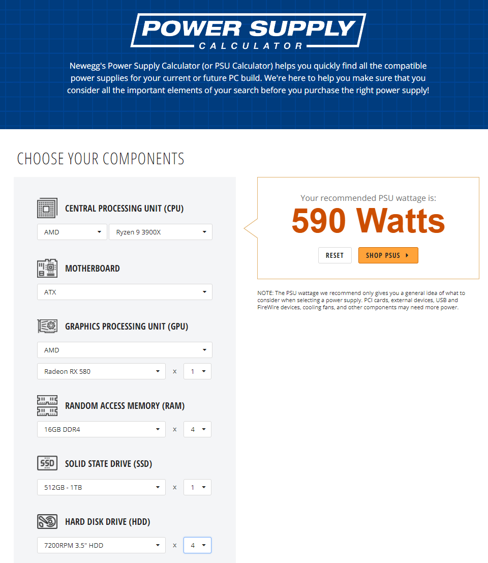

Below is configuration, and using PSU calculator i come up at 590W recommended. which is getting close. However, i really value the efficiency of the Titanium Seasonic

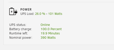

A UPS is recommned for unraid so that in the event of an outage you get a clean shut down. My APS brand UPS was ~ £60, $75. You only need a few minutes of run time for an automatic clean shut down. Most will give you a power draw. Just make sure it supports the APC plug in (via USB)
Alternatively you can pick up a power meter than plugs into the wall fairly cheap £10, $12 which can be usefull to see what uses the most power. Off topic, but my old fridge freezer is a power hog using nearly 3x the power combined for a later fridge and freezer with more space. It's on the replacement list now!
APC plugin in Unraid
Note, this is at the wall power so at 90% efficiency means real consumption of 90W
As for your power supply, The calculator recommends 590W which has a fair overhead to keep you in the efficiency sweetspot. Realistically your PC will be peaking around 350-400W. I'm only at ~400W with a 3700X and Vega 64 so I'd leave it as is for now.
If you add another GPU then I'd look at an upgrade.
