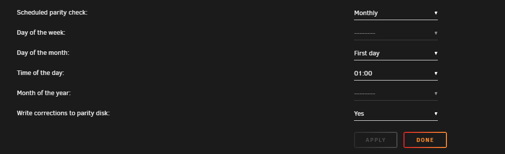

In Settings - Scheduler - Parity Check, there is an option to write corrections during the scheduled check or not. The usual recommendation is No. Check that setting and let us know and also what time the check is scheduled to start. I'm trying to sort through syslog to see but a lot of nvidia related spam in there.
@trurl I know the spam to which you are referring.  I dont know of a way to get rid of it as it is related to nvidia unraid, but i forget how.  Here is the parity check schedule and corrections setting.  Thank you for your time on this!

So the scheduled parity check was configured to write corrections to parity. Did you let it complete?
