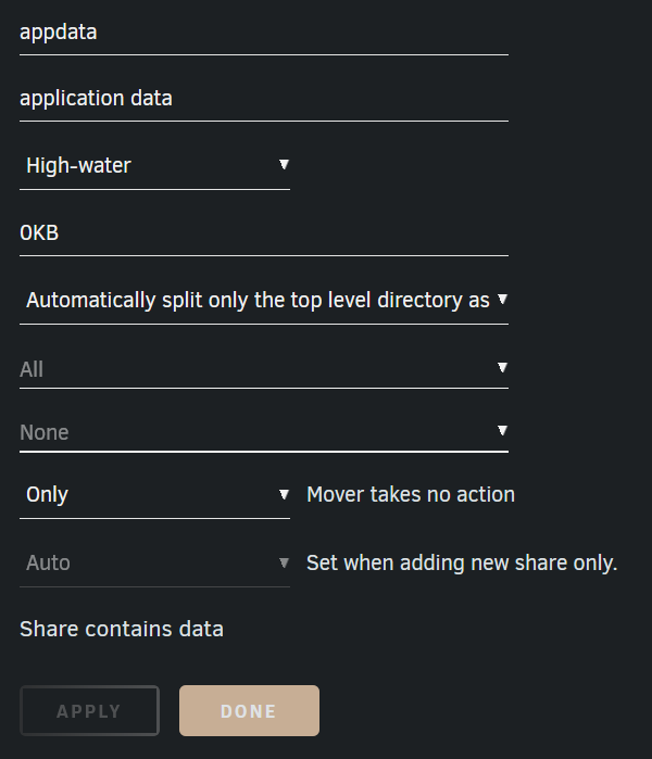

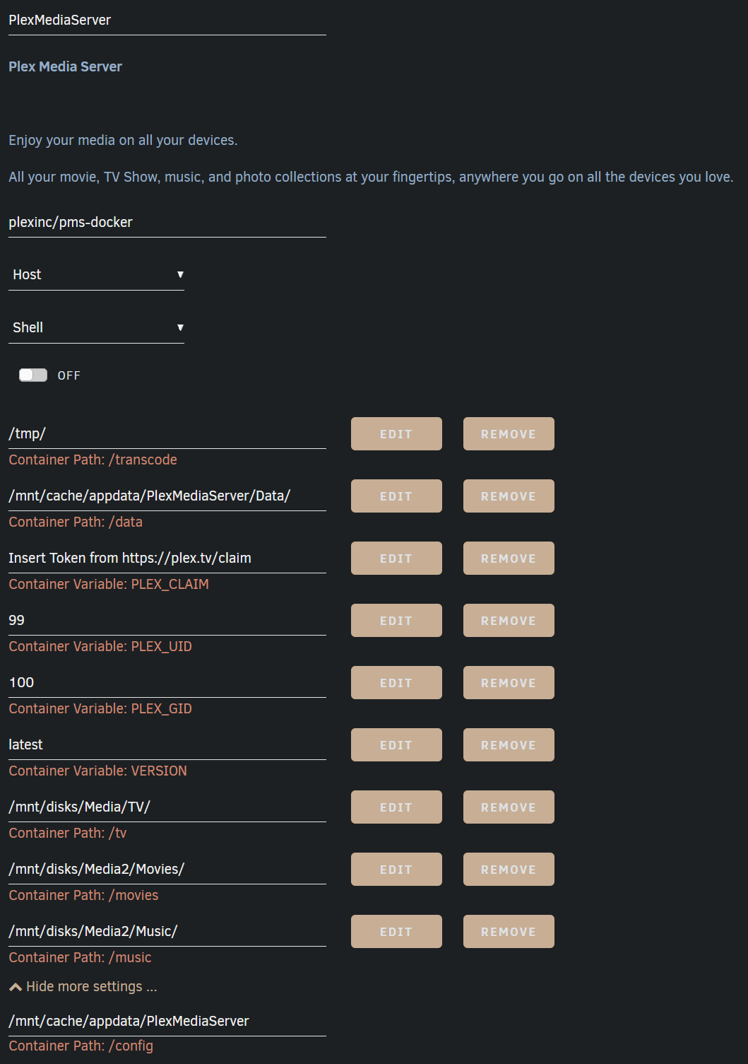

I've ignored this for a long time but I'd like to figure out why it is happening. My appdata folder is set to cache only but I have folders created on the array. I moved everything over manually and restarted and Plex creates an empty log folder on the array. I've looked through the template and everything is set to cache. Any ideas?
I would be looking at these paths:

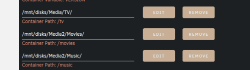

As I understand it,   /mnt/disks    should be on a drive mounted with the Unassigned Devices plugin.  That would seem to a unusual location for media files...
That is exactly what it is. My media is stored on a different computer. That is not the issue here

If anyone else has this issue, Tautulli was incorrectly mapped to the Plex log directory which was creating the folder on the array
