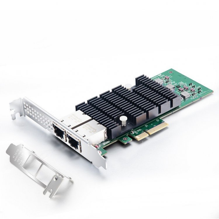

2 hours ago, Mor9oth said:
You mean something like this, right?
Not cheap (180 Euro)
x550-10g-2t-x4-1.thumb.jpg.89fd2ea1682a2b88af176e3f0c0abbd0.jpg.df43c8113291a446774e94a17bfdcf1b.jpg
Use Geizhals to find dual cards. The QNAP QXG-10G2T-107 seems to be the cheapest. But I can not guarantee that the drivers will work in Unraid. So order it with return option, so you can test it. The Intel X540-T2 could be a choice, too, but beware, many of them are fake (but seem to work without problems).
but I guess the heatsink is because the card gets hot - means a lot of energy/cost? Could not find any information about power consumption.
This is my research result regarding power consumption (for single cards):
X557-AT 3,4W TDP (not sure if total or only the controller)
https://ark.intel.com/content/www/de/de/ark/products/series/82749/intel-ethernet-connection-x557-series.html
X550-AT 8W TDP (a X550-T1 network card should consume 8.4W)
https://ark.intel.com/content/www/de/de/ark/products/series/75020/intel-ethernet-controller-x550-series.html
82599 7,1W TDP (specification page 988)
https://ark.intel.com/content/www/de/de/ark/products/series/32609/intel-82599-10-gigabit-ethernet-controller.html (laut
Marvell/Aquantia AQC107 ~6W
Measured by myself (in idle)
Finally I don't know if the Intel values are idle or max values.
Onboard 10G ports need also a heatsink. But it seems that the TDP became smaller in the newer intel controller generations. While the X540 had such a big heat sink, you will find a really small one on this board (with Dual Intel X557) :
https://geizhals.de/supermicro-x11sdv-16c-tln2f-retail-mbd-x11sdv-16c-tln2f-o-a1808467.html
But at the moment I was not able to find X557 network adapters. Only this Mezzanine-Module:
https://www.idealo.de/preisvergleich/OffersOfProduct/6042536_-ethernet-network-connection-ocp-x557-t2-intel.html
This "monster" uses two different controllers ^^
https://geizhals.de/supermicro-aoc-stg-i4t-a1711988.html
Conclusion:
Sadly really nobody seems to test power consumption of 10gbe cards, but the size of the heatsink looks promising for the X557 as the Aquantia Single port card has the same heatsink size as the Dual Intel X577.
