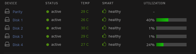

I do know that the parity needs to be as big as the largest drive in the system. I believe the way I worded the system hdds is a bit misleading / incorrect. Total there are two 12 tb drives, and 3 4tb drives. one of the two 12tb drives is parity.
I had another 12 tb to put in, but it was DOA unfortunately. That is why the 12tb drive was set as a parity disk.  image.png.db4faf271795ec3c719753588b765a31.png
This is the current drives ^
