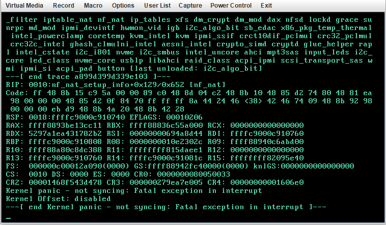

Last few days server has crashed twice for Kernel Panic "Fatal exception in interrupt"
First occurrence was running Unraid version 6.9.0-beta25, happened 2 days ago (image dated 2020-10-03).  I took screen shot of the display using the IPMI KVM access.

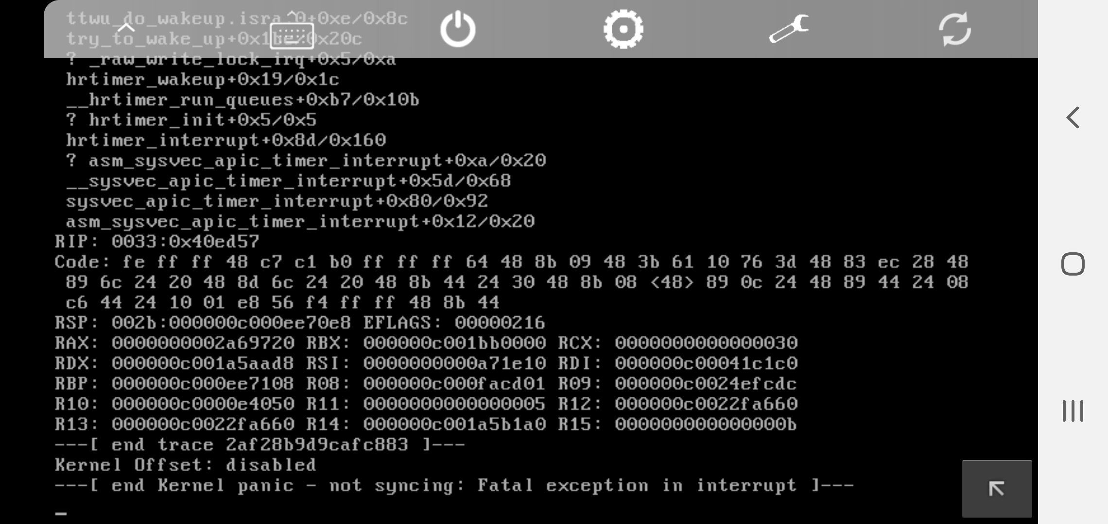

I upgraded Unraid version to latest beta version (Unraid V6.9.0Beta29) after the kernel alarm on 2020-10-03, all seemed fine until today.  Got another kernel alarm screen shot catapulted off IPMIView mobile app (image dated 2020-10-05).

2020-10-03 07_08_48-IPMIView 2.16.0 (build 190815) - Super Micro Computer, Inc..png

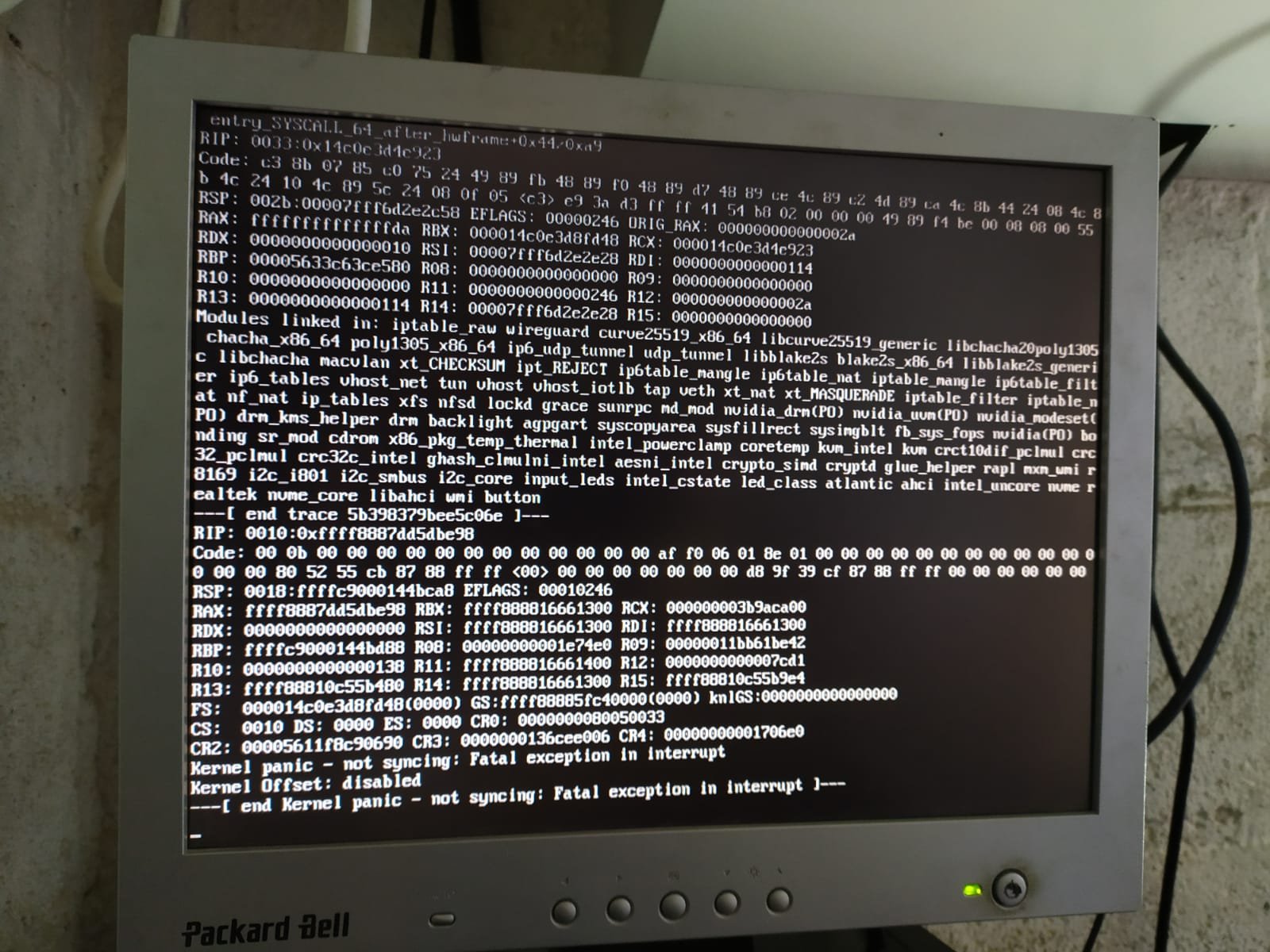

I pulled out all my drives and tossed into other server to see if i get the same issue on another setup using different motherboard, ram & cpu's. While running unraid on the "backup server" I still get these kernel panics that freeze up/crash unraid.
While I was running on the "backup server" I ran memtest86 on the original mobo, cpu, & ram setup. Ran memtest for just over 8days and it showed zero error's.
Unraid crashes on both of my mobo, cpu, ram setups about every 20-25hrs.

Hi @JorgeB
Same trouble last night :(
You can check the picture if you want...
One more thing you can try it to boot the server in safe mode with all docker/VMs disable, let it run as a basic NAS for a few days, if it still crashes it's likely a hardware problem, if it doesn't start turning on the other services one by one.
