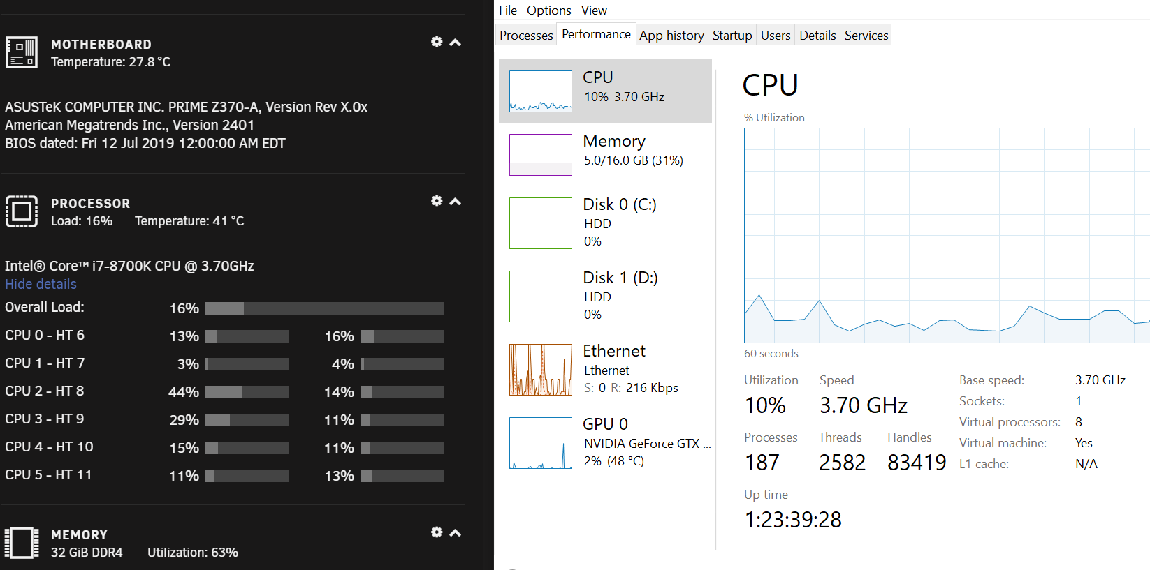

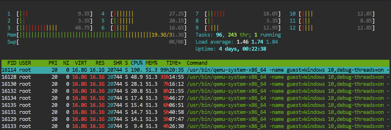

Host/VM CPU usage discrepancy
I've been seeing this issue recently where the 4 CPU cores I have isolated and dedicated to my gaming VM are very active in Unraid compared to what is showing in Windows inside the VM.  I'm also getting some periodic stuttering in the VM too.  CPU2 is always active despite no activity inside the VM.  Included some screenshots below of my config.  I'm using the latest virtio drivers and guest agent.

bump in hopes someone has a suggestion regarding the high CPU usage at idle
