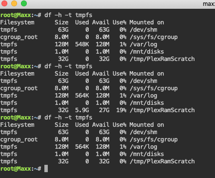

- Transcoding to 8GB Ramdisk (4GB was not sufficient for more than 3x 4K streams, didn't tested 6GB)

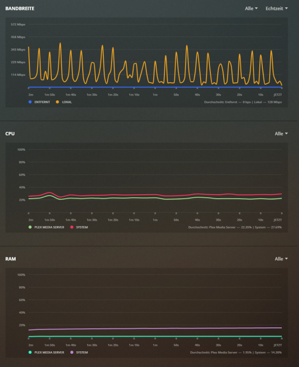

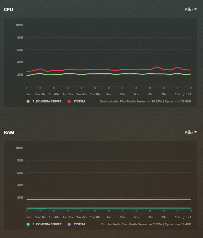

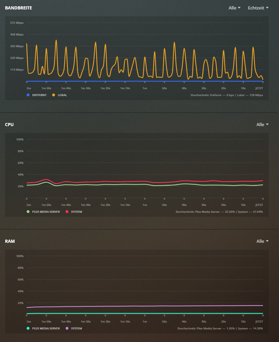

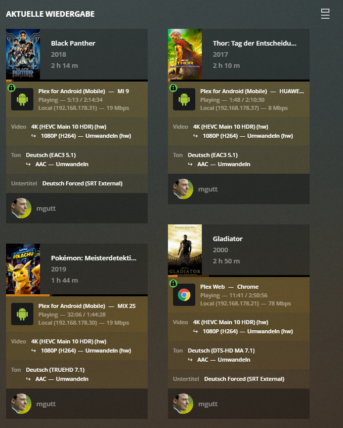

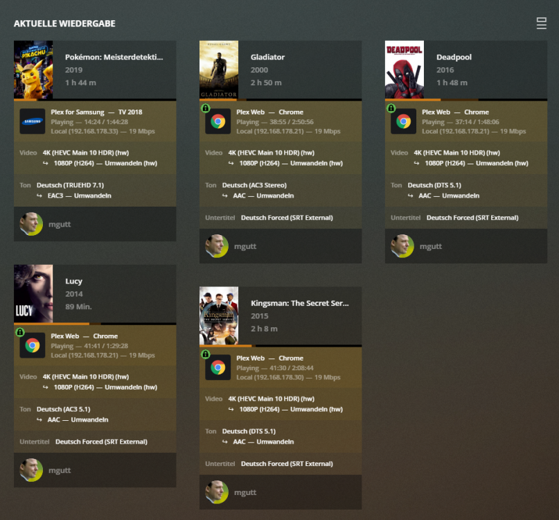

Transcoding 4x 4K Streams without judder:
If I transcode 5x 4K it judders from time to time in one stream (randomly):

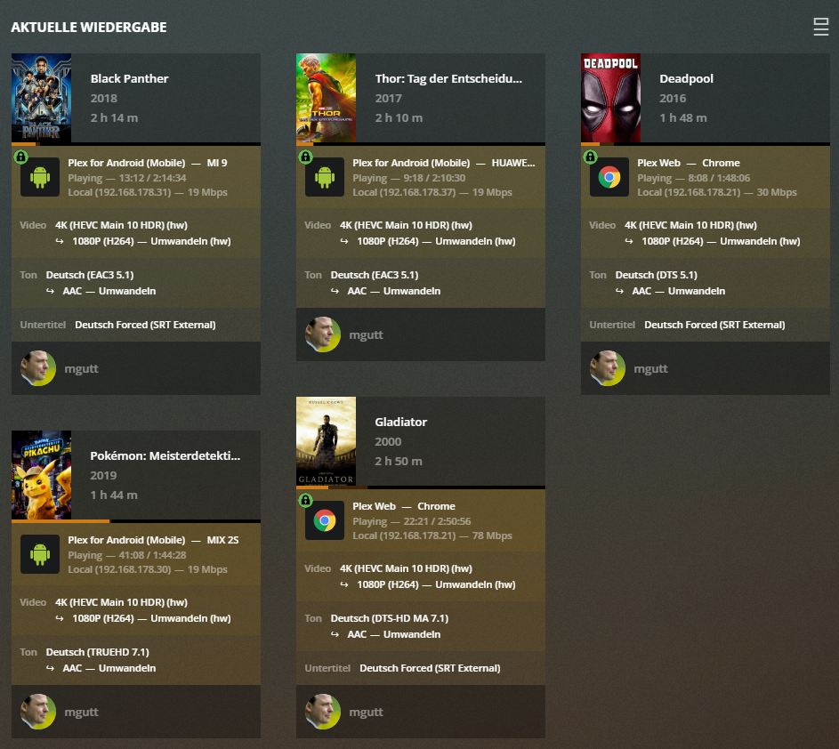

Ok as expected, I was able to transcode even more.

- Direct disk access to 4K Movies located on NVMe:
Results

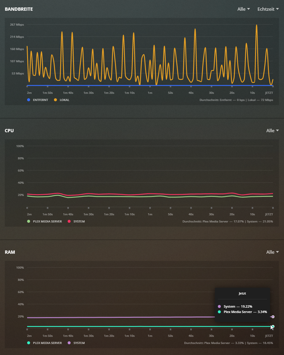

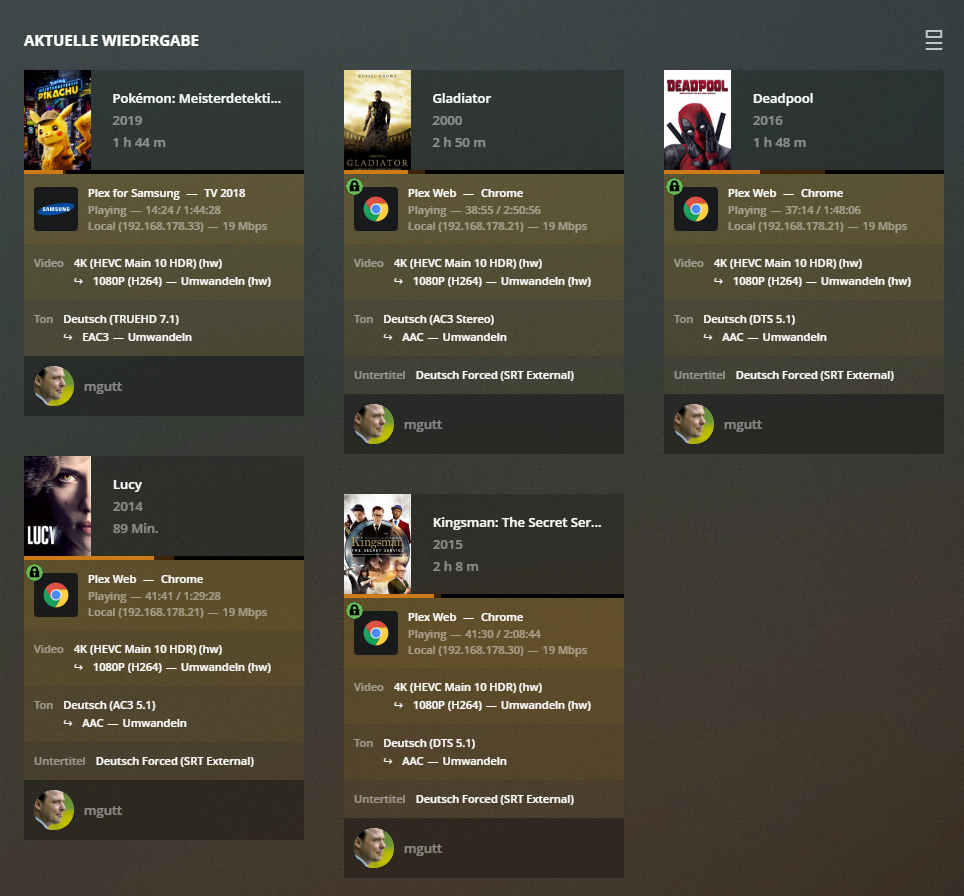

Transcoding 5x 4K Streams without judder:

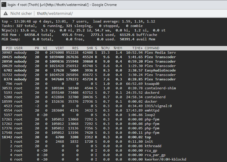

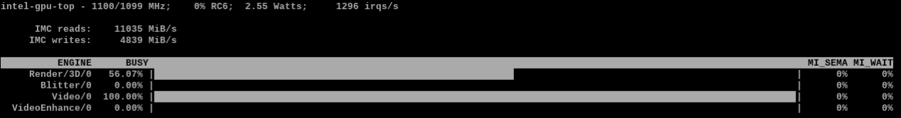

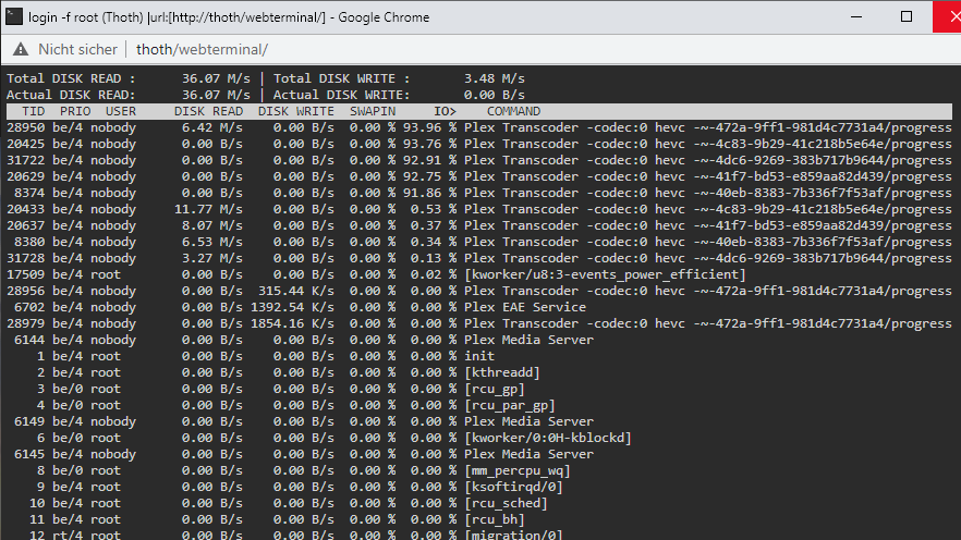

I'm not sure if even 6x 4K would be possible. The only limitation seems to be I/O wait:

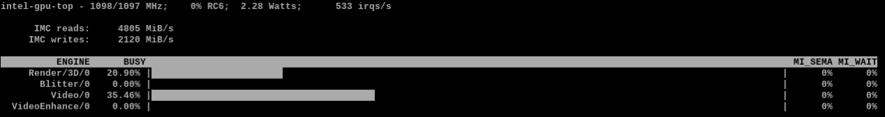

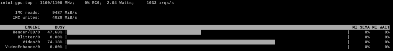

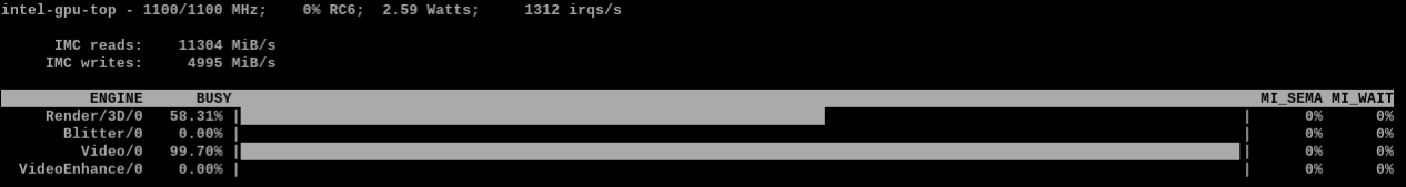

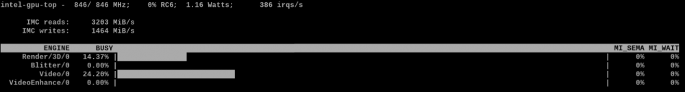

EDIT: Ok I think its not really an I/O wait, instead the iGPU reached its limit. This output is generated through the Intel GPU Tools:
5x 4K streams = 100% video core load
4x 4K streams = 99% video core load
3x 4K streams = 74% video core load
2x 4K streams = 35% video core load
1x 4K stream = 24% video core load
As you can see the Plex CPU dashboard isn't useful for hardware transcoding as it shows only the CPU load and not the video core load.
But hey, we were able to transcode 5x 4K streams parallel. Should be enough I think ;)
I think it would be possible to get even 6x 4K streams if the iGPU maximum frequency would be 1.150 Mhz as it is with the i3-8300. Or with the 1.200 Mhz of the i5-10600 and many 8th to 10th gen i7 CPUs.
Are you sure the iGPU load is visible in those charts ?
I would think that it is just the load on the 4 cores.
Did you mean the screenshot of the Unraid Dashboard? No, of course not. This was only to show the high CPU load and i/o wait. But you are right. This could be confusing. I removed it from my first post.

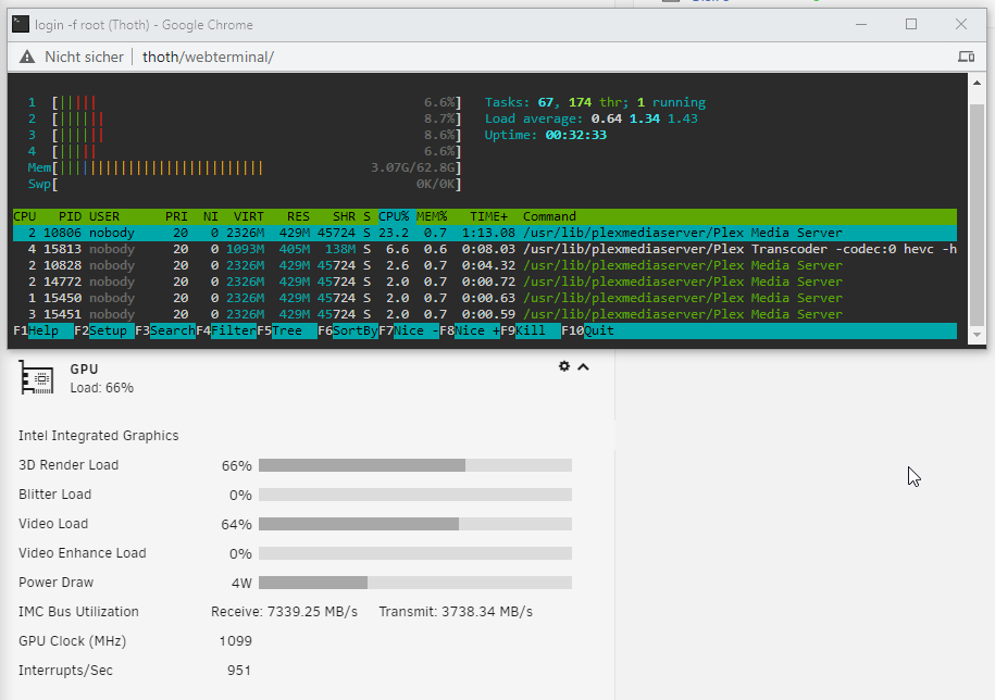

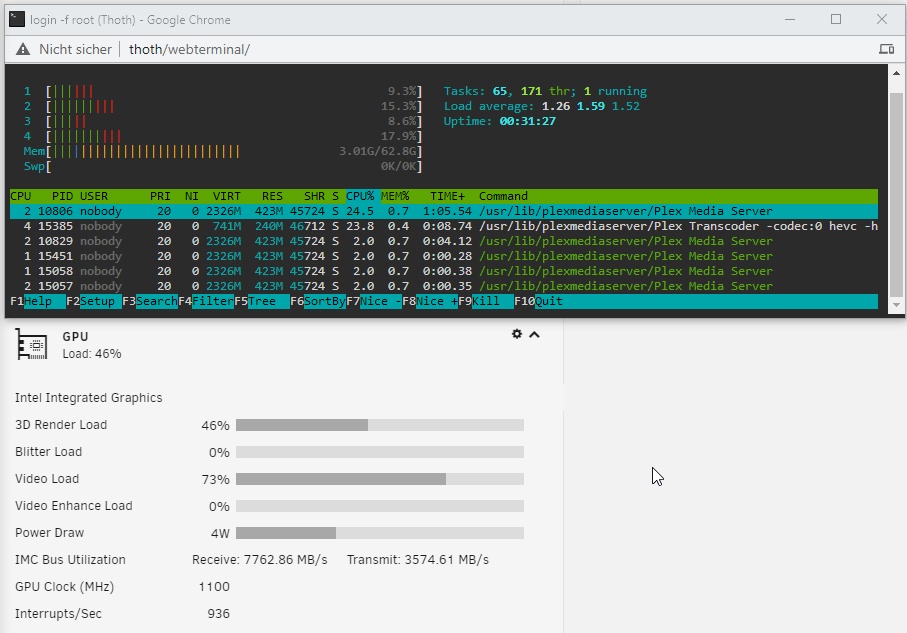

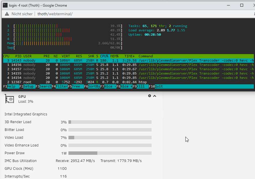

Full test results:
4K to 1080p without Tone Mapping
- 3D and Video Load spikes constantly between 0% and the maximum (50/70%) seen in this screenshot
- screenshot shows load while transcoding 1 movie, tested 2 movies without problems

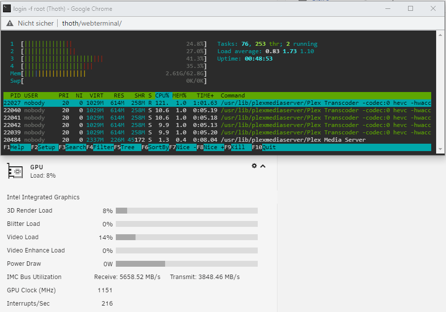

4K to 1080p with Tone Mapping:
- 3D and Video Load spikes constantly between 0% and the maximum (70/70%) seen in this screenshot
- its a little bit more 3D load, but shouldn't be really relevant as long you don't

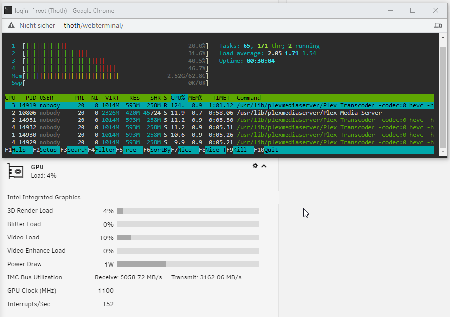

And someone asked me to test the i3-8100 with PGS subtitle burn in, so I tested this scenario, too.
4K to 1080p with PGS subtitle burn in, but without Tone Mapping
- 3D and Video Load stays so low
- CPU stays at 120%
- tested only 1 movie, judder every 40 seconds
4K to 1080p with PGS subtitle burn in and with Tone Mapping
- CPU stays at 180%
- tested only 1 movie, judders every 20 seconds

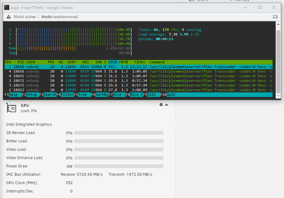

4K to 1080p without PGS, without Tone Mapping
- HW transcoding disabled
- CPU stays at 390%
- tested only 1 movie, very rare judders every 5 to 10 minutes (depends on movie content)

I upgraded my CPU to i3-9350K. Exactly the same result as with the i3-8100, which does not make really sense to me:
- 3D and Video Load stays low
- CPU stays at 120%
Plex really needs to optimize their software.
21 minutes ago, ChatNoir said:
Why would you think the i3-9350K be faster using the iGPU ?
Correct, but Transcoding with Subtitle Burn-In produces more CPU than iGPU load. Compare my last screenshot with this 4K to 1080P transcoding incl Tone Mapping but without PGS Burn In:
1272295607_2021-01-3002_41_55.png.baf5bba5e2e0bf70dfb892374e1f180f.png.9ac764ff1e0cb7c307a10fa7ec0c1af2.png
As you can see the CPU load dropped from ~120% to ~20% and the GPU load raised from ~10% to ~60%.
So I thought I could realize PGS Burn In Support by using a CPU with more Single Thread performance, but suprisingly it's exactly the same low performance.

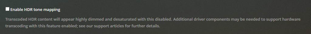

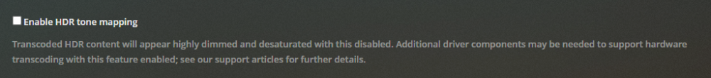

Just a question: Where can i switch on/off the HDR tone mapping? Is this a Plex-feature?
Edited by Zonediver
Yes this is a Plex feature (although I am not sure if it is a Plex pass only feature).
You can disable it in your Plex settings -> Transcoder -> Enable HDR tone mapping.
Edited by gustomucho
