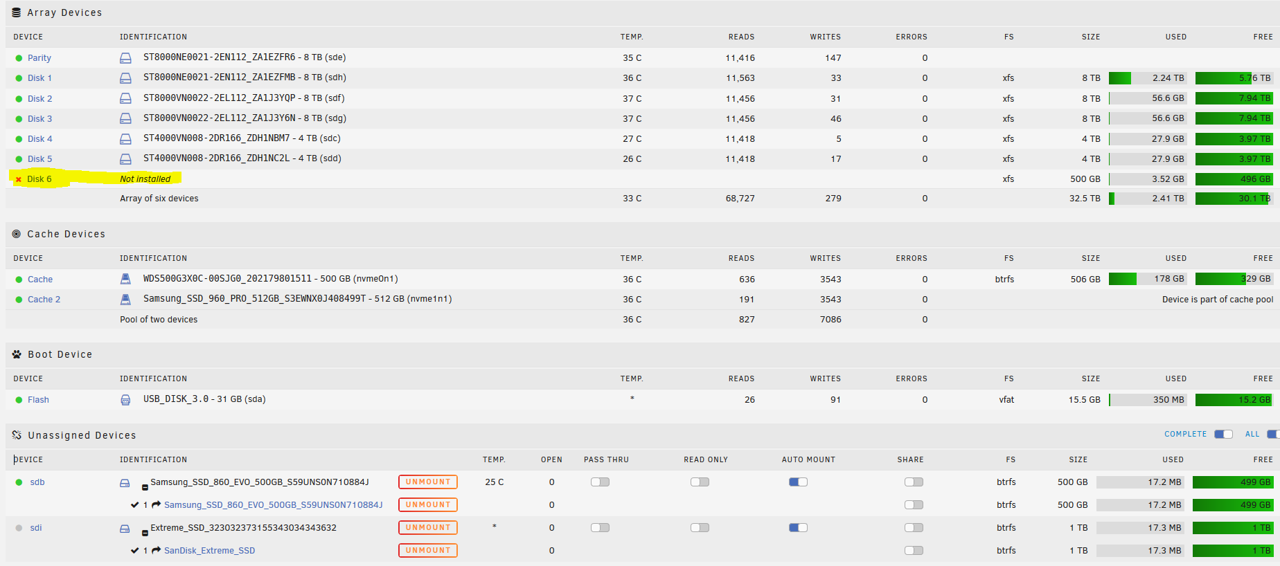

Hello, thanks for reading into my issue.
I created this post to figure out how to remove the "not installed" error in my array.
I removed the 500gb SSD that was added to the array to use in unassigned devices. I placed this disk in the array by mistake. It is not supposed to be there.
Now, in the array, I have a disk 6 error of "not installed" I would like to know how to remove this and get my array back to normal.
Please let me know if you need any more information and I will provide it.
Any and all help is appreciated.
-Thanks
