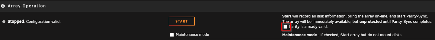

This will only work if parity is still valid, follow the instructions below carefully and ask if there's any doubt.
-Tools -> New Config -> Retain current configuration: All -> Apply
-Check all assignments and assign any missing disk(s) if needed, including old disk4
-Important - After checking the assignments leave the browser on that page, the "Main" page.
-Open an SSH session/use the console and type (don't copy/paste directly from the forum, as sometimes it can insert extra characters):
mdcmd set invalidslot 4 29
-Back on the GUI and without refreshing the page, just start the array, do not check the "parity is already valid" box (GUI will still show that data on parity disk(s) will be overwritten, this is normal as it doesn't account for the invalid slot command, but they won't be as long as the procedure was correctly done), disk4 will start rebuilding, disk should mount immediately but if it's unmountable don't format, wait for the rebuild to finish (or cancel it) and then run a filesystem check.

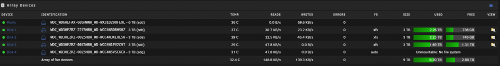

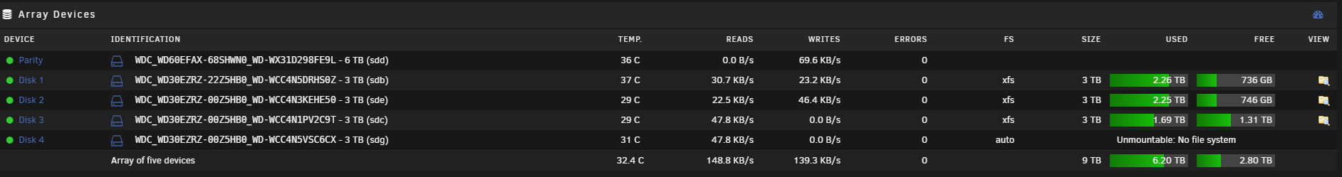

Parity check is now completed. Seems to be successfull. But, hereis what I can see
Disk 4 did not mount automatically. Normal ? Do I need to re-insert it to the array ? (after running    mdcmd set invalidslot 4 29  ? ? ?)
How can I validate if the process completed successfully ?
Or, what are the next steps ?
Thanks again
I assume you mean rebuild of disk4 is completed, since that is what that invalidslot command would have done.
Maybe before doing anything else you should post new diagnostics just so we can confirm.

OK
https://wiki.unraid.net/Check_Disk_Filesystems#Checking_and_fixing_drives_in_the_webGui
Be sure to capture the output so you can post it.
Procedure appears to have been correctly done but don't see a valid filesystem on disk4, this likely means parity wasn't valid, at least not 100% valid, still try running xfs_repair on the disk, maybe it will find a backup superblock.
