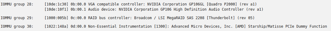

From what i can tell the LSI SAS Card is visible in Unraid under Settings/Devices as a IOMMU attached device but
im not sure if its a setting in the ASUS Bios preventing me from seeing the 6 x 10Tb Hard Drives in Unraid as unassigned devices or if it could
be something else like HBA card is in the wrong PCIE slot...Im LOST. Any advice would be greatly appreciated in assisting in my expensive project.

The pic attached shows that the LSI card is registering as IOMMU group 29 under system devices if that helps at all...

That's a RAID controller, didn't notice in the OP, it's not recommended for Unraid, you want a HBA in IT mode, that one can still work if you create a raid0/jbod for each disk in the controller BIOS, but again, not recommended.
