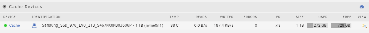

This is Plex on my backup server with BTRFS cache drive:
And this is my main server with XFS cache drive:

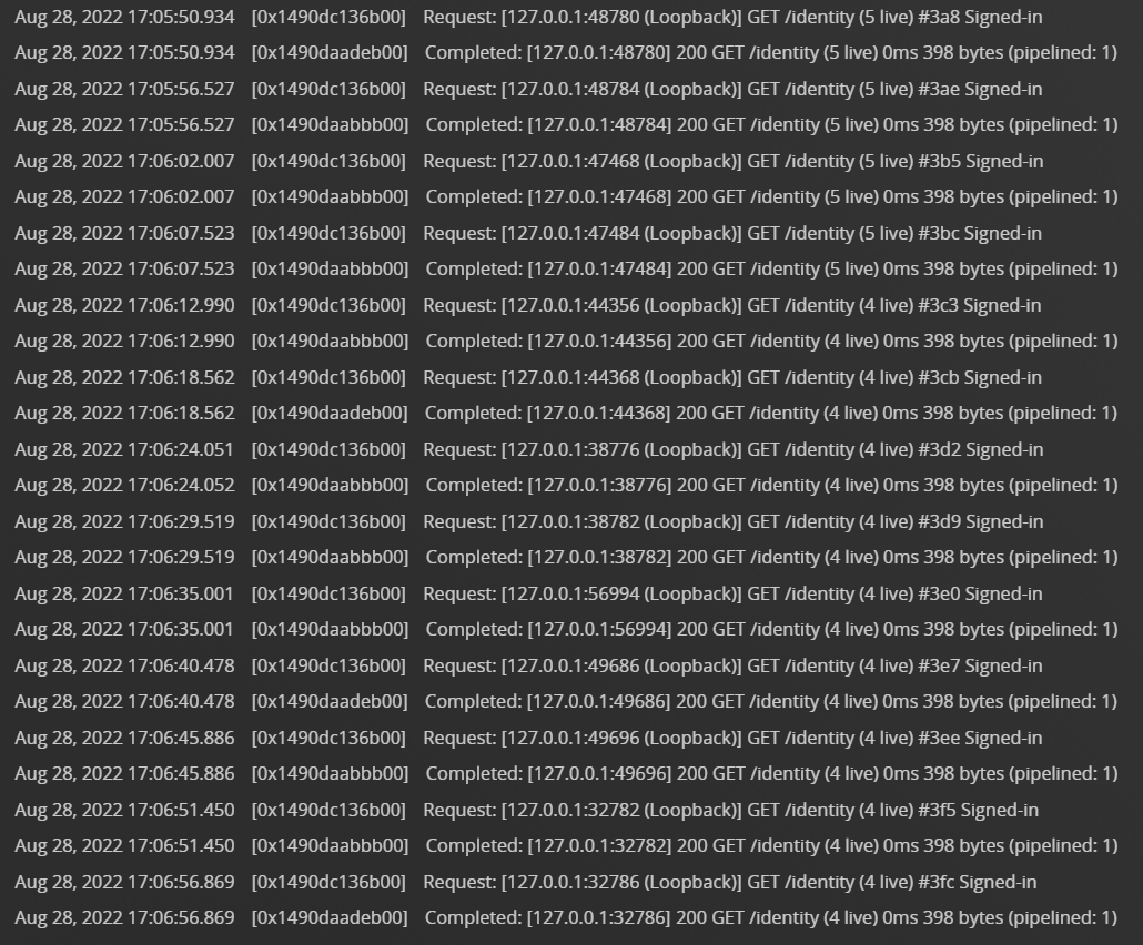

I checked the log file first. Those changes were added in the last minute:
Oct 08, 2020 10:11:46.176 [0x154d2f1f8700] DEBUG - Request: [127.0.0.1:45102 (Loopback)] GET /identity (2 live) Signed-in
Oct 08, 2020 10:11:46.176 [0x154d45512700] DEBUG - Completed: [127.0.0.1:45102] 200 GET /identity (2 live) 0ms 398 bytes (pipelined: 1)
Oct 08, 2020 10:11:51.389 [0x154d2f1f8700] DEBUG - Request: [127.0.0.1:45104 (Loopback)] GET /identity (2 live) Signed-in
Oct 08, 2020 10:11:51.389 [0x154d45512700] DEBUG - Completed: [127.0.0.1:45104] 200 GET /identity (2 live) 0ms 398 bytes (pipelined: 1)
Oct 08, 2020 10:11:56.622 [0x154d2f1f8700] DEBUG - Request: [127.0.0.1:45106 (Loopback)] GET /identity (2 live) Signed-in
Oct 08, 2020 10:11:56.623 [0x154d45512700] DEBUG - Completed: [127.0.0.1:45106] 200 GET /identity (2 live) 0ms 398 bytes (pipelined: 1)
Oct 08, 2020 10:12:01.835 [0x154d2f1f8700] DEBUG - Request: [127.0.0.1:45108 (Loopback)] GET /identity (2 live) Signed-in
Oct 08, 2020 10:12:01.836 [0x154d45512700] DEBUG - Completed: [127.0.0.1:45108] 200 GET /identity (2 live) 0ms 398 bytes (pipelined: 1)
Oct 08, 2020 10:12:07.070 [0x154d2f1f8700] DEBUG - Request: [127.0.0.1:45110 (Loopback)] GET /identity (2 live) Signed-in
Oct 08, 2020 10:12:07.071 [0x154d45713700] DEBUG - Completed: [127.0.0.1:45110] 200 GET /identity (2 live) 0ms 398 bytes (pipelined: 1)
Oct 08, 2020 10:12:12.293 [0x154d2f1f8700] DEBUG - Request: [127.0.0.1:45112 (Loopback)] GET /identity (2 live) Signed-in
Oct 08, 2020 10:12:12.293 [0x154d45713700] DEBUG - Completed: [127.0.0.1:45112] 200 GET /identity (2 live) 0ms 398 bytes (pipelined: 1)
Oct 08, 2020 10:12:17.502 [0x154d2f1f8700] DEBUG - Request: [127.0.0.1:45114 (Loopback)] GET /identity (2 live) Signed-in
Oct 08, 2020 10:12:17.502 [0x154d45512700] DEBUG - Completed: [127.0.0.1:45114] 200 GET /identity (2 live) 0ms 398 bytes (pipelined: 1)
Oct 08, 2020 10:12:22.703 [0x154d2f1f8700] DEBUG - Request: [127.0.0.1:45116 (Loopback)] GET /identity (2 live) Signed-in
Oct 08, 2020 10:12:22.703 [0x154d45713700] DEBUG - Completed: [127.0.0.1:45116] 200 GET /identity (2 live) 0ms 398 bytes (pipelined: 1)
Oct 08, 2020 10:12:27.915 [0x154d2f1f8700] DEBUG - Request: [127.0.0.1:45118 (Loopback)] GET /identity (2 live) Signed-in
Oct 08, 2020 10:12:27.915 [0x154d45512700] DEBUG - Completed: [127.0.0.1:45118] 200 GET /identity (2 live) 0ms 398 bytes (pipelined: 1)
Oct 08, 2020 10:12:33.130 [0x154d2f1f8700] DEBUG - Request: [127.0.0.1:45120 (Loopback)] GET /identity (2 live) Signed-in
Oct 08, 2020 10:12:33.130 [0x154d45713700] DEBUG - Completed: [127.0.0.1:45120] 200 GET /identity (2 live) 0ms 398 bytes (pipelined: 1)
Oct 08, 2020 10:12:38.331 [0x154d2f1f8700] DEBUG - Request: [127.0.0.1:45122 (Loopback)] GET /identity (2 live) Signed-in
Oct 08, 2020 10:12:38.331 [0x154d45713700] DEBUG - Completed: [127.0.0.1:45122] 200 GET /identity (2 live) 0ms 398 bytes (pipelined: 1)
Oct 08, 2020 10:12:43.548 [0x154d2f1f8700] DEBUG - Request: [127.0.0.1:45124 (Loopback)] GET /identity (2 live) Signed-in
Oct 08, 2020 10:12:43.548 [0x154d45713700] DEBUG - Completed: [127.0.0.1:45124] 200 GET /identity (2 live) 0ms 398 bytes (pipelined: 1)
Does anyone know why those "loopback" requests are happening? I wonder about those "DEBUG" entries as my Plex Debug Level is disabled:

We monitor the docker.img writes as follows:
inotifywait -mr /var/lib/docker
Which returns a huge amount of changed files inside the docker image. So I executed the following command which I manually interrupted after 1 minute:
inotifywait --timefmt %c --format '%T %_e %w %f' -mr /var/lib/docker > /mnt/user/system/docker/recent_modified_files_$(date +"%Y%m%d_%H%M%S").txt
Attached you find this log file. After viewing it, I would say we can ignore all non writing events, so I removed all of them with PSPad and this regex:
.* (OPEN|ACCESS|CLOSE_NOWRITE_CLOSE|OPEN_ISDIR|CLOSE_NOWRITE_CLOSE_ISDIR) .*
 which leaves the following:

constantly repeating every 5 seconds

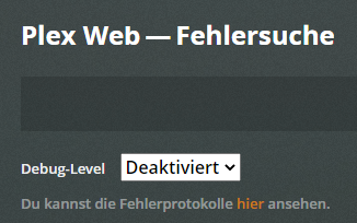

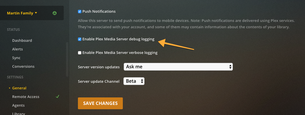

Ok, I did not solve the big "json" issue, but the "loopback / DEBUG" one. I added through:
nano "/mnt/user/appdata/Plex-Media-Server/Library/Application Support/Plex Media Server/Preferences.xml"
the following to the xml:
logDebug="0"
Now, the "Plex Media Server.log" isn't updated every 5 seconds. Instead it stays the same since the last 5 minutes. Good.
EDIT: Ok, I found the same setting through the Plex WebGUI which needs to be disabled:

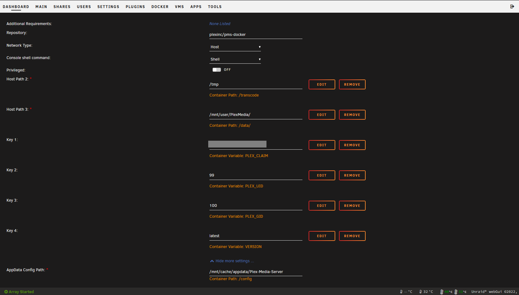

Having an issue with Plex v1.29.2.6364-6d72b0cf6 on unRAID 6.11.4 (was on 6.11.2 and same problem, upgrade didn't change it).
docker run
  -d
  --name='Plex-Media-Server'
  --net='host'
  -e TZ="America/Los_Angeles"
  -e HOST_OS="Unraid"
  -e HOST_HOSTNAME="Tower"
  -e HOST_CONTAINERNAME="Plex-Media-Server"
  -e 'PLEX_CLAIM'='claim-uUCmMyUqnaikN521eMxu'
  -e 'PLEX_UID'='99'
  -e 'PLEX_GID'='100'
  -e 'VERSION'='latest'
  -l net.unraid.docker.webui='http://[IP]:[PORT:32400]/web'
  -l net.unraid.docker.icon='https://raw.githubusercontent.com/plexinc/pms-docker/master/img/plex-server.png'

I have Plex in an UnRaid docker. I need to move severs soon. I’m in the process of shrinking the server down.
I did a move of all of the Appdata directories from the array to my ssd cache and all my other dockers came up fine except Plex.
Screenshot of what Plex web displays. it see’s my original pins so it’s seeing my original config (thus my original metadata) but the mapping to my array data is wrong or missing
Yes I updated the Docker config to point at the ‘new’ Appdata for the Plex docker (screenshot here)
When I do a browse /mnt I can go to /user and see my data in /PlexMedia which I have in the docker config
The Unraid support says its a Plex / docker issue, docker support says it’s a plex / Unraid mapping. I’ve been fighting this for 2 weeks and I’m at my wits end. I’ve searched all over and have over 100 tabs just on this one issue.
I think it’s a simple .ini / config file but I don’t know how or where to update it.
How did you move the files? Was Plex running while you moved the files?
I shut each of the dockers apps and the docker service.
I went to each drive from the main tab -> view (each drive) -> selected the appdata directories -> moved to appdata on the ssd / cache drive.
I did that on all of the drives in the array. once done I started the docker then manuallly checked the paths appdata paths on all the dockers. started the dockers an they all came up just like previous, except plex
And all Disks do not contain an appdata dir anymore?
Correct, All of the array disks,
Need to ask this: Where is your backup? ^^
Can't see the second screenshot in detail. In which unRAID paths are your movies and which path is used in your container?
I have backups of the raw movies and music files 3 2 1'd , I'm not really worried about that but I have a huge Music library and done a ton of work to get album cover right. This is years of work.
Is there a setting in the app / server config to point at the media data?

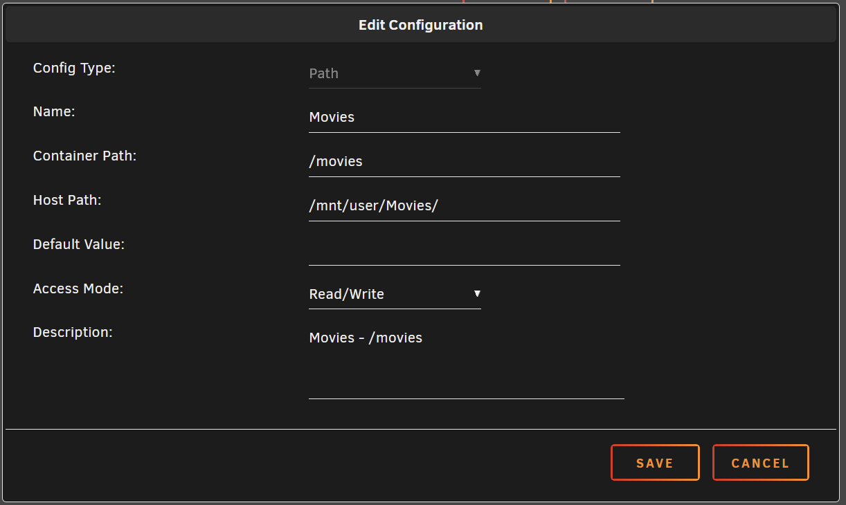

You create the host path to container path mapping(s) you need in order to access the data you want Plex to manage.  Every media type could have its own share on unRAID (mapped to different container paths in the Plex docker container) or you could just have one parent Media folder and point Plex libraries to folders for each media type if that is how you have it organized on unRAID.
I have shares for each media type.  Here is my Movies mapping (Host path is the unRAID storage location for the media):
Edited by Hoopster
So I have all my media sorted under PlexMedia. and the docker is pointed at it. Could it be a permissions problem? is there a log that may have some information?
In Plex are you you pointing to the container path you mapped to PlexMedia.  For example, if you mapped /media to /mnt/user/PlexMedia are you telling Plex to look in /media?
