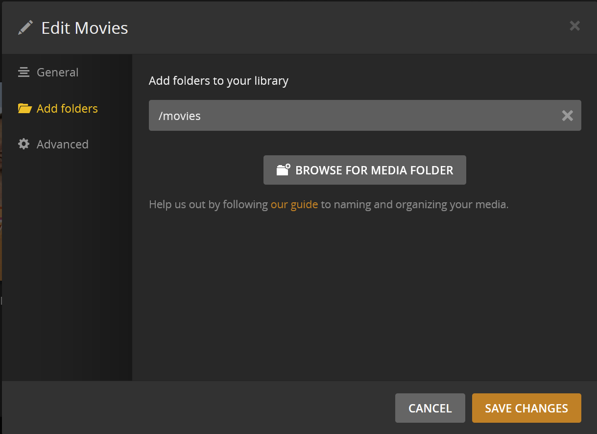

are you telling Plex to look in /media?
Where is that setting?!!?!  I need to check that.
When you add a Library in Plex, you use the container path as the folder setting as seen below.  Since I have a share for every media type, I only need /movies as the folder for movies,  /photos for photos, /tv for TV shows, etc.  Since you have just one main media share, you would also need to select the folder name that contains the appropriate media type, /media/movies for example.
I tested that and I can set up those directories if I start a new server.

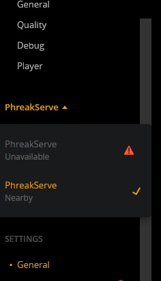

In the picture below if I can get that 'unavailable' server back i'm golden
I've only seen that when the container was not running, the server was unclaimed (after the Plex database hack, password change adventure) or I was logged out of Plex.
If not any of the above for you, perhaps something here will be of use.

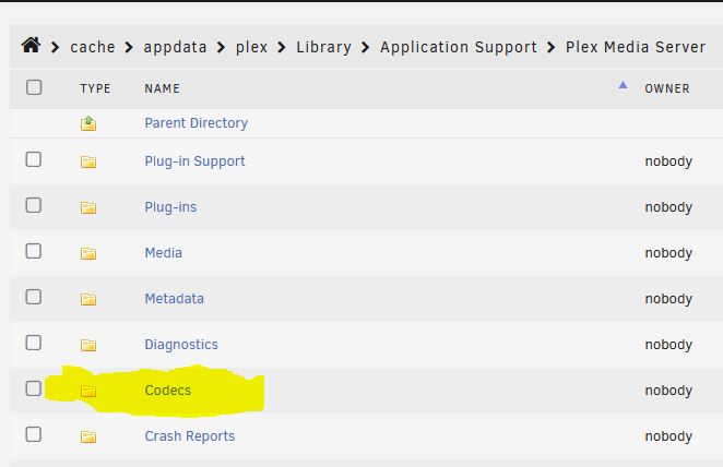

You can ignore Critical: libusb_init failed.
For the decoder error, try deleting your CODECS folder in the Plex Appdata.  When you start up Plex, it will go out and download a fresh copy.

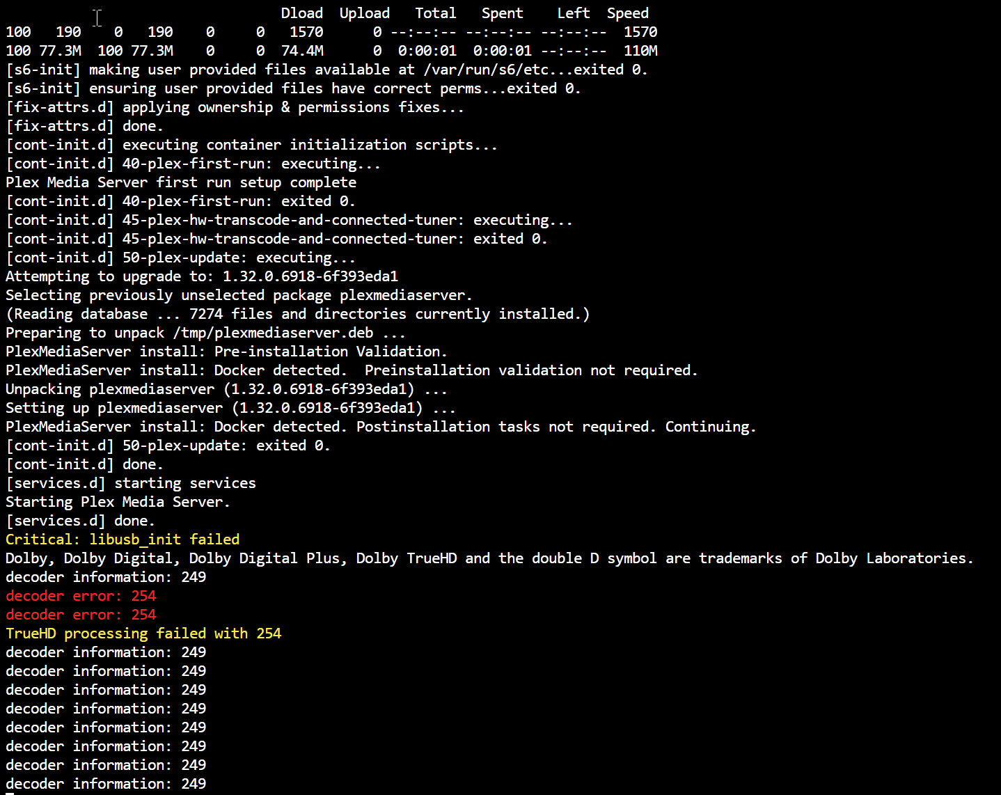

Basically, a noob on this forum. I did a bad thing. I updated the Plex container when my cache drive was full. I don't think it installed right. Either that or my database got corrupted in that process. Now I just get:
Starting Plex Media Server.
Error loading shared library libhdhomerun.so: Exec format error (needed by /usr/lib/plexmediaserver/Plex Media Server)
Error relocating /usr/lib/plexmediaserver/Plex Media Server: hdhomerun_device_create_from_str: symbol not found
Error relocating /usr/lib/plexmediaserver/Plex Media Server: hdhomerun_device_get_device_id_requested: symbol not found
Error relocating /usr/lib/plexmediaserver/Plex Media Server: hdhomerun_discover_validate_device_id: symbol not found
Error relocating /usr/lib/plexmediaserver/Plex Media Server: hdhomerun_device_get_var: symbol not found
Error relocating /usr/lib/plexmediaserver/Plex Media Server: hdhomerun_device_destroy: symbol not found
Stopping Plex Media Server.
kill: usage: kill [-s sigspec | -n signum | -sigspec] pid | jobspec ... or kill -l [sigspec]
Over and over. I did get it to run by repulling the previous container:
plexinc/pms-docker:1.32.0.6973-a787c5a8e
 But even then, it would bring up Movies but not TV Shows on Roku. I could get to TV shows in an round-a-bout way on my iPad. But now even the older version is throwing this error too. I do have 2 HDhomeruns configured in Plex.
Any ideas?
Edited by Jason Hoyt
6 hours ago, Jason Hoyt said:
Any ideas?
Backup your appdata dir. It contains the database of Plex of the date before you updated the container.
First try would be to copy the whole dir and rename the database of the date before you made the update. Then install 1.32.0.6973 with this dir.
If this does not work, you could try to do a fresh install of 1.32.0.6973, stop Plex and replace the database file. By that your meta data will be completely lost and needs to be rebuild.
Note: the database uses two files.
Location:
/mnt/user/appdata/<Plex>/Library/Application Support/Plex Media Server/Plug-in Support/Databases
Thank you so much. This worked. Renamed Database to .old, copied over the 2 previous .db files into new Database folder, rename extension. And then after cleaning up all the other stuff I was trying, it worked.
Throwing this error now:
but seems to be working. Half the posts say ignore it; the other half say it's an issue. But for now, the wife and MIL happy.
Again, thank you.

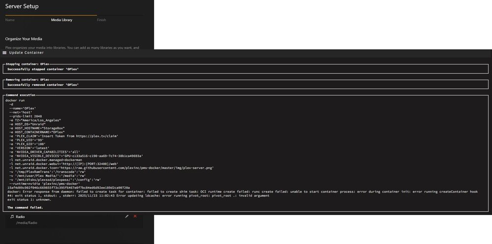

So a few days ago I decided I wanted to migrate my old dual 1TB Cache SSD’s from BTRFS to ZFS (unraid 6.12.2) I had already set a 4 disk zool pool i call download-cache
I stopped docker and VM manager and set the share to migrate to the array (which is on xfs) when mover is invoked. I used mover to move the appdata folder to the array then used rsync -avz /mnt/user/appdata /mnt/download-cache/apps/
i updated the mapping to the for Plex to /mnt/user/apps/PlexMediaServer thats on the download-cache and saw Plex worked.
I since shut it all down and used rsync again to move from the 4drive zpool (spinner disks) to the 2 Drive zPool (formerly a BTRFS pool) called cache
Now when i launch plex it is setting up like a new server with a random name… if i stop it and update the config path to the 4 drive pool it works again.
The claim code in the container config has not changed not sure where to look to make sure it launches the same name and instance of Plex on the new location with the 2 drives
really struggling with trying to get this back on my SSD's if cant be the filesystem as the download-cache is zfs as is the cache
when it didnt work the first time i went back to BTRFS and it worked again on the cache
any help would be greatly appreciated.
Then Plex has created appdata files of the new Installation. Check with the File Manager Plugin or similar where the files have been created.
And I'm not sure why you used rsync. If you are changing the cache pool of appdata, you simply need to select the new pool in the appdata share settings and then start the mover again.
i used rsync becasue mover wont move files off of zfs
the rsync moved all files from apps2 on the download-cache to appdata on the cache it retained the timestamps, permissions and users/groups from the download cache
my plex config folder is approx 214GB so rather large no way to move it from one cache to other and it took over 4 hours to for mover to move from cache to array and array to download-cache
once i tried to move it back to array it completely failed mover just stops for no reason so was stuck using rsync which actually took about 45min to copy all the containers from appdata that i put to "apps"
I verified database files are there and all the files that should be there are...
when i load from a URL i configured to get me there using internet DNS i get the interface and all my libraries have a triangle
when i map the plex contain back to the apps folder on download-cache it loads my server and libraries just fine
Well it was the most painful move ever 15 hours of mover trying to move 214GB plex folder. I ultimately using rsync with -avh to move the folders with smaller and more files and let mover handle the database files
took nearly 24 hours but I got Plex up and running on a ZFS pool now with no watched status lost for myself ore my users! I took a snapshot right away
