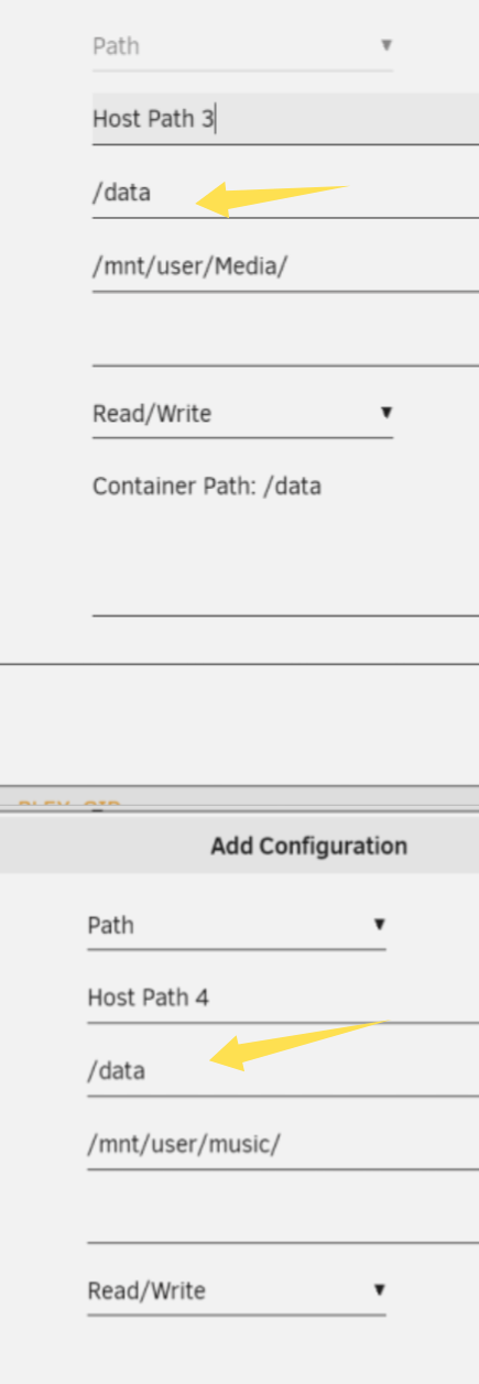

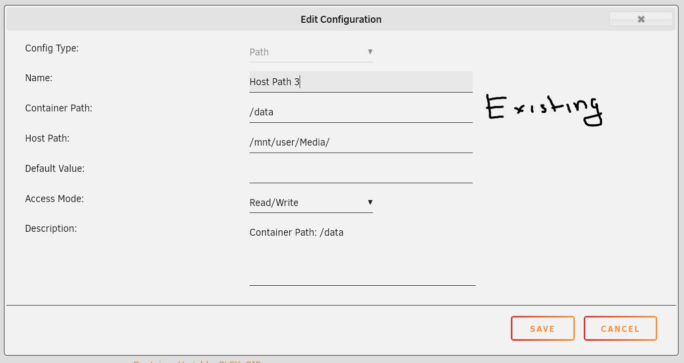

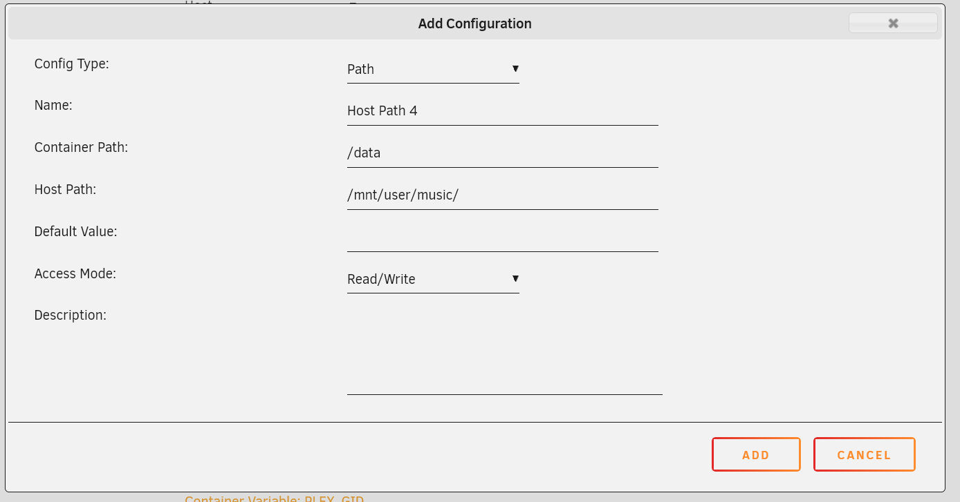

Did I do something wrong ? I set up the plex server using the official App. I was able to add the movies directory. No problem at all. I though I would try to add my 'music' share. Every time I try the Docker is orphaned. I have to reinstall on the App/Docker reinstall page.  I included some pictures. Maybe I set it up wrong from the start?  I simulated how I was adding the music share without adding this time just to show in the picture. Any Ideas??
@fschris
You are mounting two different source paths to the same destination path /data which can't work:
My suggestion:
Set source and destination to the same path:
1.) /mnt/user/music > /mnt/user/music
2.) /mnt/user/Media > /mnt/user/Media
By that you will find the content inside of the Plex Container in the same paths as you know them from unRAID.

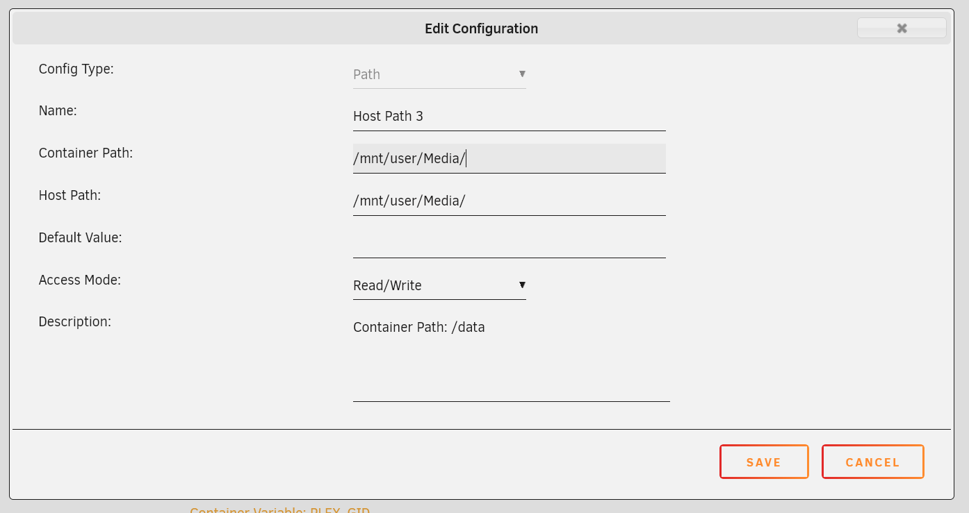

thanks just to clarify is this what you are suggesting:
Yes. That's how I'm doing it with all containers as long they don't require specific paths, but Plex is absolutely flexible regarding this. Plex even allows changing paths of already indexed files and automatically updates its database if the location of a file changes.
Thanks mgutt - I will give it a go. Appreciates your feedback.
This was the fix - thank you!  I still don't understand the Host container vs path container relationship!

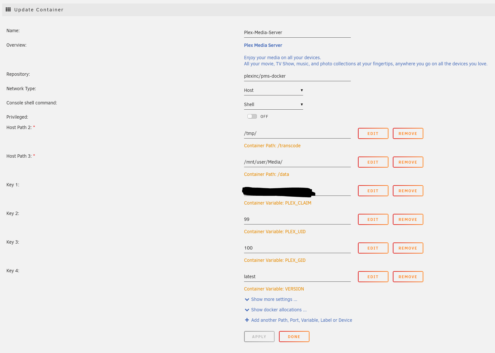

In the last two weeks, Plex has stopped working for some files. I think its a transcoding issue.
I get these errors:
[Req#5e2b/Transcode/r7pw9nhy59asswlpgjm37s5q] IsFileWritable: failed to create file '"/transcode/c3a08e2f-6ae3-43cd-ad23-a246f5f31505"'
I have attached my settings. I wonder if this is to do with the Host Path 2 I have set up. I thought this was to make it use ram to transcode but perhaps I have done something wrong here.
The extra parameters I have are:
--runtime=nvidia --no-healthcheck
I did get an issue with the nvidia driver when I updated to lasted Unraid OS but this seems to be resolved.
Any help would be greatly appreciated!
As Plex is writing to /tmp and this dir is in unRAID a RAM Disk, you RAM become probably full?!
Another possibility is that /tmp/transcode has wrong permissions. That's why I added this to my /boot/config/go file:
mkdir -m 777 /tmp/transcode
