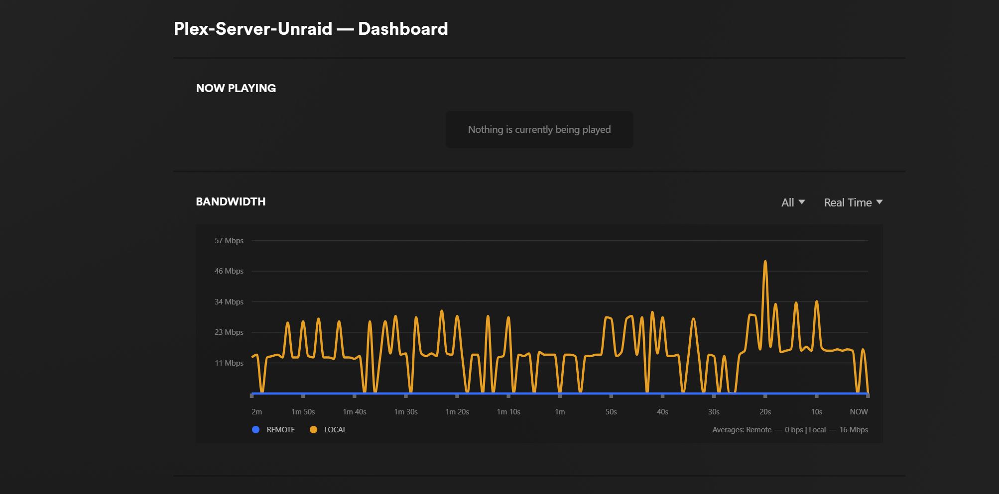

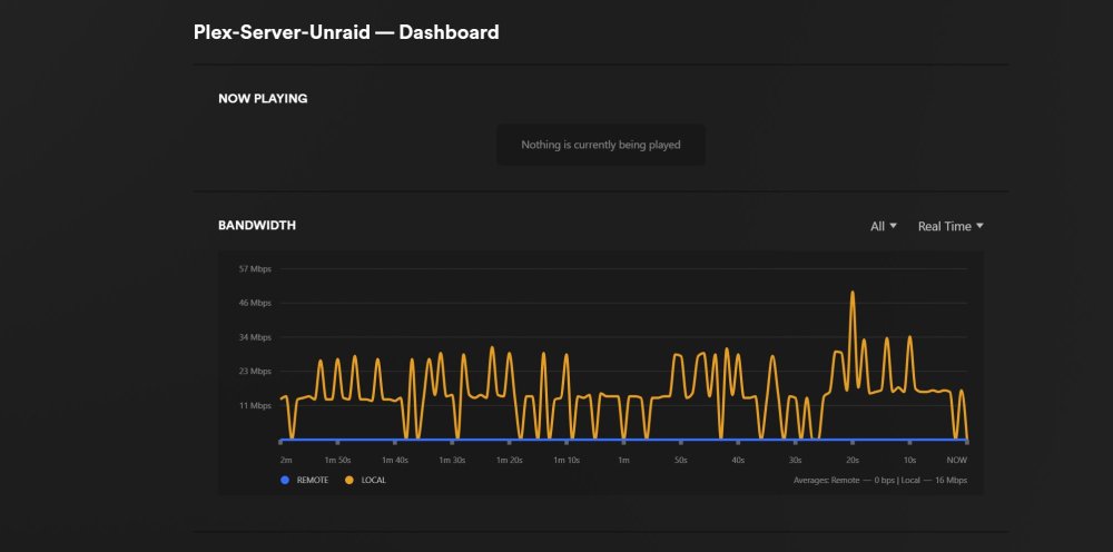

New user to unraid. I have been using proxmox and had plex-server setup on unbuntu on a LXC. That all worked fine except proxmox was unstable using a I9 13900 CPU. Always crashed when things went Idle.
So I am trying out unraid. So far so good. I got plex-server installed and iGPU passthrough enabled. I have it setup to transcode using RAM. HW transcode seems to work as expected.
However I am seeing some odd behavior with the plex-server dashboard. If I direct play a movie nothing shows up in the dashboard as being played. If I force a transcode by selecting a lower quality video after the movie starts then the movie shows up in the dashboard. Any Ideas?
Clearly the video is streaming but nothing shows up.

16 hours ago, eddie_bear said:
4. When I tested with the 1080P movie, with the hardware acceleration enable, the buffering issue is not there anymore. The move can be played smoothly. So is the Celeron N5095 is not capable for 4K HEVC decode?
When you are playing the movie what is your CPU doing? If you are not HW transcoding I would expect your CPU to be pegged 100%.
Also if you go into your dashboard when you are playing the movie does it say direct play? Or does it show it converting it to a different format?
Yes I am quite sure it is doing HW transcoding as I can see the sign [hw] in the dashboard. However the CPU still hike to 90-100% constantly. I guess it is because iGPU is trying to help the CPU but not that much.
It is not shown direct play. It shows 4K to 1080P transcode with [hw] as the indication that iGPU is involved.
