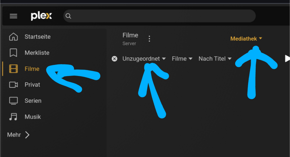

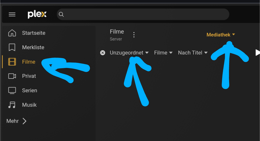

Hello mgutt,
Thanks for the reply. I have restored the database file from a backup. The problem I have now is I'm missing some media (TV Shows, Movies, etc.). I have scanned the library and also refreshed all metadata but it's not adding the missing media. Before the database was corrupted, the media was in Plex. How can I get the missing media into Plex?
Open the movie library view and use the not assigned filter. Are they maybe found, but not assigned?
Or try to rename one of the movie folders to ".movie name" and back to "movie name". Does Plex then find the movie?

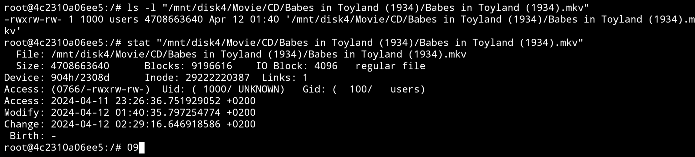

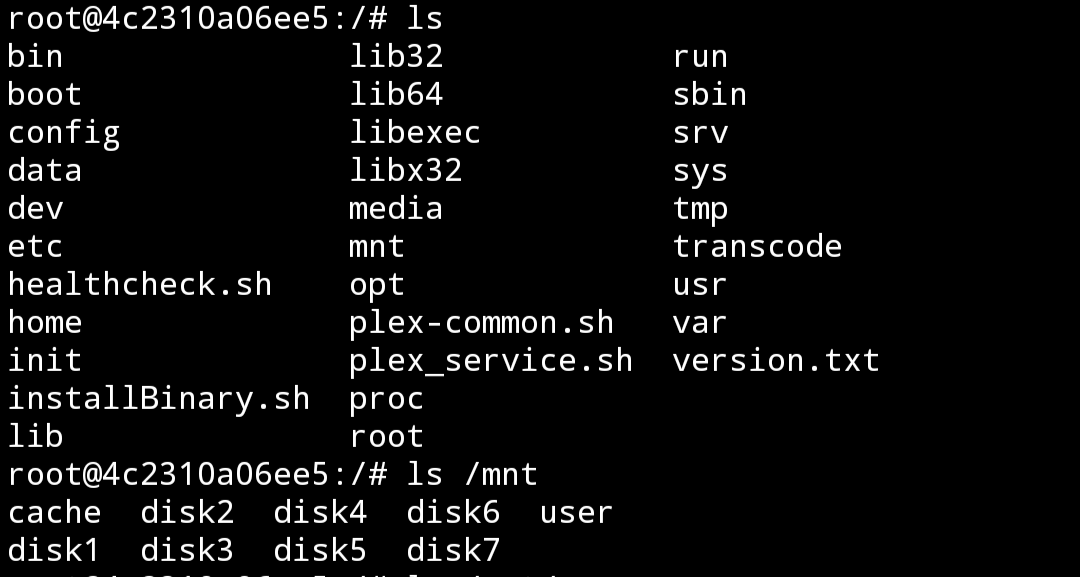

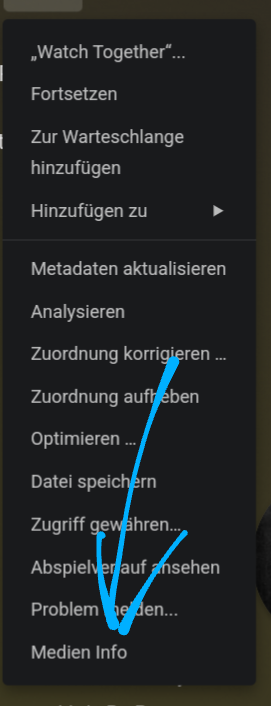

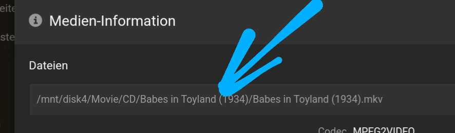

Open the command line of Plex and compare the paths of a movie media info:
to the one you see inside the container. Example:
Try with ls -l or
stat "/path/to/movie.mkv"
To obtain file details:
So you can be sure the movie file is accessible through the container.
