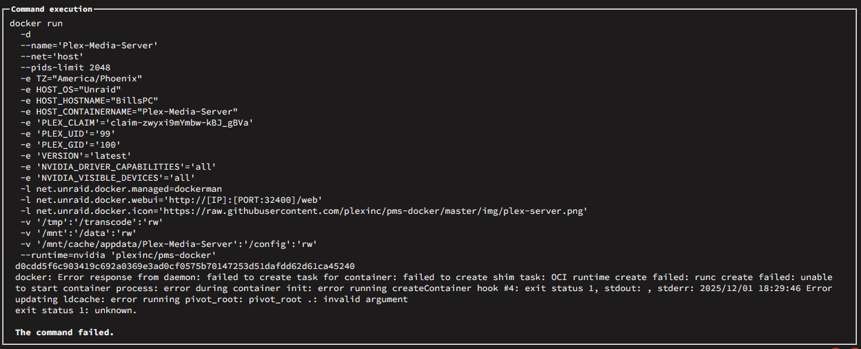

My plex docker broke so I started over. Everything is working fine but I need hardware encoding. I am using the official docker image of plex but when I go to add extra parameters "--runtime=nvidia" and hit apply this is the error I get. I even tried different version of plex dockers from ben and linux IO and this always shows up when I add the runtime. I am stumped everything was working until it updated the docker image from bens old plexpass from 4 years ago.
I'm running into a similar issue, except the container is fine with adding the extra parameters. It's when I add the GPU ID to the container variable that it throws the same error.
I just wanted to reply to this to say reinstalling the drivers in the nvidia plug in resolved this issue.
