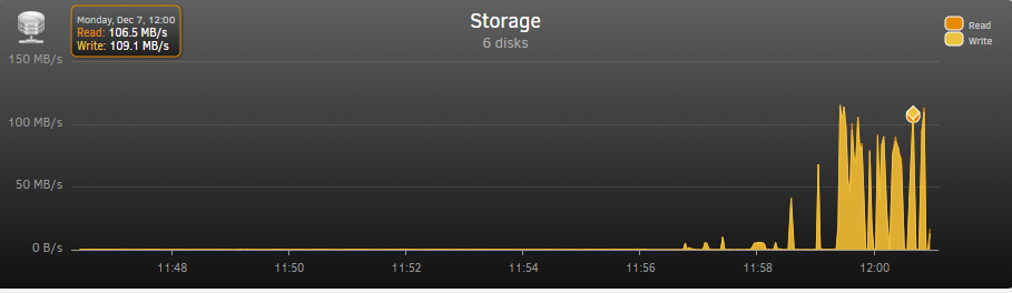

Hi AshranPewter,
no sorry,  all is working fine for me just copied a bunch of data:

32 minutes ago, AshranPewter said:
I guess that's about the same as mine, I would expect it to be a bit higher but maybe a limitation of the processor or system. What is this plugin you have above? Maybe I can compare using it.
Thanks for the reply!
Thats the default config under "stats" --> "system stats"
But notice the copy from above is via local network not local ;) when my copy-job is done i will make an additional local one and post it here

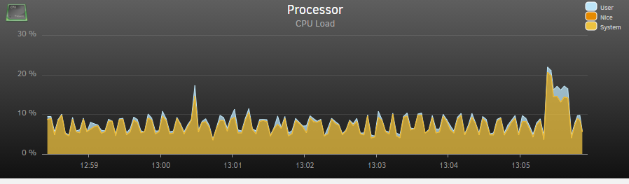

Looks like it's Dynamix System Statistics you're using :P got it up and running.
My speeds look similar, I do have a cpu core at 100% consistently as well.
oh damn looks kinda strange to me :X
Mine is around 50% right now while moving around 4.5TB and I also have Docker running atm. So not sure if mine would look like that later but on the main dashboard 1 core is consistently at 100% which I'll try to resolve with a reboot when my data is across and parity protected.
