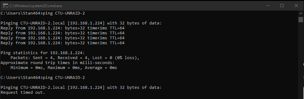

I have a 2nd UnRAID Box fired up with a fresh build on it, but heres the catch!.
It can only be Accessed via my Mobile Phone.... (WebUI) i can 1/5 times ping it via my Windows PC (everything else works on this PC incl existing UnRAID Box & Other services).
As you can see, pinging it worked flawless one moment and then fails the next. BUT! remembering the fact this works perfectly fine on my phone, can click on various tabs, pages, settings with ease & speed.
But the PC will not load the page, with both IP Address & Hostname, cannot SSH to this box from PC either.
Any ideas?
NOTES: I thought it was a "NIC" issue so i installed a new NIC and it does the same thing. I thought maybe the port was faulty as the Mobo isnt super new. but no, it has the same behaviour, which is both 'kinda' relieving but also frustrating at the same time...
