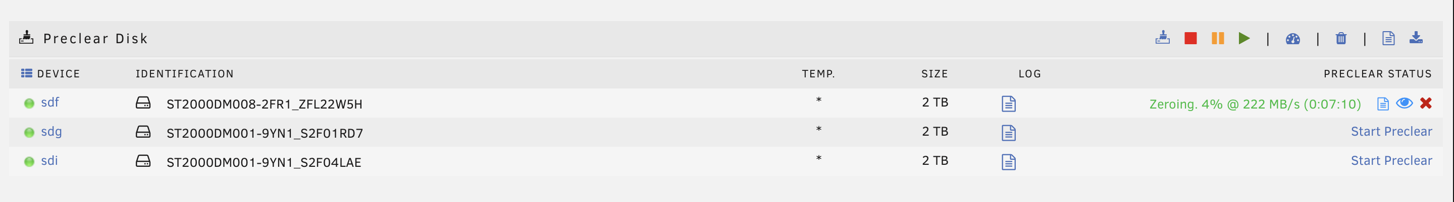

Ok, is it correct the PRECLEAR script does recognize them and does not add them to the array when finished?
Preclear script has nothing to do with the array, like mentioned Unraid requires all assigned devices to have a unique identification, maybe that string can be changed in the controller, you can also try toggling Setings -> Display Settings -> Display world-wide-name in device ID
