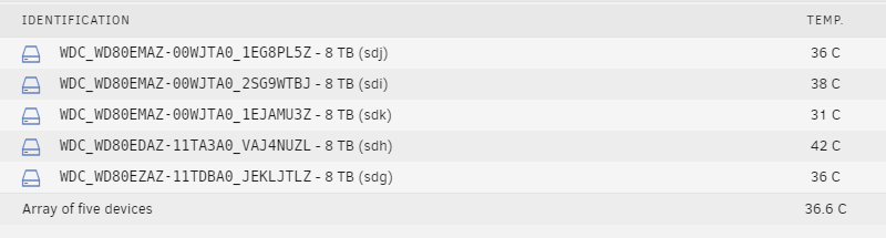

Guess which one is the air drive, thats correct... The EDAZ. Second drive down is right next to it so runs a little hotter.
The coolest drive is in a seperate enclosure with better cooling.
Current rebuilding (replacement) the bottom drive so all drives have been active for hours.
You all are correct. It is not Helium filled. This sucks a lot.
