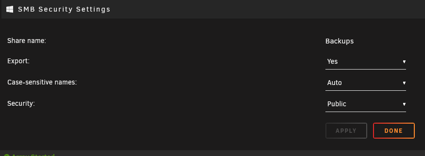

I have Acronis True Image (2018 if that matters), and I know people use it here to back up their main PCs to Unraid, but I'm not sure how to properly set that up.  I have a share in my Unraid NAS called Backups (only using one drive for the backups, I'm not sure if that's necessary though), and folders within that share that separate out what is being backed up, but I'm not sure if I'm supposed to use the Network directory or an FTP connection.  I don't have anything from the NAS showing up on Network, and I have no idea how to set up an FTP connection in Acronis.  Can anyone who uses Acronis chime in?  I'm at a loss for how to set it up.  Is the share setup in Unraid correct as well?

You need to export your Backups share via SMB so it shows up when browsing the Network from ATI. I have Security set to Public but you can set it up with a more secure option and even an unRAID user specifically for backups.  I'll probably eventually do this, but, I am OK with it being Public for now,

Here's what's interesting: that share was set to public, but I didn't see it under Network in Acronis.  Because I first checked the SMB settings and stopped the array when doing that (forgetting that the SMB security settings are in the shares), after starting it again, I saw it.  Odd.  For some reason, it'll show up in Network only sometimes; lately it hasn't been doing that, but typing the name into Windows Explorer will access it anyway, but without showing up in the Network tab.  Restarting the array made it show up.  Huh.  I don't know then.  But it's working now.
