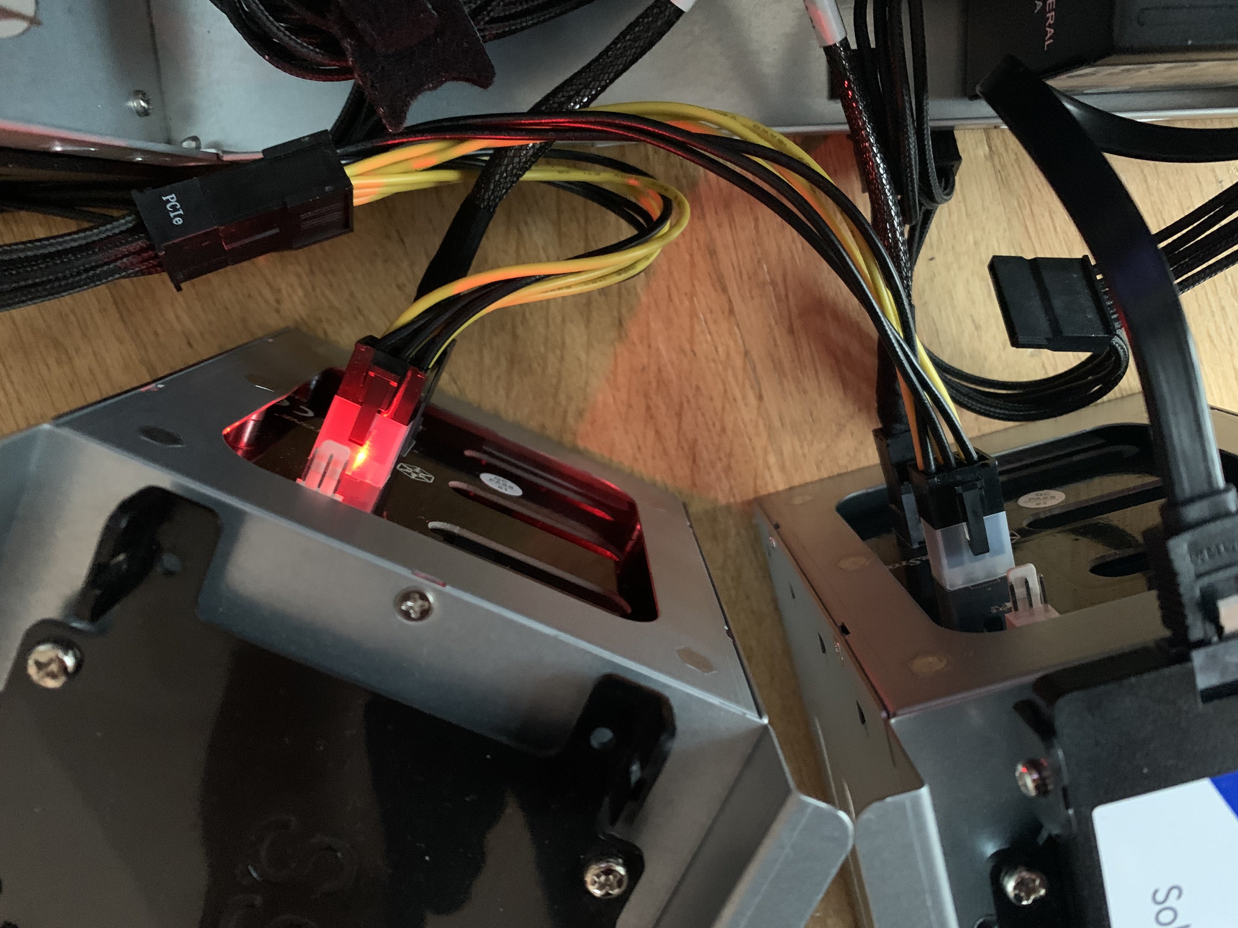

  1. Power goes from PCI-E 8 pin connector (Power supply), split by 6 PIN Adapter (Y-cable, included to the SilverStone CS381 Case) to each Cage. The Cage has the 6 PIN female port, so this seems correct to me. Or is here a Problem? Can I reuse it that way if I got replaced the backplates and the Drives?

One suspect is the 8pin motherboard cable being used in error (rather than PCI-E) since these are wired with opposite polarity. It should be possible to connect due to keying, but cheap moldings may allow a plug to be force connected.
With the PCI-E cable disconnected from the cages and the PSU powered on (PC running)

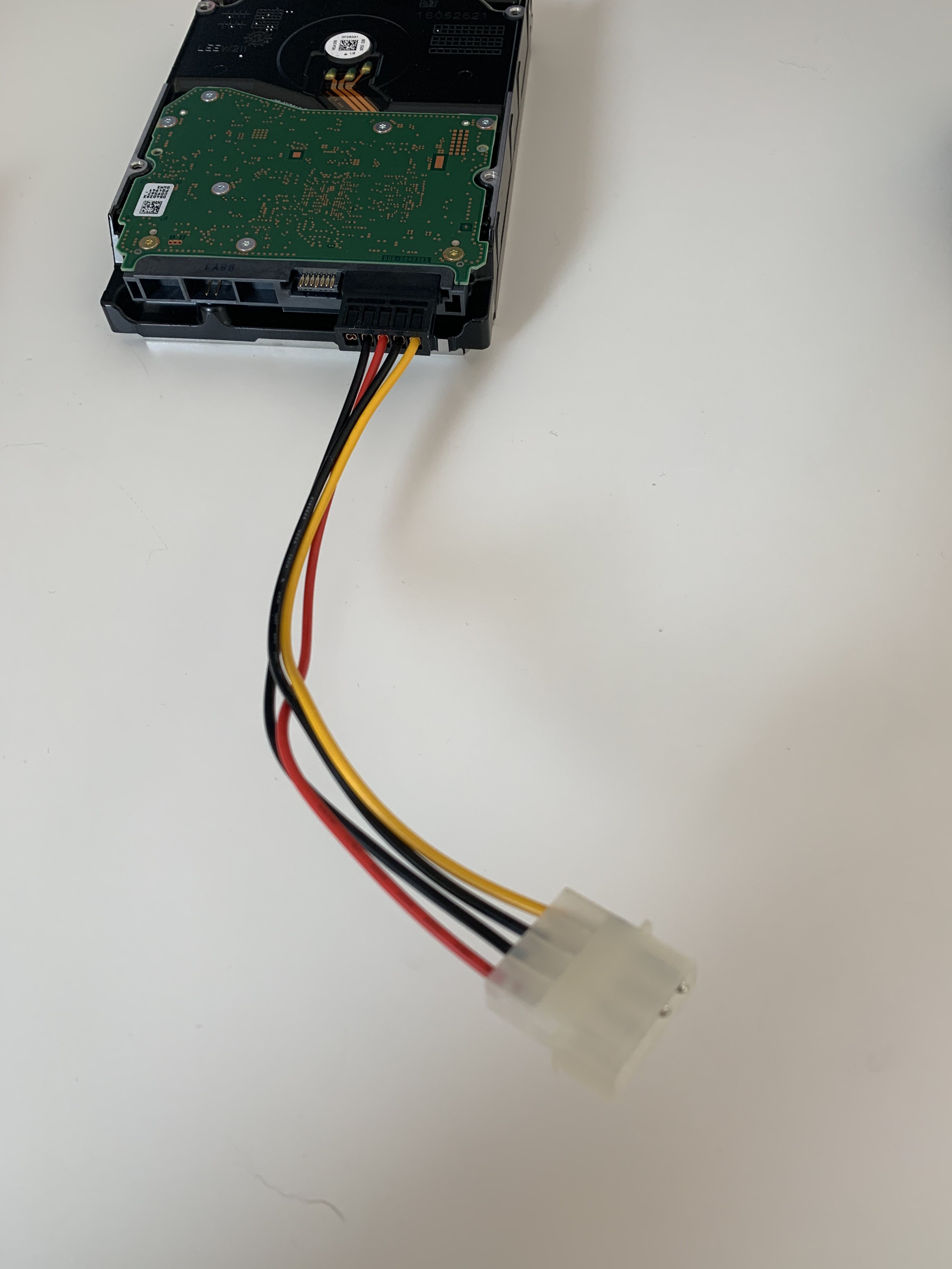

What I tried by myself: Tested with multimeter the drives connected with a SATA to Molex Adapter.
All crossed (Alternating red and black cable with the sensors) Red/Black measurements shows OL; all Black/Black gives me ring up.
What does this mean when I go to a PC Doctor?
As the drive does not seem to have a short circuit on the input voltage (from the meter readings)....

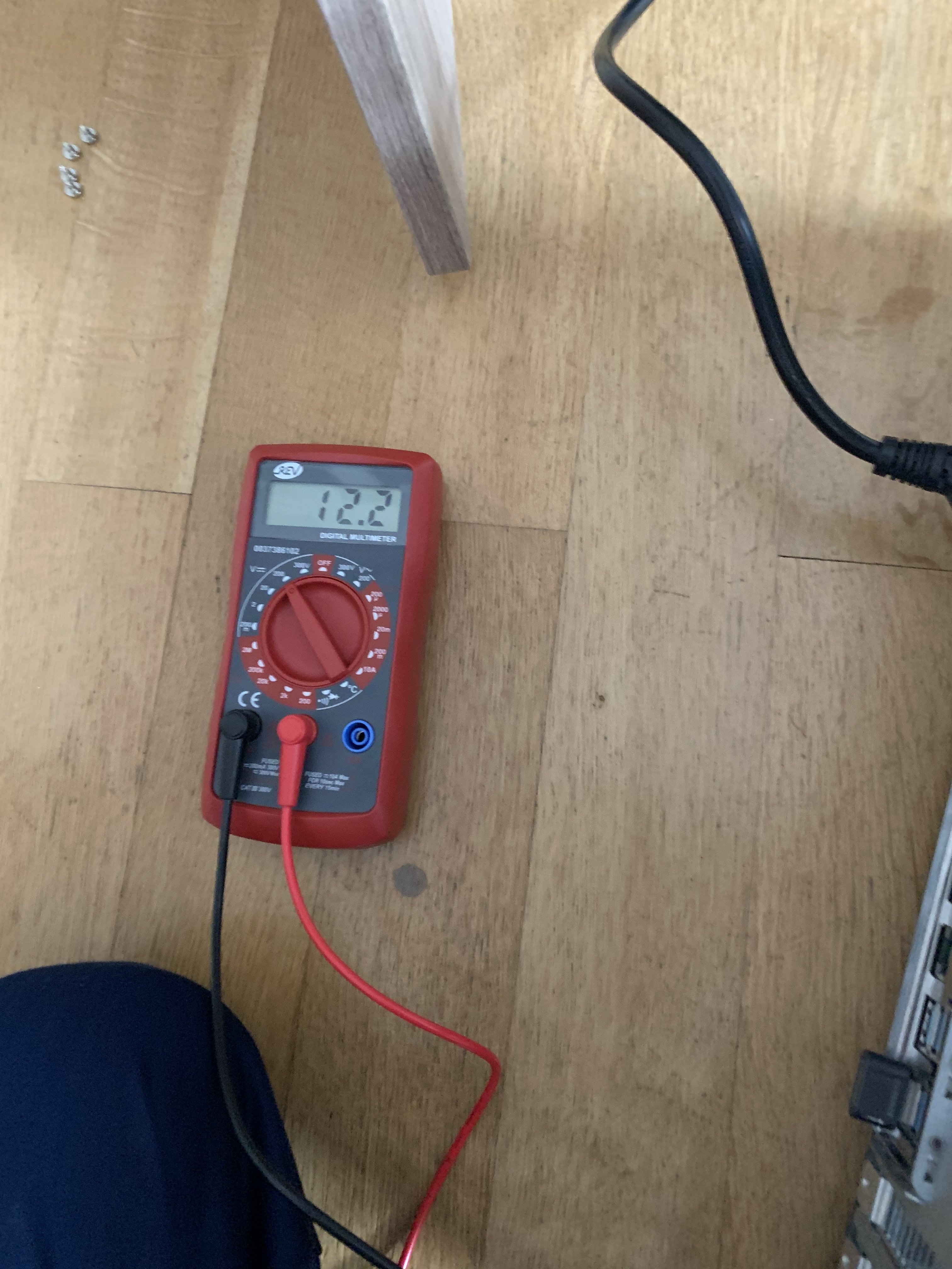

Set multimeter set to DC volatage
Black probe to a black cable
Red probe (from meter) to yellow cable.
You should get a reading on +12V, check it is not - 12V
I will test this tomorrow! Thx!

This is what you mean, right? 👇 (Please ignore the tangled cord)

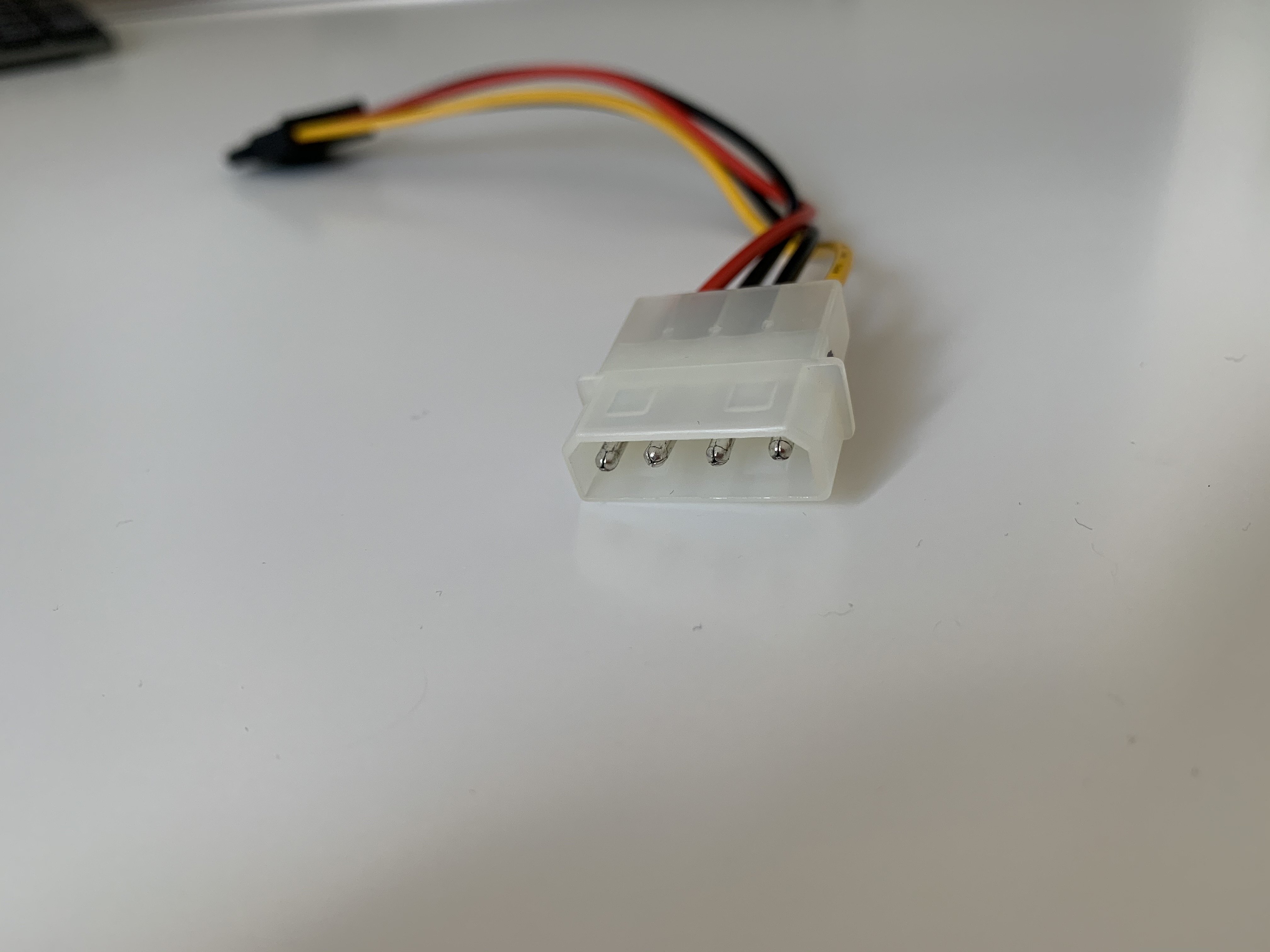

The cable above looks odd as I can't see the pins for the red and back on the front edge, but you should definitely check  by powering up the disks via Molex before anything more distructive. For now just see if it spins up, no data connection.
Ahhh ... without data connection I haven't tested. I try this also tomorrow!

Just tested this as you described.
I got +12.2V - so I guess this is good news for using the cages the same way as before, right?
I guess the cable looked odd just because of the angle. Below I attached a new picture from a better angle. I think the cable is fine.

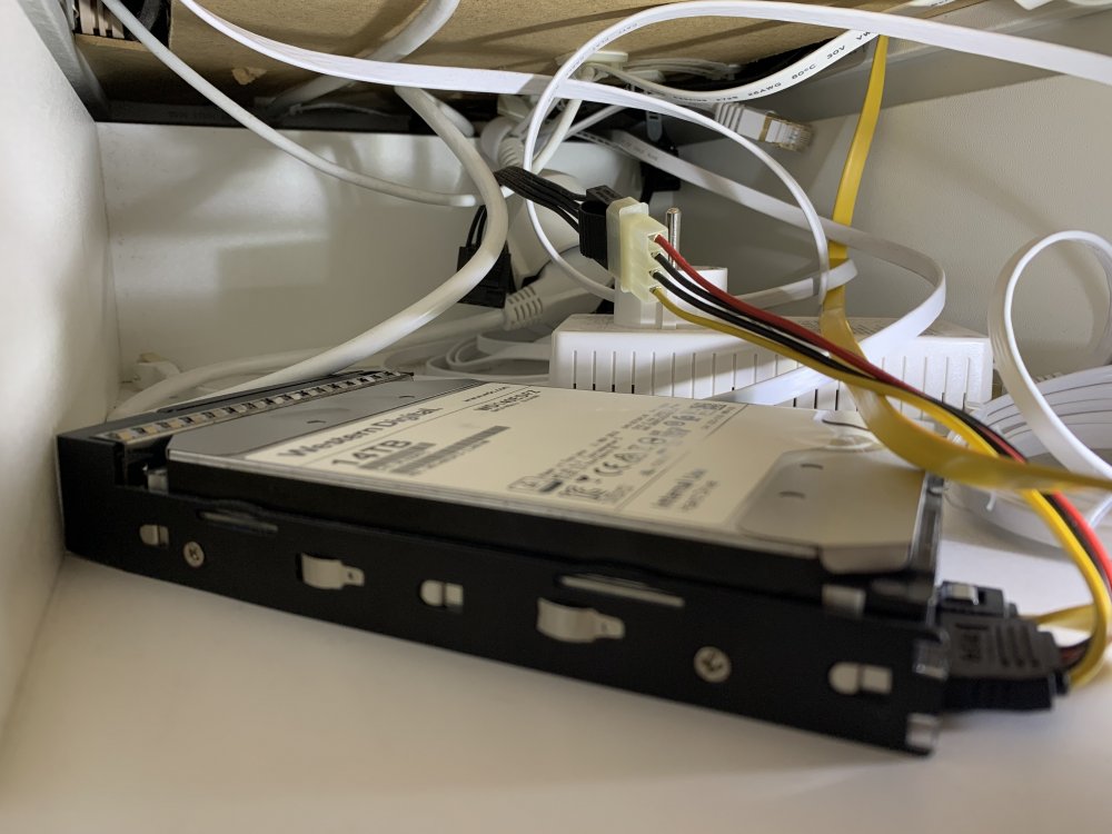

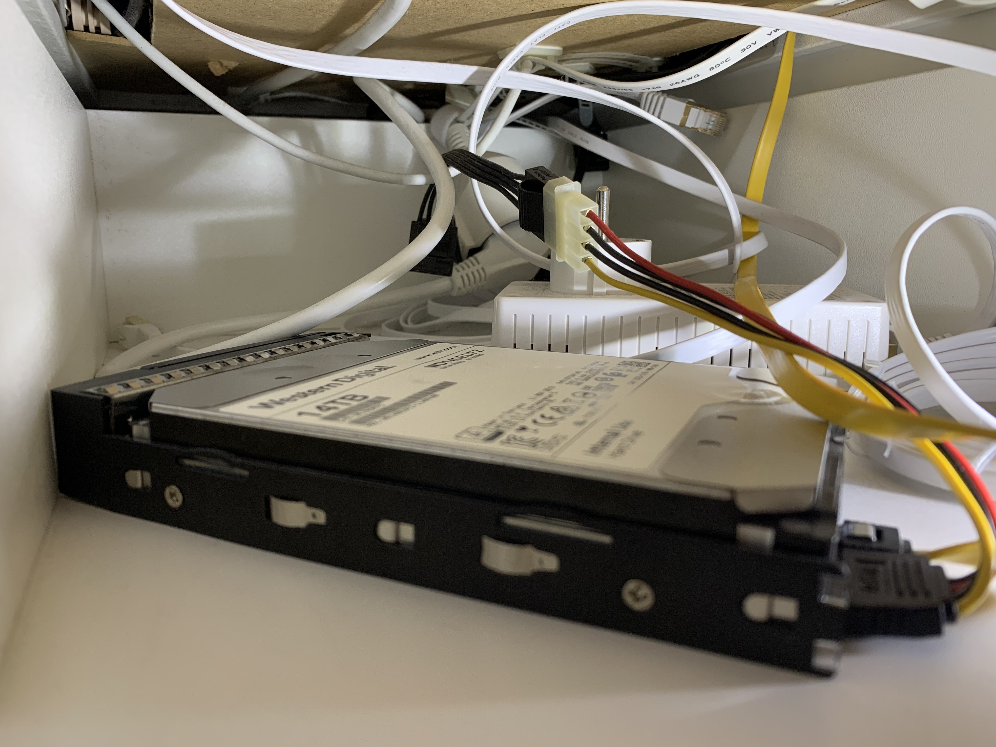

I also tested the only SATA Power connection on my PC (in the drawer tangled cord) today to see if the drive spines up. Unfortunately it doesn't. It's still completely without any life sings.
