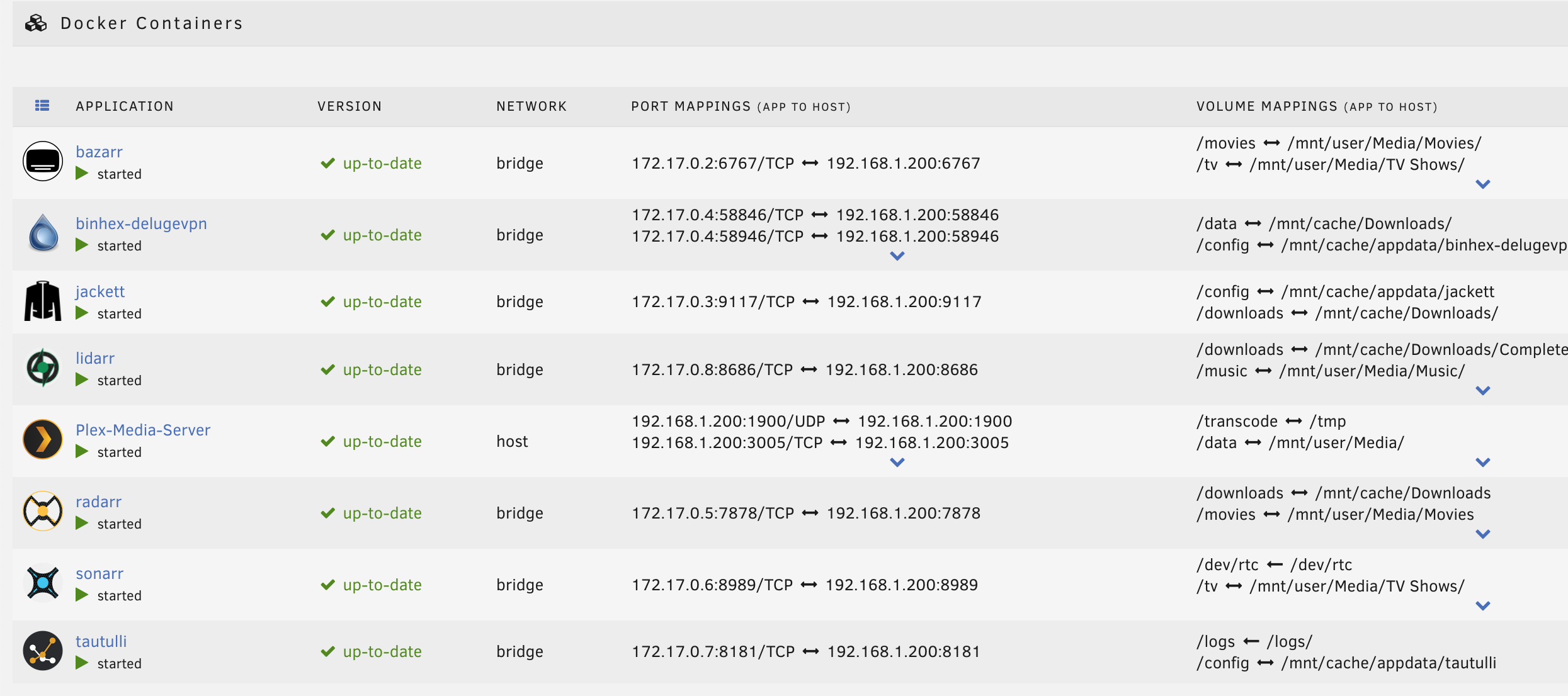

I recently decided to dive into unraid and set everything up, and I must say although there are a ton of guides, some things are still confusing to me.

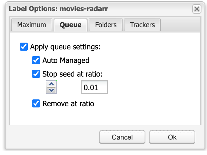

- I recently setup radaar to download something through deluge, and that worked fine.  But 1, it didn't move anything after downloading, I was just testing it with a very small seed ratio and it didn't seem to stop and move.
- When I moved the file manually into my designated "finished folder" (eg. /mnt/cache/Downloads/Completed/Movies), Radaar didn't seem to pick it up.
I may be impatient and just wanted to make sure I'm setting this up correctly and would love advise from everyone.  Am I mapping my drives correctly and configuring it the right way?  I'm guessing the flow is 1. deluge downloads something 2. deluge seeds for a predetermined time 3. deluge moves labels to "completed" when done seeding 4. Radarr sees something got into it's "Watched" folder and then moves it into it's final destination on the array.

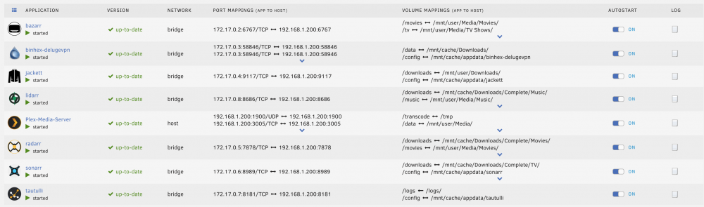

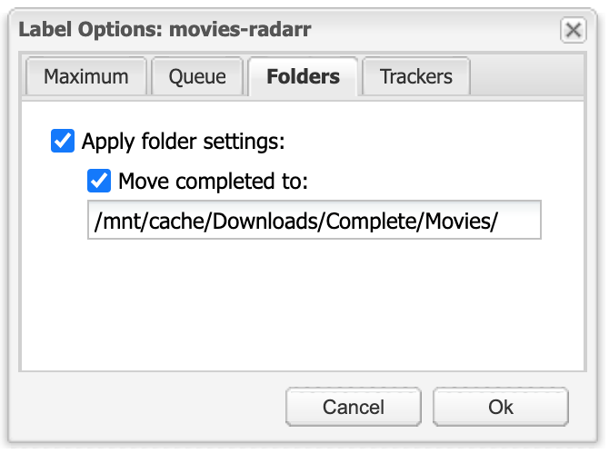

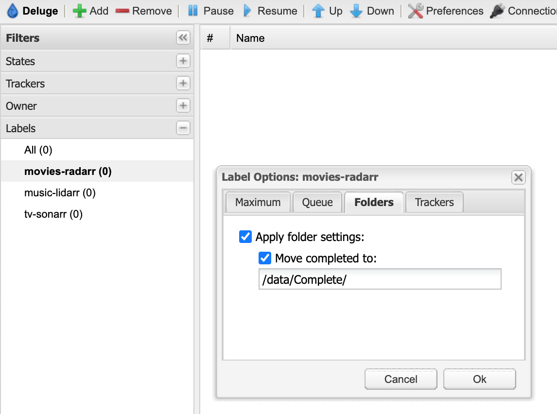

Those screen shots I assume are from deluge.  You're telling it to move to /mnt/cache/.....  Except that you haven't mapped /mnt in the template (docker tab) on deluge.
What you need to do is move it to /data/.....
See here for how path mapping works https://forums.unraid.net/topic/54834-video-guideall-about-docker-in-unraid-docker-principles-and-setup/
Followed by https://forums.unraid.net/topic/57181-docker-faq/?tab=comments#comment-566086 for what most people have problems with afterwards
Thanks.  I think I understand.  I updated deluge to:
Ok looks like it now deletes the torrent, and moves the downloaded files into the correct place, but how does radarr pick it up?

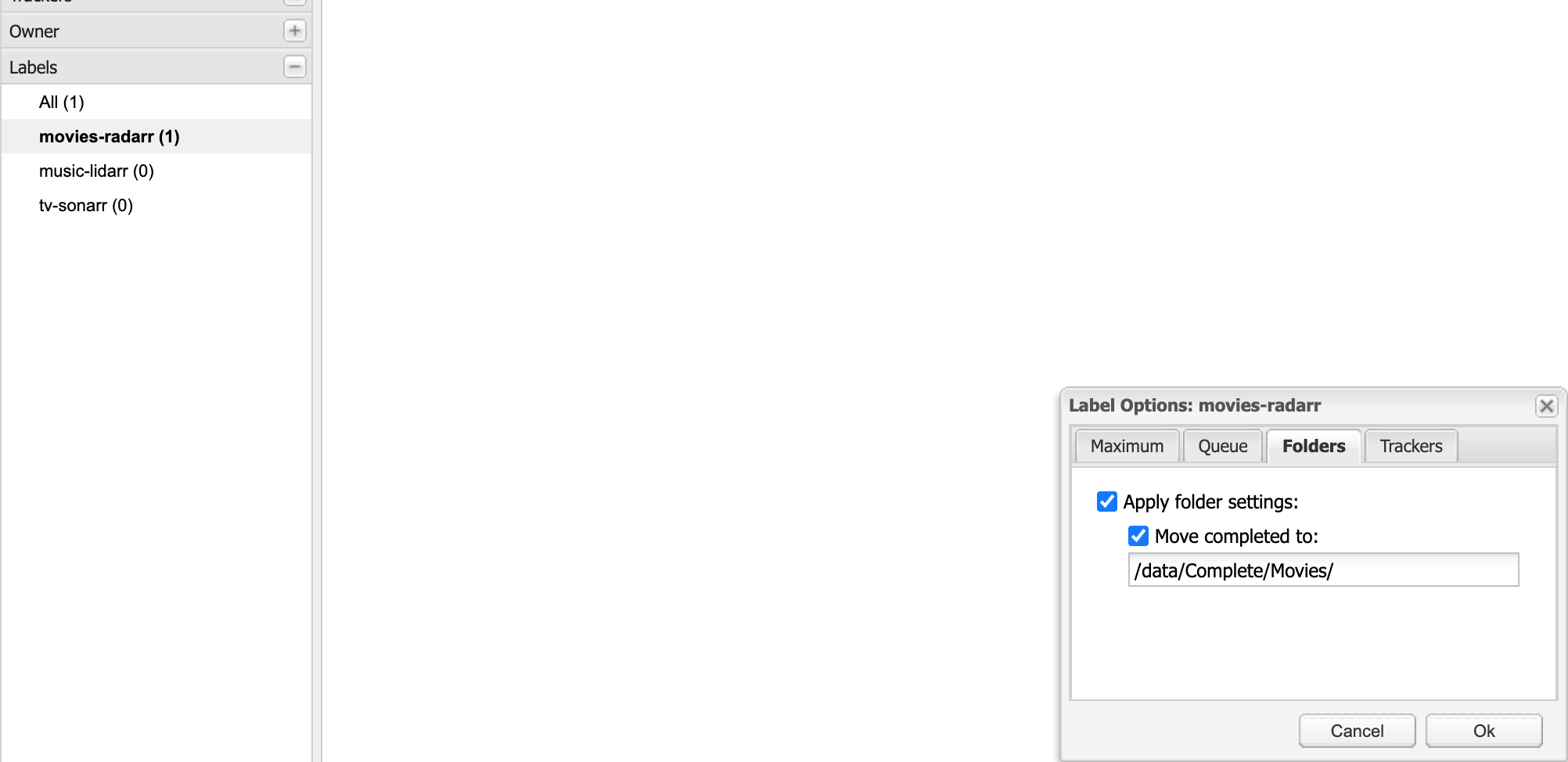

No Dice.  Still doesn't seem to pick it up and copy it over.
Any thoughts?

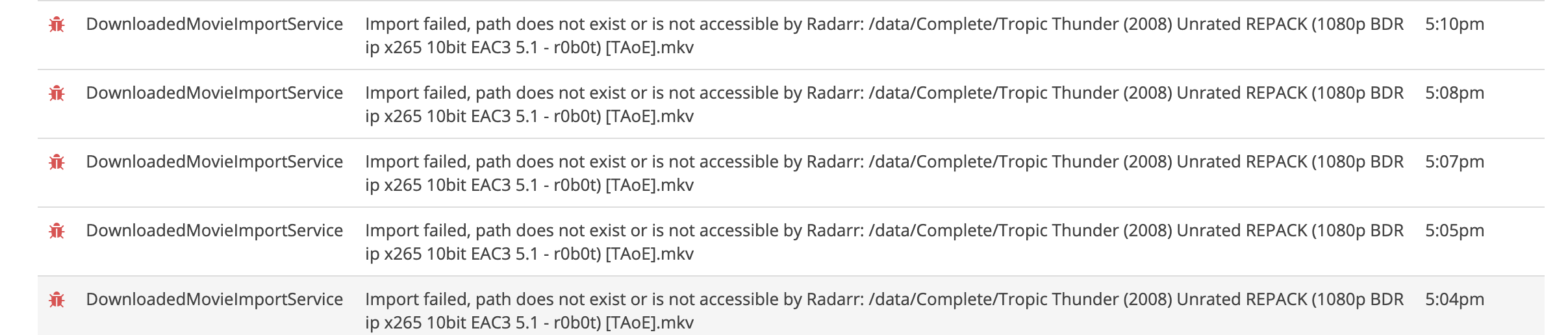

NZBGet is telling radarr that the file is at /data/Complete/...
Suspect you don't have a /data folder in radarr.
Study the links Squid gave.

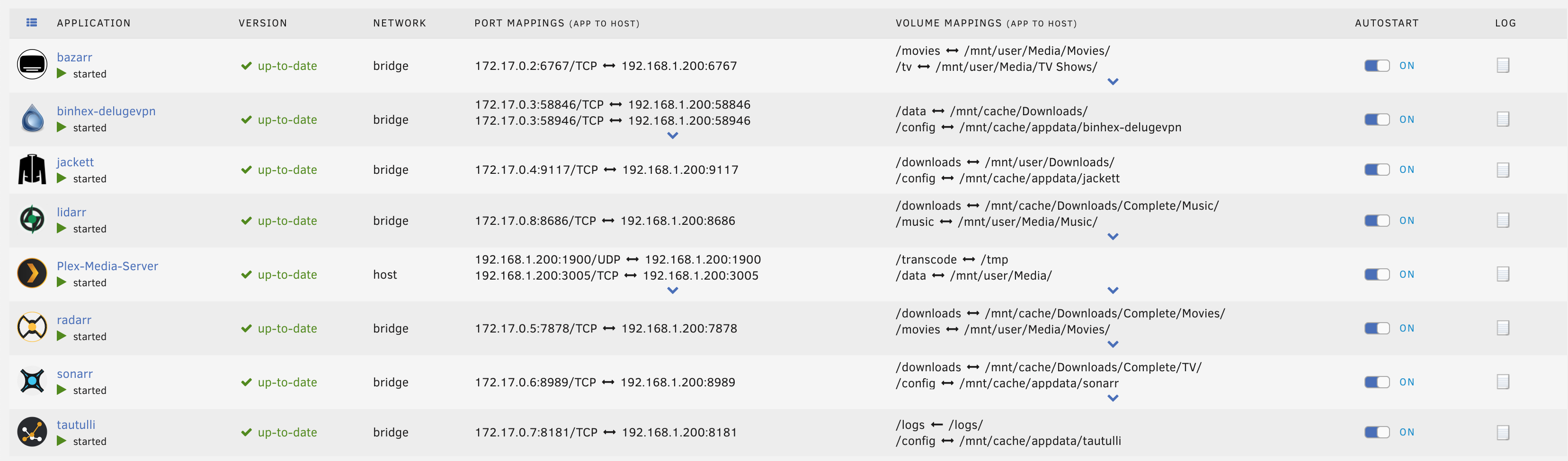

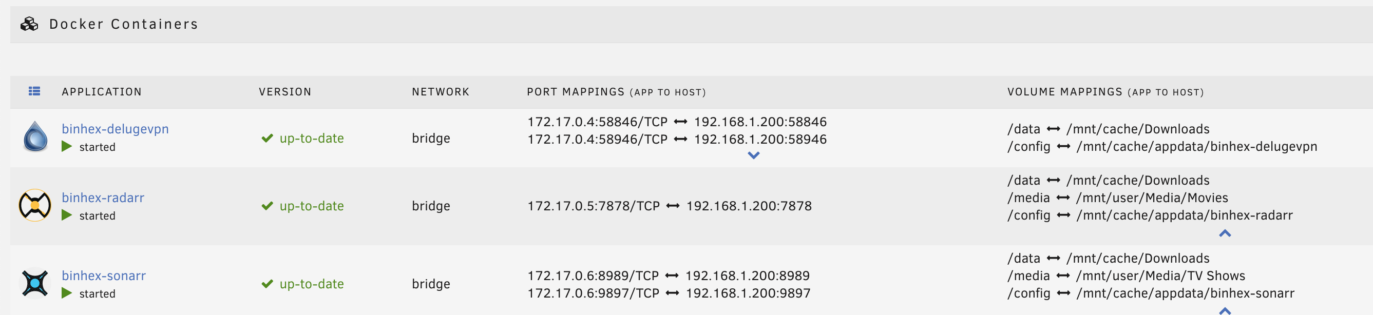

Thanks for the help @trurl .  It looked at first that it was because there was no /data folder in Radarr, so I removed the containers and installed the bin_hex versions of them so everything lined up.
Deluge looks like it moves the finished file into the completed folder which is good, but Radarr still can't see it.  The 2 tester videos I keep downloading are downloading and being placed without folders in the completed folder does that matter?
From what I've read on the drive mapping, it looks correct.  I have no idea why it's not pulling over.

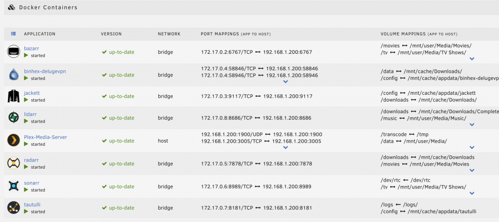

Just FYI, there's absolutely nothing stopping you from adding a /data mapping (or any mapping for that matter) to any given container

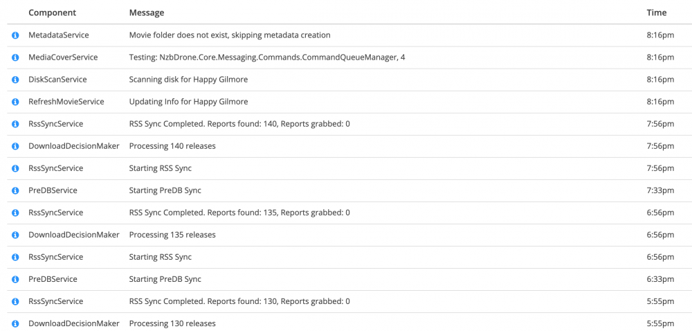

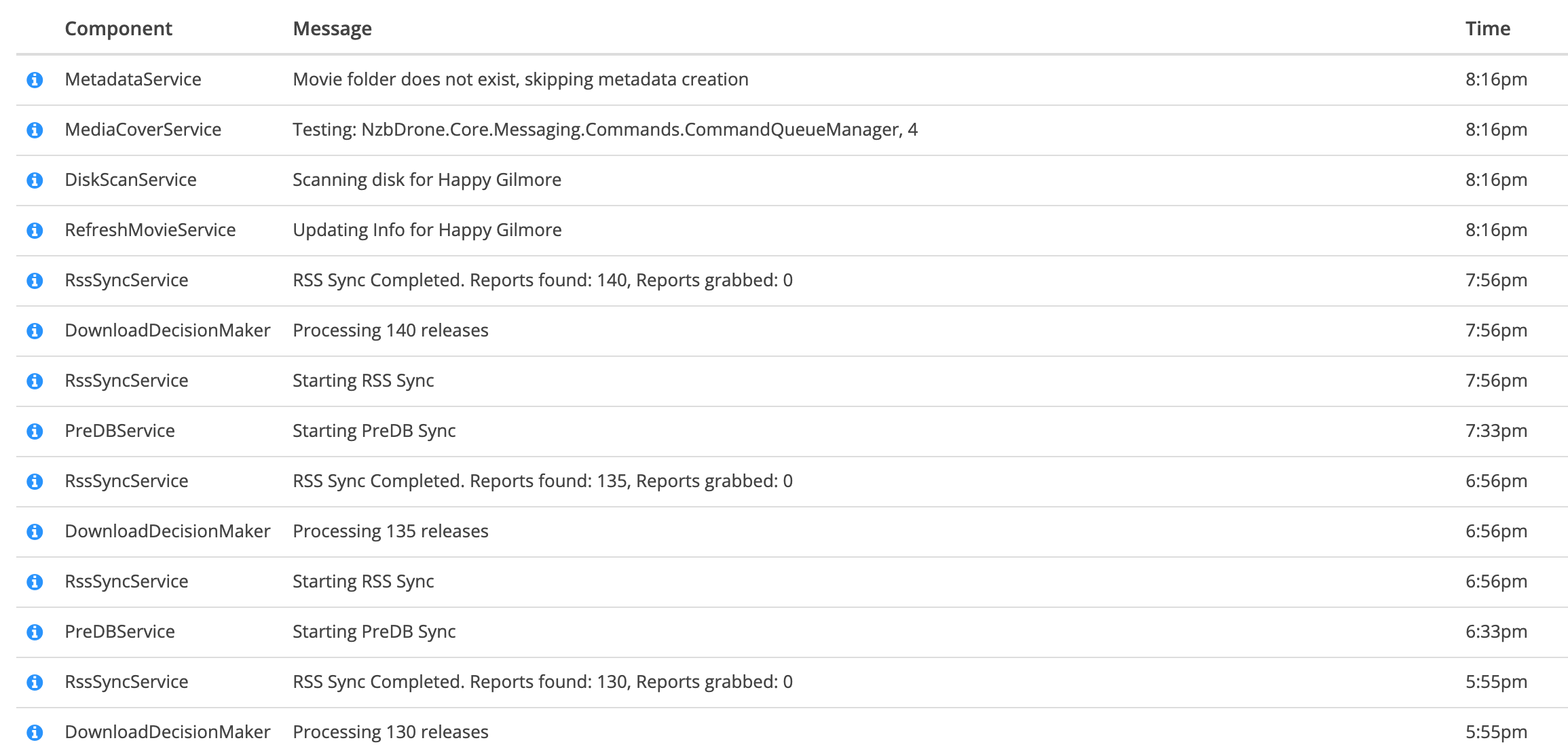

Error I keep getting seems to be "Movie folder does not exist, skipping metadata creation"
 I don't have any "remote path mappings" in my download client path. Does that have anything to do with it?
yes: you need to translate the folders from deluge to folders in radarr:
