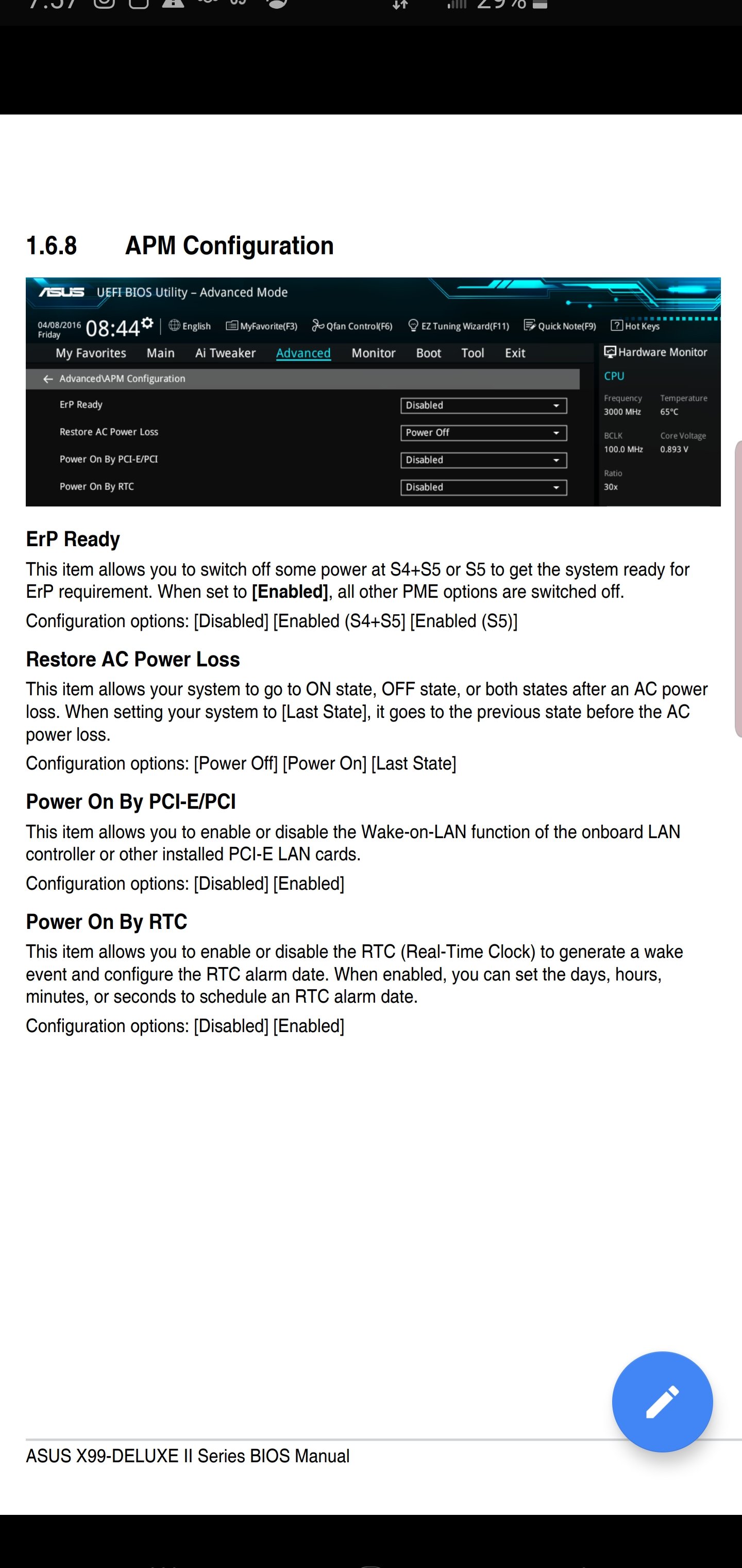

Then when power comes back on, I need a way to boot the Unraid box. It uses a Asus x99 Deluxe ii motherboard.....I dont think it has IPMI, but it does have a couple settings that may be useful for this.....I think the "Restore AC Power Loss" and maybe the "Power on by PCI-E/PCI".  ALSO, I do have VPN into my router setup and use it often to log into Unraid when away from home.

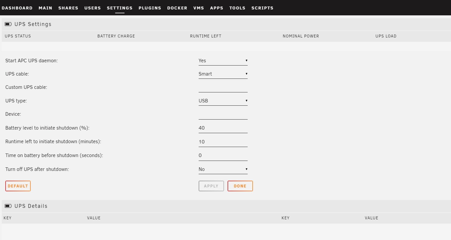

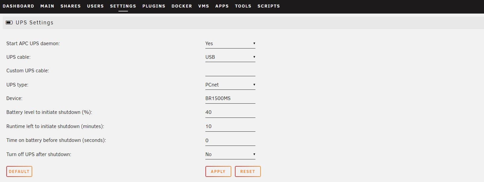

Well I have the battery hooked up but it seems like Unraid isn't finding it. I'm not sure if its a setting or something else but it isn't bringing in any of the battery information. Anyone have any thoughts on it?  Here are the settings I'm using.......
I got Unraid to see it....I just had to reboot the server and it picked it right up.
