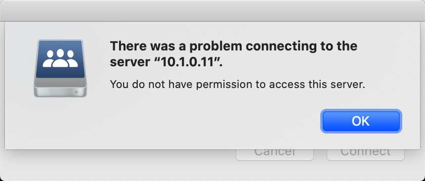

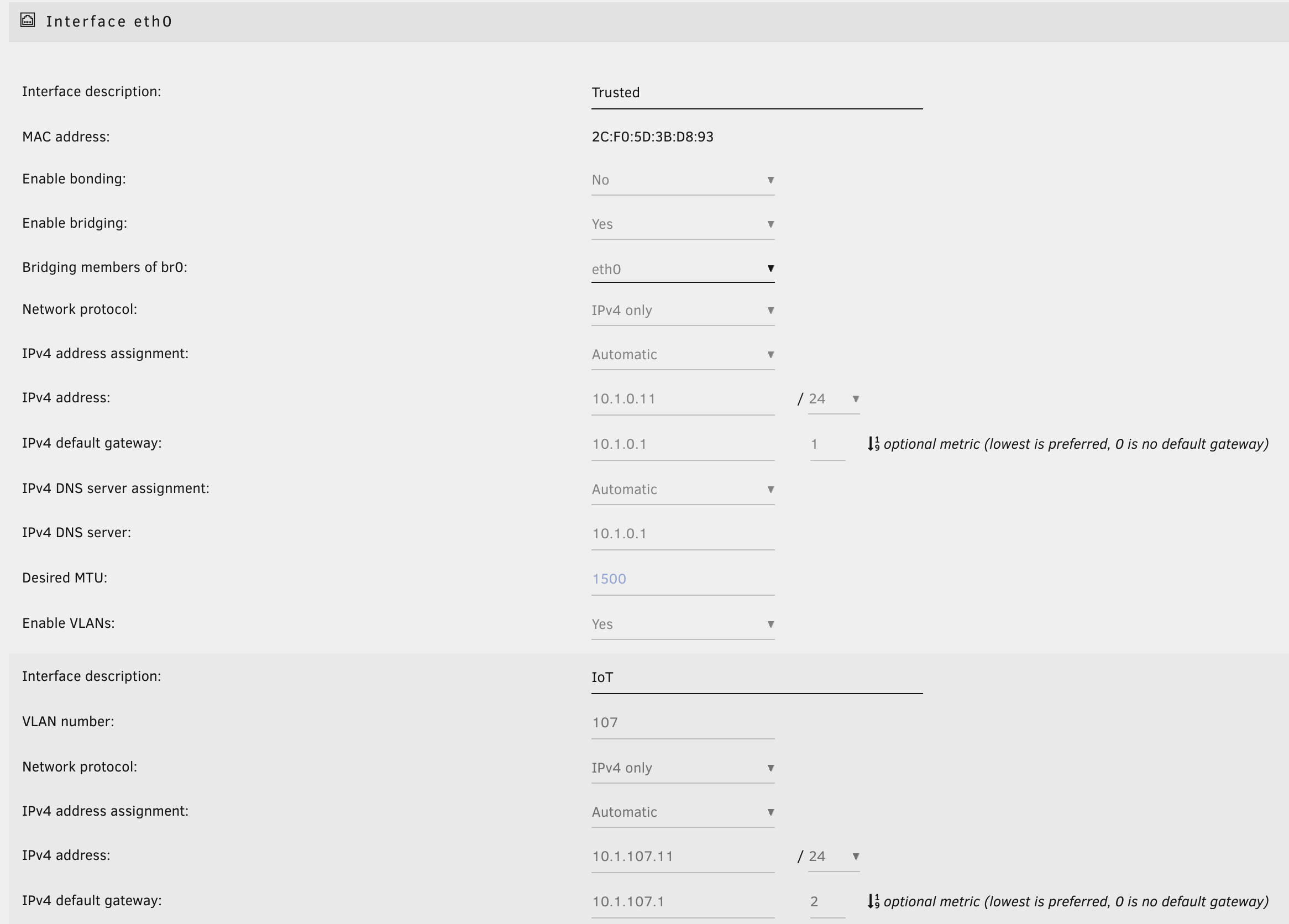

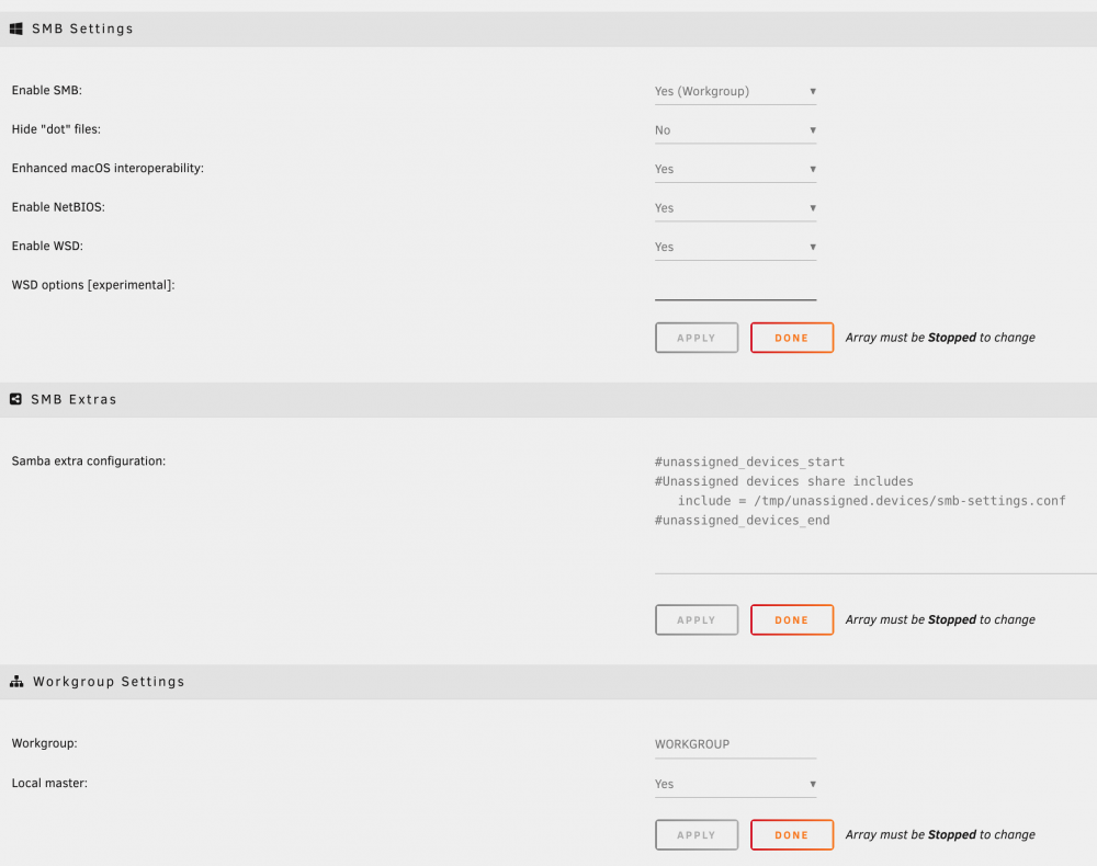

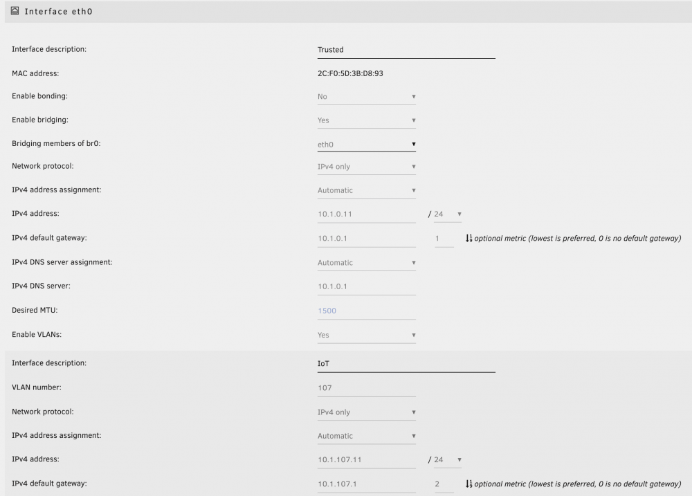

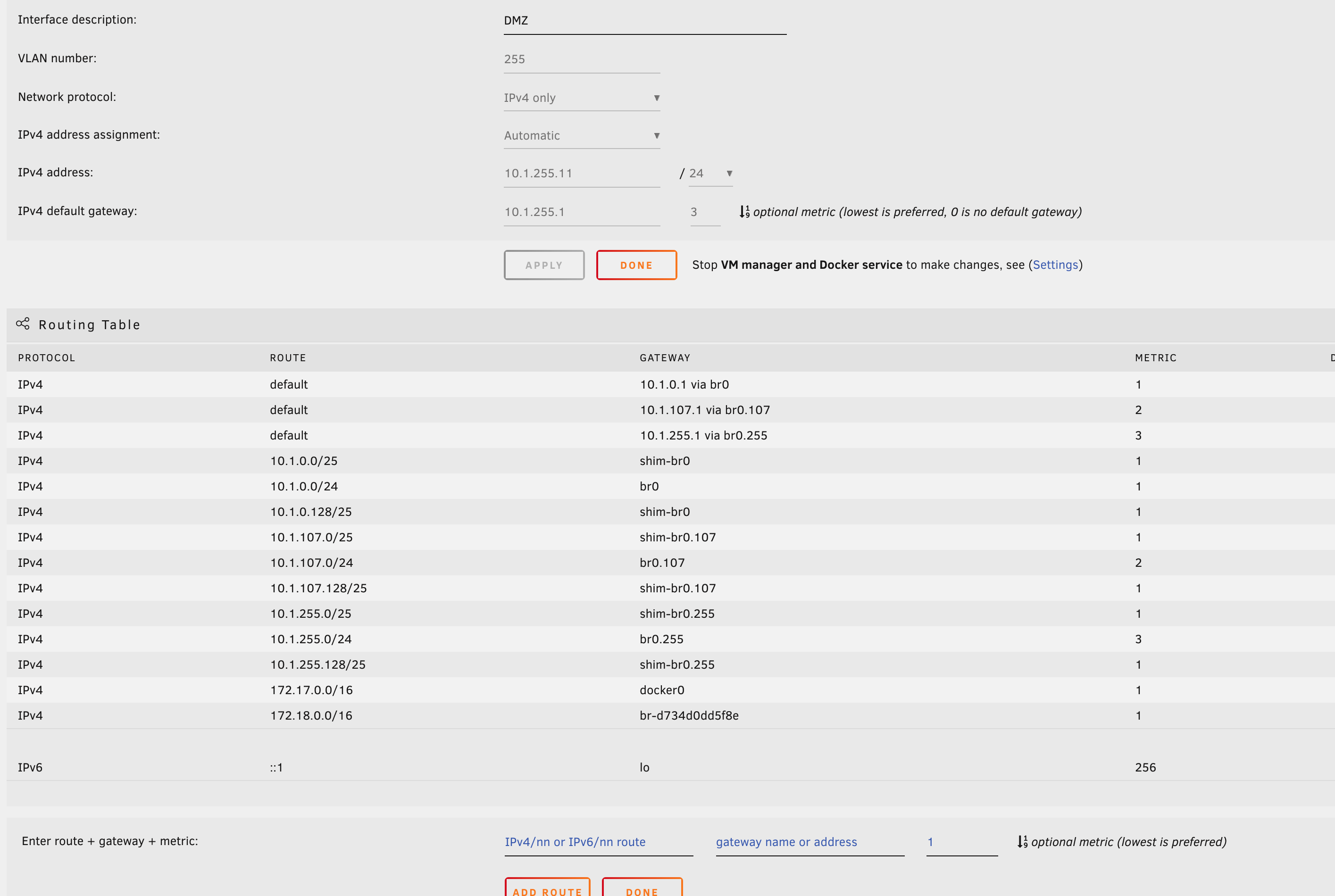

I'm scratching my head on this and don't know why my shares aren't working anymore. Between the last time it worked and now, I've added a few VLAN networks for my docker containers.
tl;dr: Rebooted unRAID and it's working again. Not sure why

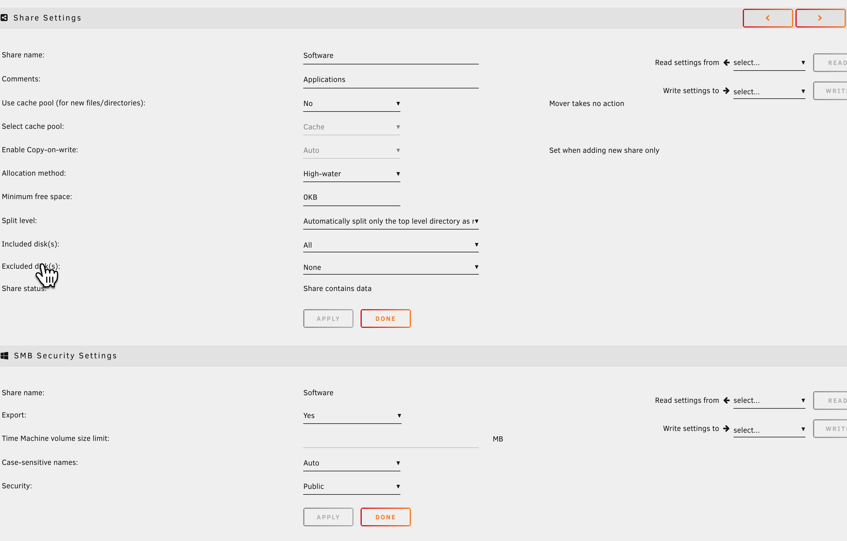

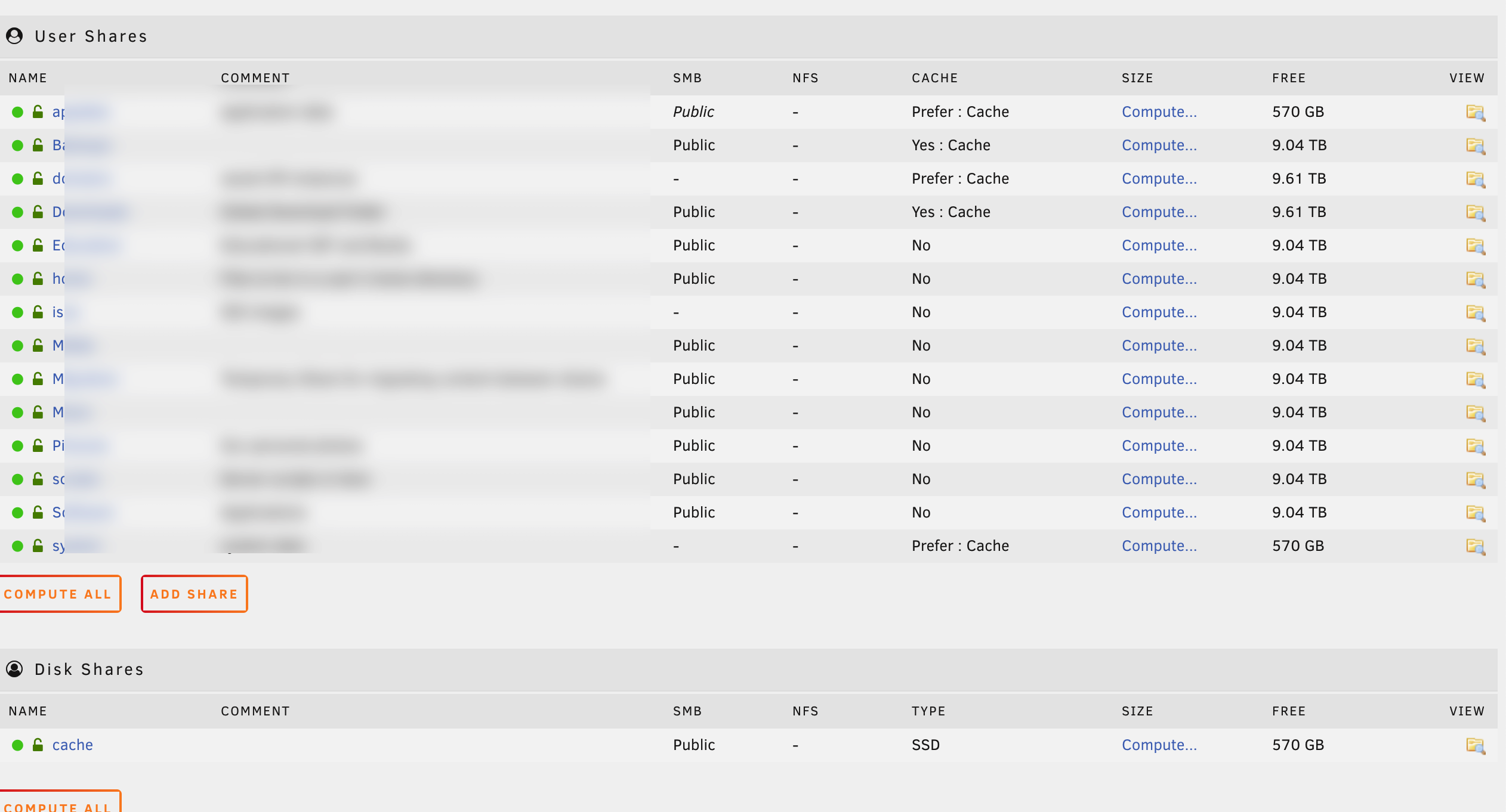

Note: This is across all my shares, but I'm just using Software in this example. Fix Common Problems only shows issues with out of date containers.
I do have a few user accounts but the shares are all public.

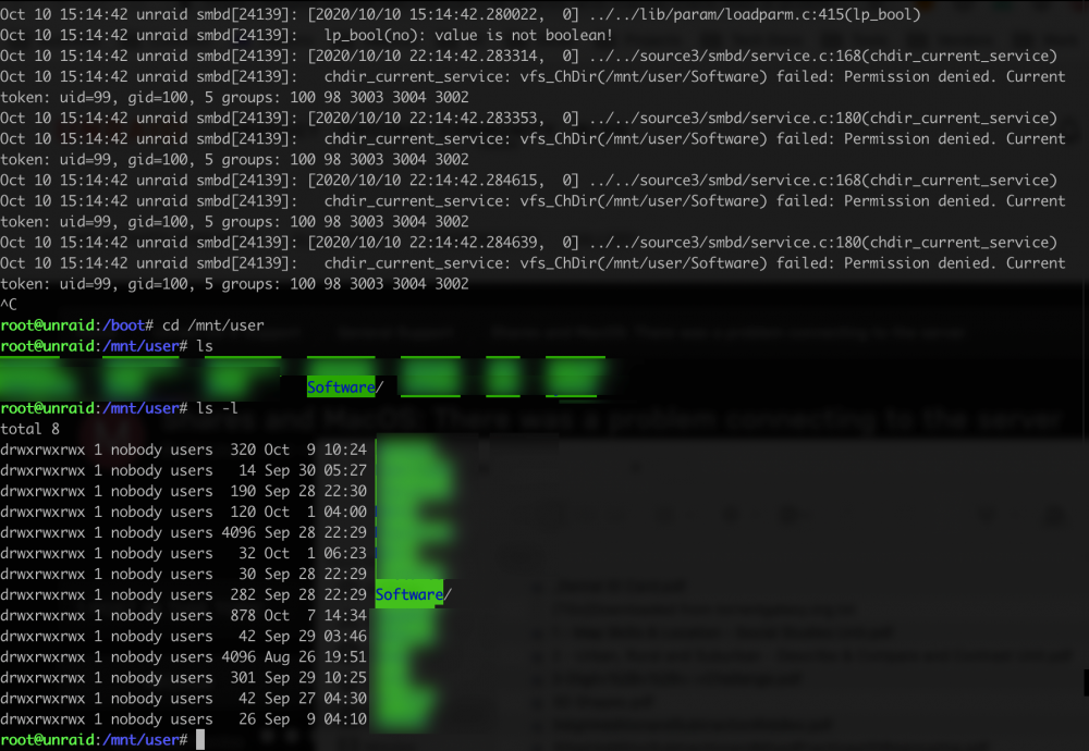

Sometimes the error flips between "You do not have permission to access this server." and "There was a problem connecting to the server"

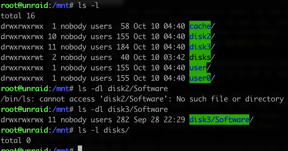

Below is what I see in the syslog, but the permissions to /mnt/user/Software is still 777
Software on the actual disk is still 777 too.
Hope this is enough information.

I rebooted into safe mode and it worked...what could stop it from working when not in safe mode?
Solution: Reboot
Not sure what happened but rebooting unRAID seems to have fixed it.
