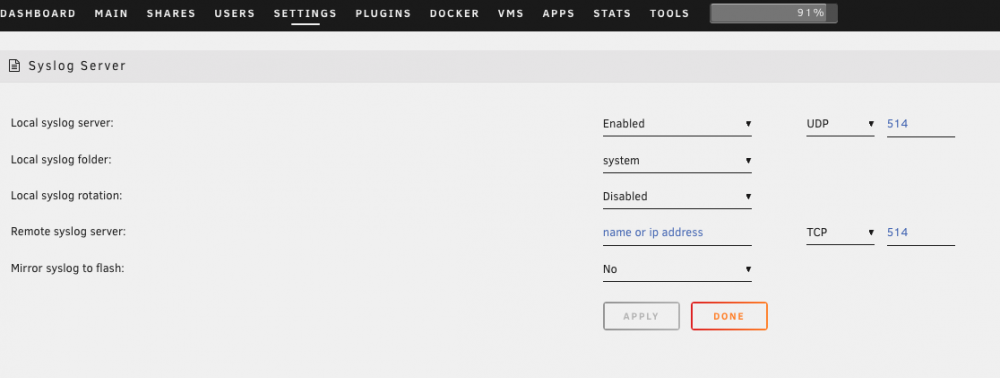

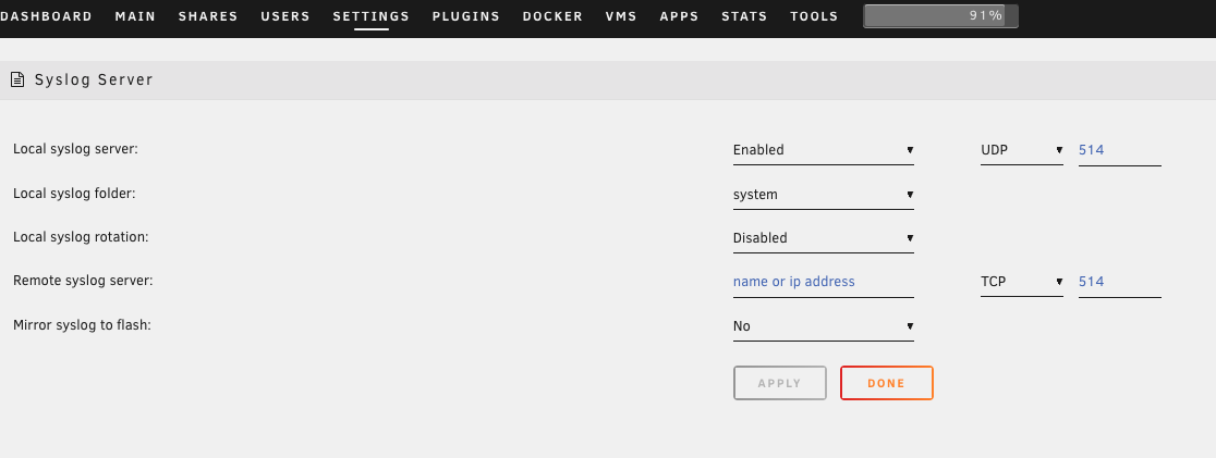

This says that It should be logging syslog here... but it is a complete lie or misdirection. As far as I can tell.

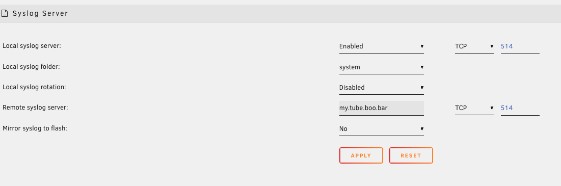

Figured out how it can work. setup the listener and the server in the sections listed. so that it is sending to the ip of itself... (unraid server)...
Took about 3 minutes to push a few buttons and test after looking back into it. creates a file in the listed directory. having tcp and tcp set to the same is important... udp/tcp failed. lol.
