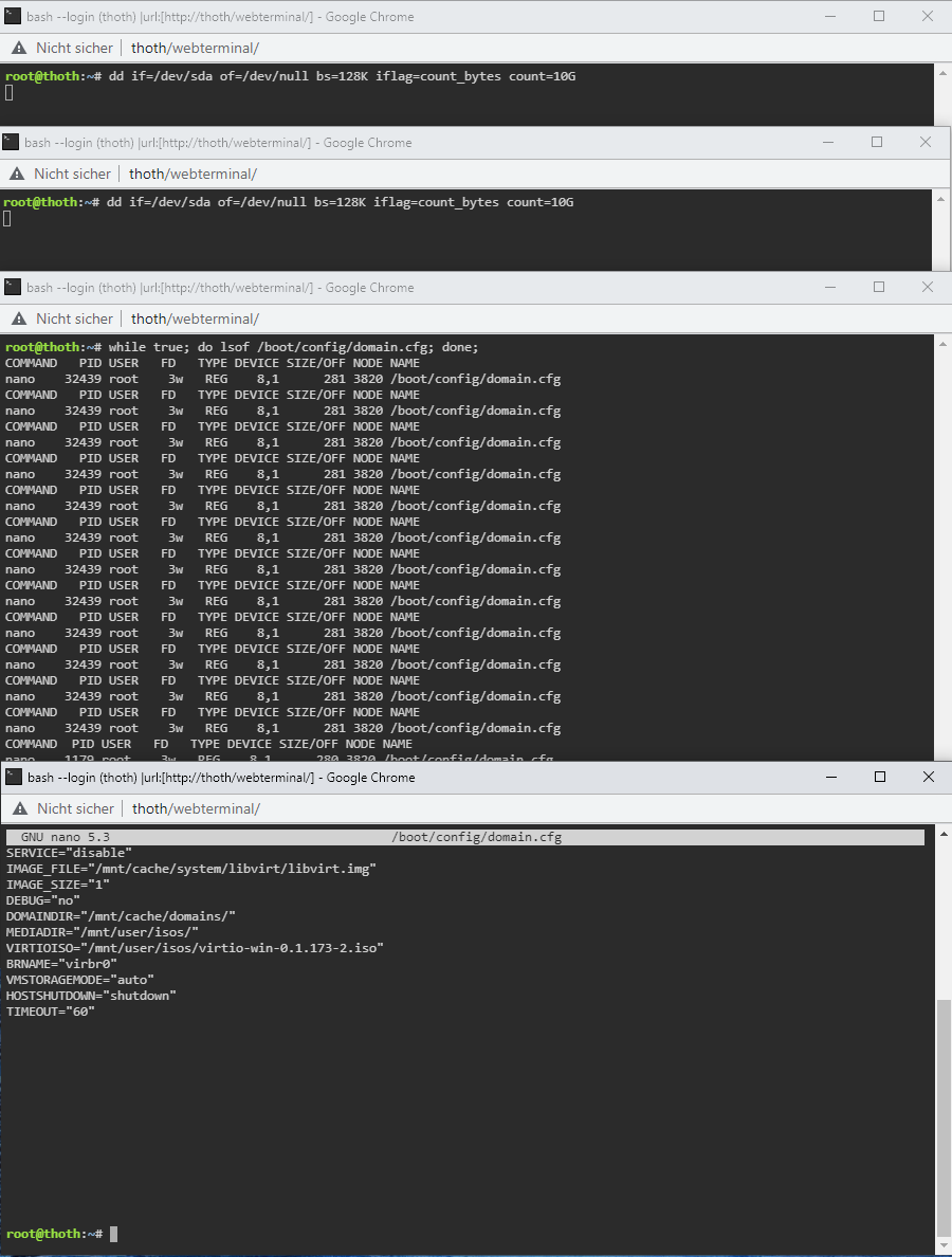

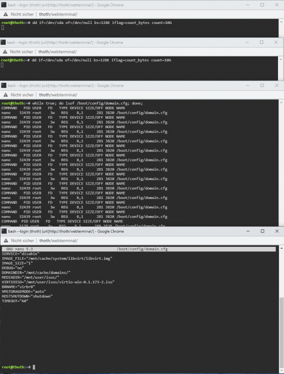

July 7, 20215 yr You could try the following: Open a web terminal and execute the following: dd if=/dev/sda of=/dev/null bs=128K iflag=count_bytes count=10G Open a second web terminal and execute the same again: dd if=/dev/sda of=/dev/null bs=128K iflag=count_bytes count=10G By that we are stressing the usb flash drive so it becomes slower if something tries to write to it. Open a third web terminal and execute our monitoring command: while true; do lsof /boot/config/domain.cfg; done; Now wait. The idea behind it is, that updating the domain.cfg takes a little bit more time so lsof will be able to catch it. With this method I was able to catch file updates through nano which was not possible without the stressing dd processes:
July 8, 20215 yr ok, but I ak not sure what that has solved... I was able to edit the file while doing the two DD commands and running the lsof in the loop. Vim barked duriong save because the file was updated during my edit period. I saved anyways and saw the one item show up in the while loop.... I never saw anything else with an open handle to that file....

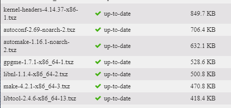

August 24, 20215 yr And another try which failed: https://sourceware.org/systemtap/SystemTap_Beginners_Guide/inodewatchsect.html I installed the Dev Plugin and selected all packages and installed them. After that I added these packages: wget -P /tmp https://packages.slackonly.com/pub/packages/14.2-x86_64/development/systemtap/systemtap-4.1-x86_64-1_slonly.txz upgradepkg --install-new /tmp/systemtap-4.1-x86_64-1_slonly.txz wget -P /tmp https://slackware.uk/slackware/slackware64-14.2/slackware64/ap/rpm-4.12.0.1-x86_64-1.txz upgradepkg --install-new /tmp/rpm-4.12.0.1-x86_64-1.txz wget -P /tmp https://slackware.uk/slackware/slackware64-14.2/patches/packages/mozilla-nss-3.40.1-x86_64-1_slack14.2.txz upgradepkg --install-new /tmp/mozilla-nss-3.40.1-x86_64-1_slack14.2.txz Then I tried get the inode and execute stap: stat -c '%D %i' /boot/config/domain.cfg 801 1749 stap inodewatch.stp 0x8 0x01 1749 Checking "/lib/modules/5.10.28-Unraid/build/Module.symvers" failed with error: No such file or directory Ensure kernel development headers & makefiles are installed I don't understand why it does not work as the Dev Pack includes Headers and Make: So tried this tip and created an empty Module.symvers: touch /lib/modules/5.10.28-Unraid/build/Module.symvers then created: touch /boot/config/inodewatch.stp and added the script: #! /usr/bin/env stap probe vfs.{write,read} { # dev and ino are defined by vfs.write and vfs.read if (dev == MKDEV($1,$2) # major/minor device && ino == $3) printf ("%s(%d) %s 0x%x/%u\n", execname(), pid(), ppfunc(), dev, ino) } Executed again: stap /boot/config/inodewatch.stp 0x8 0x01 1749 warning: Generating 12 missing index(es), please wait... semantic error: while resolving probe point: identifier 'kernel' at /usr/share/systemtap/tapset/linux/vfs.stp:1048:19 source: probe vfs.write = kernel.function("vfs_write") ^ semantic error: missing x86_64 kernel/module debuginfo [man warning::debuginfo] under '/lib/modules/5.10.28-Unraid/build' semantic error: while resolving probe point: identifier 'vfs' at /boot/config/inodewatch.stp:3:7 source: probe vfs.{write,read} ^ semantic error: no match Pass 2: analysis failed. [man error::pass2] Number of similar error messages suppressed: 2. Rerun with -v to see them. I won't give up ^^
