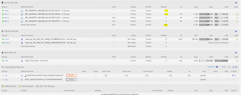

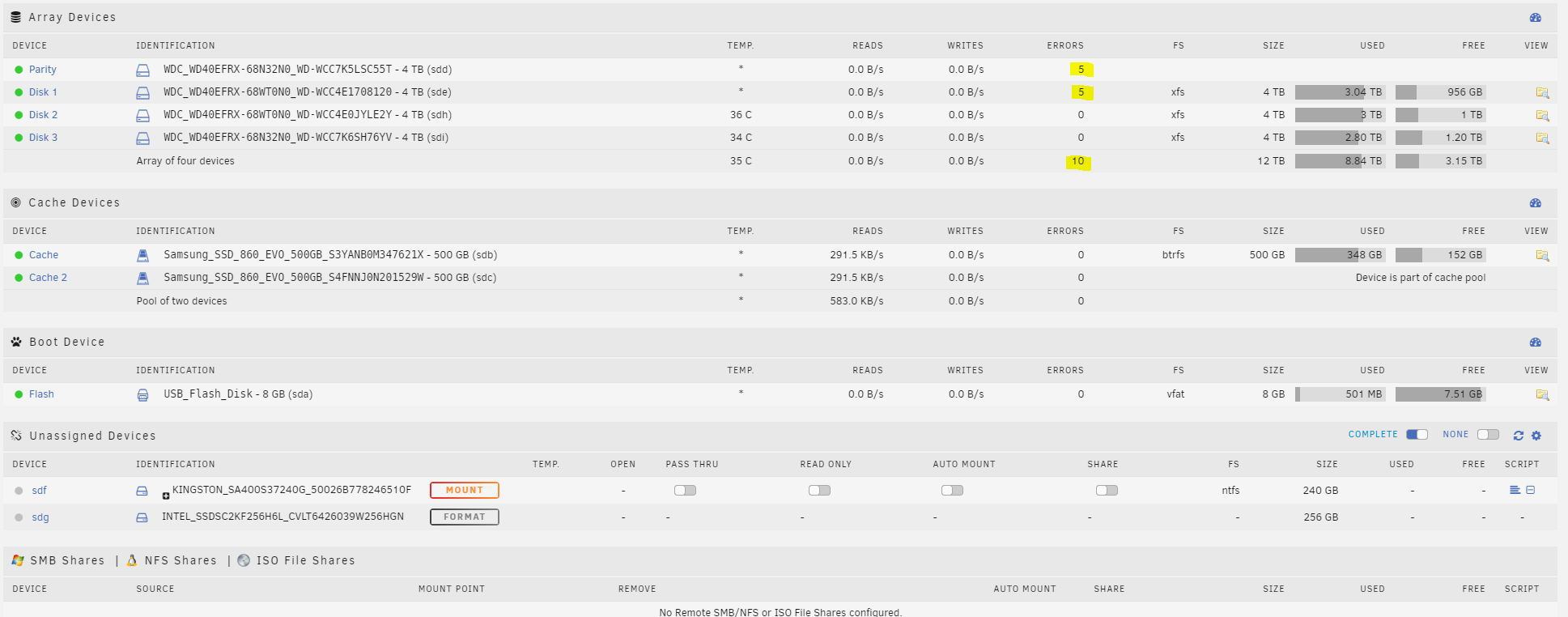

Array:

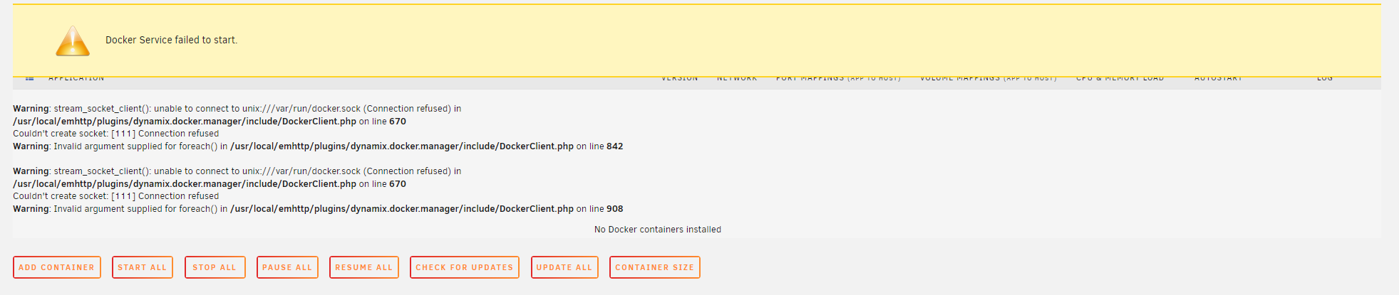

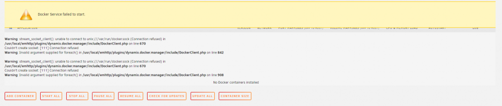

Docker:

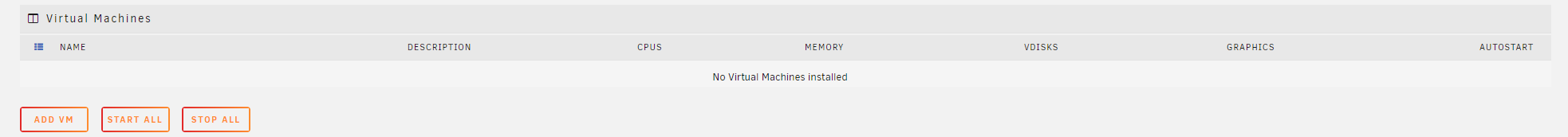

VMs
I had 5-6 VMs yesterday....

Your BTRFS errors are a different problem than the array errors you are highlighting.
Your BRTFS errors seem to be on sdb and/or sdc (your cache drives) and your array is formatted in XFS.
I cannot see your SMART diagnostics for any drive I checked.
A mandatory SMART command failed: exiting. To continue, add one or more '-T permissive' options.
Can you run SMART manually on the drives with errors ? I'd say sdd & sde + maybe sdb & sdc to be sure.
