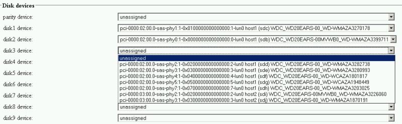

Looking at the serial numbers, I found out that:
All working discs start with "WMAZA32...."
Some drives report a longer serial which include "MVWB0", those are working.
All drives with "WCASA" failed during preclear, my syslog went up to 2GB ...
The two DOA drives had also a "WMAZA1..." serial. They did not work at all.
Seems that the faulty drives can be determined by serial numbers.
I'm gona test the two "WCASA" drives with WinXP, the DOAs don't work at all.

Unfortunately, 2 of these drives had immediate issues.  One would consistently fail to preclear and although the other passed preclear, it recently redballed after putting a few GB of data on it.  Running a short/long SMART test fails at 90% with an unknown failure and a notice of Raw_Read_Error_Rate of "FAILING_NOW".  I RMA'd the first one already and am in the process of RMA'ing the other.
Interestingly enough, the two that failed both had serials starting with WMAZA1.  And unfortunately, out of the two remaining, I have one other "WMAZA1", but this one appears to be good (so far...).  Out of my recent purchases, this one has been in use since Nov, so it's the "oldest".  Really sounds like a bad batch, tho...

I've just switched the non working drives to another bay and therefore another part of my controller (SuperMicro SASL), just to check if there is a problem with one of my controllers or cabeling. But if there was, why did the disks stop twice at 51% without any previous error?
5 drives are currently working, 5 not, but one of the non-working-drives was preclearing OK when I stopped for reboot... so there are still chances on 6 of 10... which is very bad also.
The jumpers went on the drives the moment they left their plastic bag ... but if they'll fail again this time, I'll try writing zeros to the MBR. Thanks for the hint.
