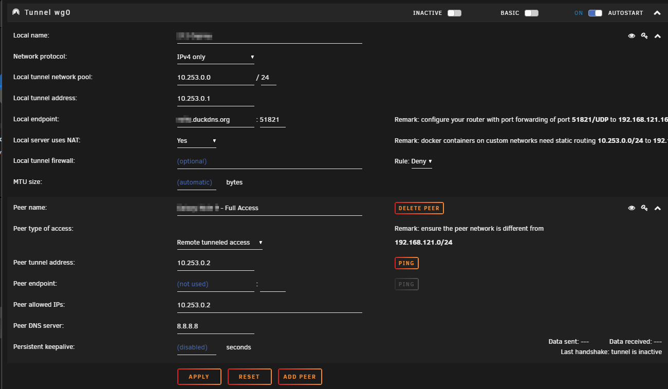

Wow, uploading the files made me realize I was making a terrible mistake - the tunnel with the most recent updated settings was set to inactive. It now works once activated! Sorry for the false alarm.
Edit: I can now establish a handshake, but I still can't connect to anything within the network. Any thoughts? Screenshots attached.

It can be frustrating to get this working as WireGuard gives minimal feedback.   I expect it is going to be something simple when you track down what is wrong.
Exactly what are you trying to access via the tunnel (Unraid server, LAN connected machines, internet). For instance are you trying to access your server by IP or by name?    Name will not work as the DNS server specified is not the one local to the Unraid server so name->IP resolution will not work.  If using IP address you should use 10.253.0.1 since that is the address of the server end of the tunnel.
