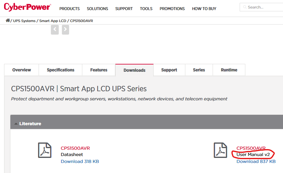

The link that you posted has a back panel picture that has a USB port on the back of it.  Use that port.
If that picture (or link) is not your actual UPS, you will need to locate a manual for it as some UPS are configurable from the UPS itself.  I also seem to recall that there were some UPS's that used some sort of weird serial/UBS cable...

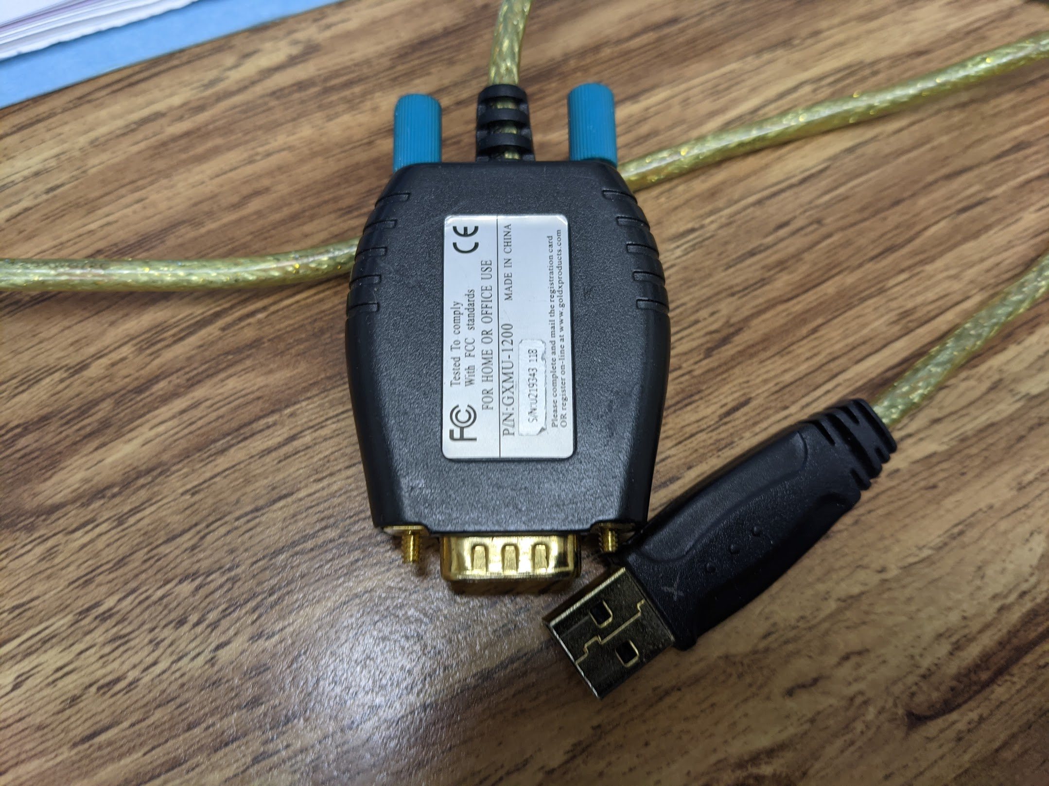

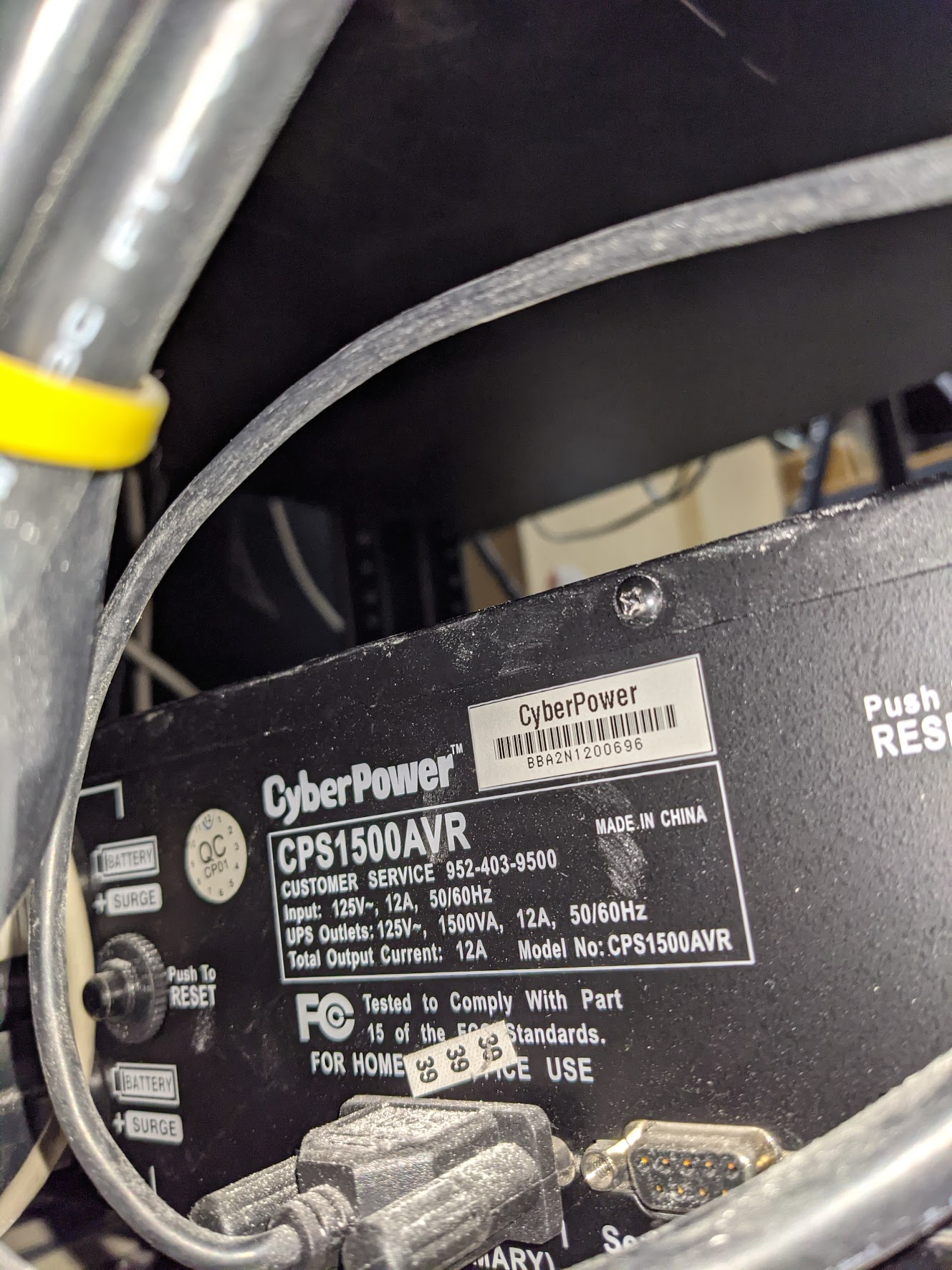

It's apparently not.  I'm the admin for the server, but not on site as it's my client's server.  Here's the photos:
image.thumb.png.2c43f94784c89a0acd090dc9318cd943.pngimage.thumb.png.c4067d2687de5ece60b6798291bce632.png
It would be a nice to have since this location sustains power outages pretty often.  I'm thinking of having them buy another smaller UPS with a USB port just so unraid can detect power outages and do a graceful shutdown as required.

It looks like CyberPower has been making UPS's using this same model number when they have, in fact, redesigned the hardware.  I don't know what you know (or can remember in my case) but setting up Serial link was always a bit of challenge.  You have to know the baud rate, number of bits and parity.  You may have to try and find a manual that matches the hardware that you have.
I also seem to recall that not all UBS-to-serial port adapters will work in every application.
