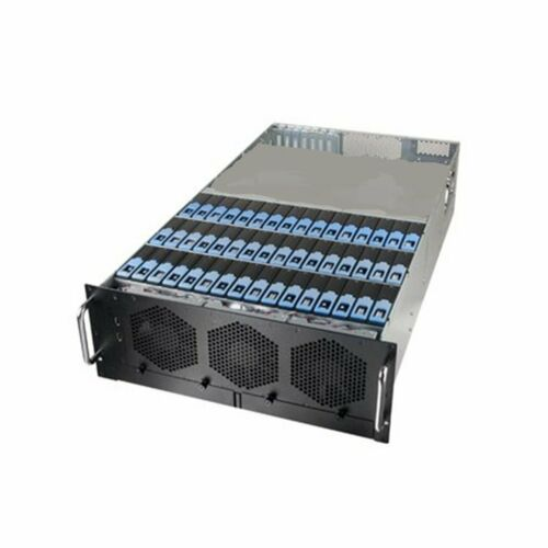

Chenbro-NR40700-4U-Storinator-48-bay - Maybee Unraid will support a dual arrays in the future :-)
I have googled and it looks like the SAS 9305-24i Host Bus Adapter - x8, PCIe 3.0, 8000 MB/s
Is useable with the backplane on the above case
Questions
  • Can anyone confirm this controller will work with this case? - (Chenbro-NR40700-4U-Storinator-48-bay + Expansion module backplate)?
  • Would I see any speed increase when using this new controller in my existing system? (Parity time? - when all the drives is spindles but all drives are 7200rpm and newer faster drives - the old: LSI Logic SAS 9201-16i say "Up to 6Gb/s" and the new one is 12 GB/s but the case says "24x hot-swappable SATA/SAS 6G drive bays" so I am not really sure this will provide any gain?
Should work fine, you need the appropriate cables, also you only need a 16port HBA for dual link (if supported by the backplanes), you can't use 24 ports with that chassis.

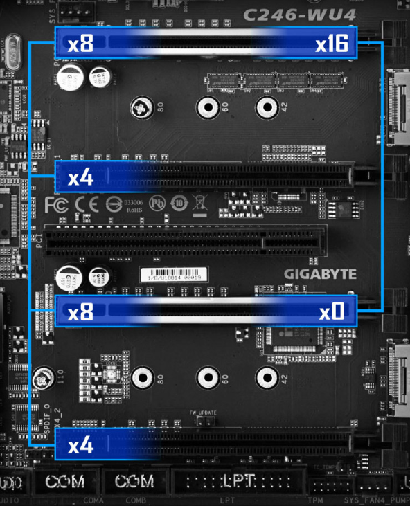

So do you guys think I can run my Quadro 2000P on a 4x slot and swap my cards like this:
Slot 1 PCI x8 - LSI Logic SAS 9201-16i PCI-e 2.0 x8 SAS 6Gbs HBA Card
            M2A x2:    - N/A  (PCIe Gen3 x2 /SATA Mode! - x2 = half speed? 1750MB/s) - Share BW Sata port 3_1 not available? (Not in use)
Slot 2 PCI x4 - Nvidia Quadro P2000 (VCQP2000-PB)  (Manage with only x4 lanes?)
Slot 3 PCI x8 - Intel Ethernet Converged Network Adapter X710-T4 (RJ45 4x10GbE LAN) - Need two for pfSense router & two for local LAN
            M2M x4:    - Samsung MZ-V7S2T0BW 970 Evo Plus SSD [2 TB] (PCIe Gen3 x4) - SHARES BW with PCIEX_4x below (should be ok! not big impact)
Slot 4 PCIEX_x4 - Intel Pro 1000 VT Quad Port NIC (EXPI9404VTG1P20) - SHARES BW with M2M (4 x LAN for XPenology)
I've read folks using those video cards down to 8x, but nothing about 4x.  If anything, the card will register but you won't be getting anything close to the potential of that card out of it.
Just from card specs alone, you really need another 8x slot at minimum.   If anything, everything will probably work.  The Nvidia card will probably not give you the potential it has due to the limited lanes it's riding on.  Motherboard selection was the first thing that I spent weeks looking at to ensure that if I wanted to expand capabilities in the future, I have bus speeds and lanes to support them.  10G NIC is a good example of it.  I'm using a Asus M.2 Gen 2 NVME adapter that holds 4x NVME cards.  It needs 4x4x4x4 PCIE slot, which my motherboard supports.
Just some things.  We can chat here or in PM's if you want.  Hopefully my thoughts are helpful.
Thanks for all your input!
Seem I can go one of two way's now
1) Remove the P2000 and use the built in IGU for encoding instead (Speed/QA?) that would free up a PCIe x8 slot for one 2x10GB x8 card)
2) Go back and look what the cost would be to upgrade the server (More PCI slots and total of 64x instead of 32x) and more than 64G ram)
Always come down to "Time" = $$$ 😫
