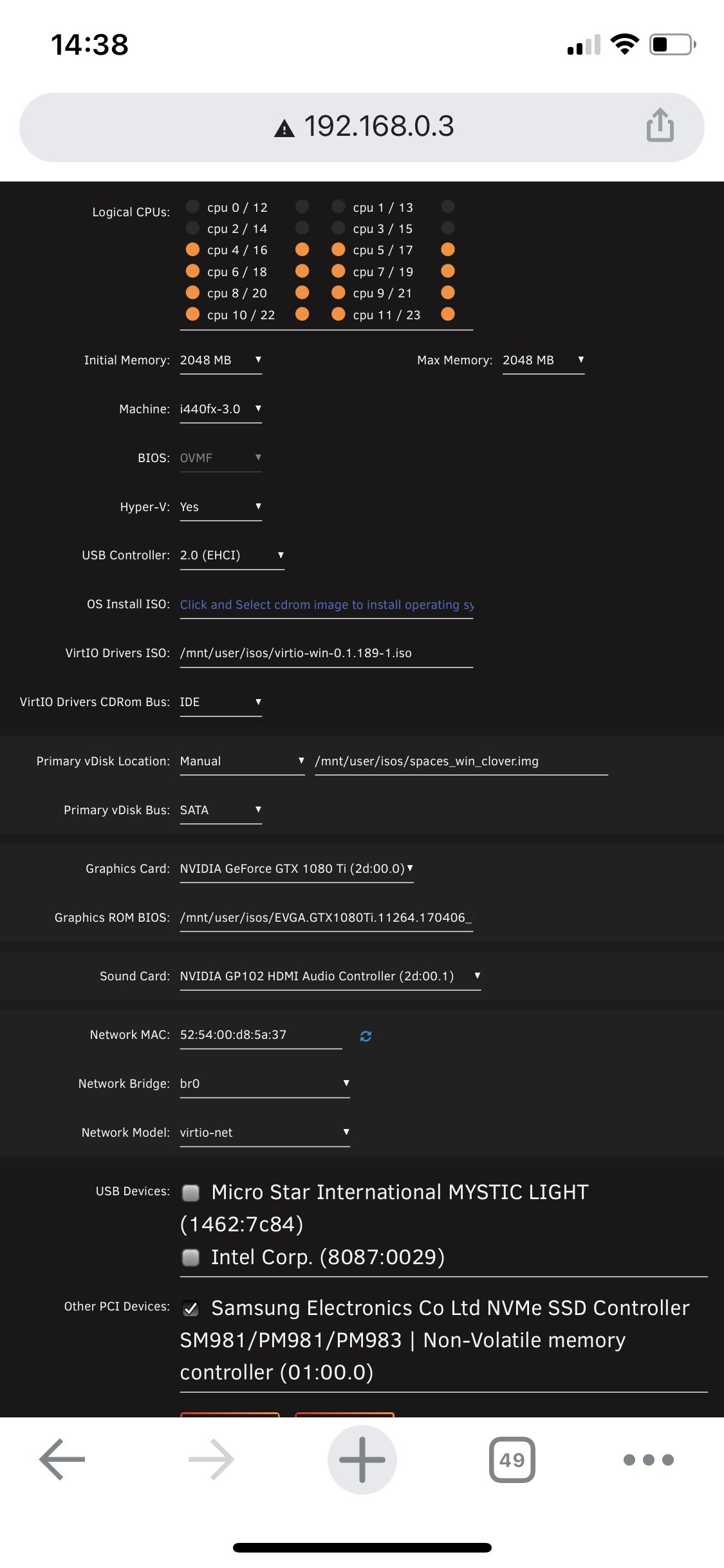

Not having much luck with this, the clover download file (spaces_win_clover.img) won't open, No Mountable File systems aparently (OS X 10.15.6).
You have to assign this IMG to the first vdisk.
Envoyé de mon HD1913 en utilisant Tapatalk
Ah yes, you’re right. Unfortunately it just sits on the Clover boot loader screen and does nothing.

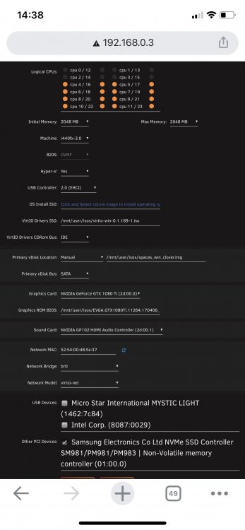

Me i have this.
Thanks for that. Seems broadly similar to mine, from what I can make out.

For the clover i put virtio not sata. Maybe this
That didn't work. I thought I had got to the bottom of it when I realised taht selecting my Samsung 960 NVME booted up windows from my Samsung 970 NVME, bit weird.
So I wiped and clean installed Windows 10 via USB on to each drive seperatly while the other was out of the machine and tried. One ends up in the power shell interface when trying to boot as VM, one ends up with the Start PXE over IPv4 error I have above.
Both boot fine baremetal.
I now also have tried another mobo ( Aorus x570 Elite) and have the same issue.
Driving me crackers 😆
This is all on Unraid 6.9 beta 30, as this was needed for the drivers for the 2.5gbps lan devices these boards have.
Driving me crackers [emoji38]
Look your private message
Thanks for the offer to help.
Your first tip eventually sorted it for me.
I've managed it with Clover after reformating windows again, now works, but only for one of my Samsung NVMes. Very odd.
