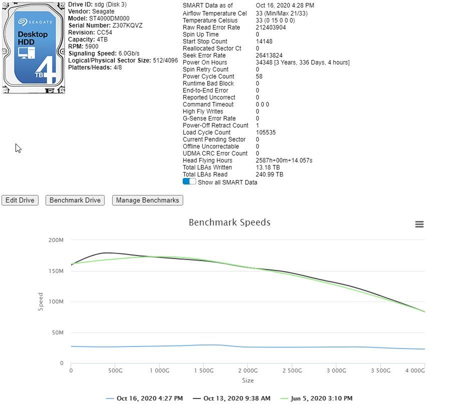

One of my drives suddenly just slowed down.  It is operating at about 10% of what it was doing yesterday.  I ran a diskspeed test, and the graph shows the impact.
The logs attached will show that I also have a cache drive problem due to a bad cable, but this seems unrelated, as all of my other array drives are affected.

With no error messages anywhere, I wonder if it's the drive, or if the problem is in the controller/cables/driver...
I guess I can remove it and test it in another system.

Very unlikely, but easy to test, just swap cables with another disk.
