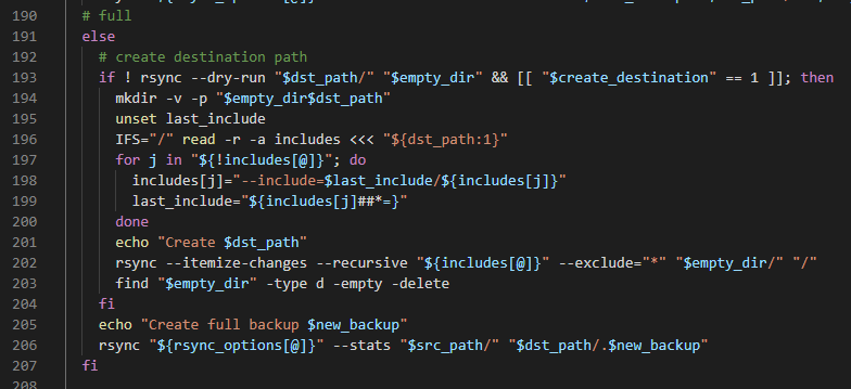

@Meles Meles With version 1.0 I will add a solution which creates the target path through an rsync hack if it does not exist:
As you can see it requires enabling the new setting "create_destination" (enabled by default).
In addition I totally changed the source/path settings as follows:
Now the user needs to set the full destination path for each backup job individually (which is automatically created if it does not exist). And thanks to this change I could completely remove the replacement path thing. 😋
I will test the new version and release it in a few hours.
Version 1.0 released:
# - Allow setting "--dry-run" as rsync option (which skips some parts of the script)
# - Create destination path if it does not exist
# - Fixed wrong minimum file count check
# - Fixed broken recognition of remote "mv" command
As announced the script creates the destination directory, now. And it is possible to test the script by adding the rsync option "--dry-run" which disables all "mv" and "rm" commands.

But I'm facing a problem: Let's say the user creates a backup of the path "/mnt/user/Movies". By the above example, it would fail to stop the container "91b65a1fcb95e0" as it uses the "different" path "/mnt/disk5/Movies" (which is not different in the Unraid universe as we know).
The only idea I had is to ignore the subdirectory and check for /mnt/*/Movies instead, but I'm not sure how this would result in a problem if my script is used on a different OS?!
Depending on how you code it, surely the worst case scenario is you stop additional containers at the same time unnecessarily, right ?
I would think it is an edge case, so the small performance/efficiency penalty would only be felt by a minority.

Yesterday I had another idea. I'm creating backups of my clients every hour. The creation is really fast as it adds a handful files and then creates the hardlinks locally and done. But deleting all these multiple backups of one day is really slow on the next day. In addition it needs to wake up the HDD on every backup as the hardlinks are created there instead on the cache (which is logical).
Now I thought about adding a differential backup feature. So at first it creates a full backup and if already a full backup of the same day exists, it creates only differential backups. But this makes restoring all files more complicate for the user as they need to restore the full backup, then the differential backup (as it contains the more recent files) and finally delete all files which are inside a third folder (rsync calls it the backup folder). Could be too complicate for some users I think 🤔
Another "problem" is that the user opens the most recent differential backup folder and does not see all files he probably expects as they are in a different backup folder depending on their last modification time.

Failed backups start with a dot in their name. Like ".20220203_125314" is a failed backup (or still in progress).
