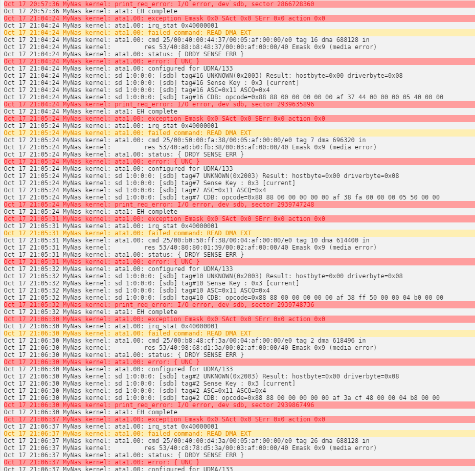

The log is spammed with these errors between 10% and 20% of drive capacity
The drive is sdb / ata1.00
The pre read zone 10-20% was slow due to these errors.

So based on this being used in two totally independant servers, the errors must be the drive. The questions I have are.
1) is the disk actually good? the errors seem to reduce with usage. Is this part of some early life adaption process?
If this was just some early life behaviour then I'd rather keep it and it's a He10 rather than junk it or attempt a return.
Currently there are no 'faults' to return it for.
2) Why do these errors not show up in SMART / Preclear, there are the same errors between the servers at the same points.
Given there were originally SMART 001 errors when the drive was part of the array, I am suprised not to see them now after the read failures.
3) I have some more drives to pre-clear, feels like I need to keep a close eye on the logs as well as just rely on SMART/Preclear
Does anyone have any experience of anything similar?
Interested in your thoughts.
