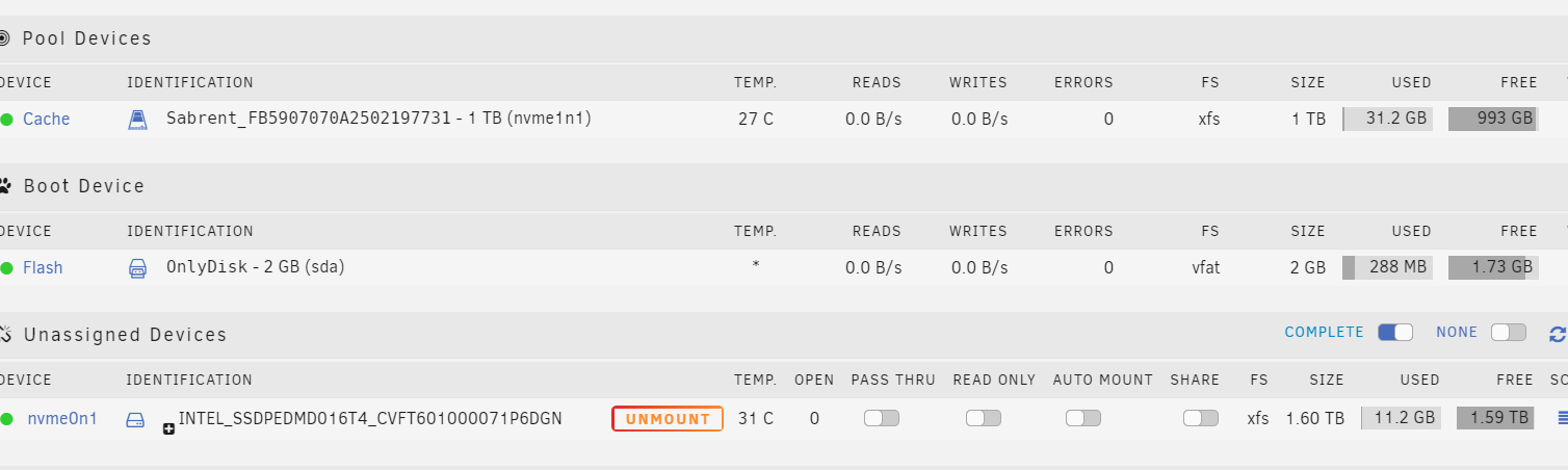

I bought a intel SSD drive to replace my current Sabrent SSD as cache drive. Originally I did not know the proper way to migration cache drive.
So, I stopped the array, removed Sabrent and added Intel SSD, restarted the array, it did format the drive and everything started.

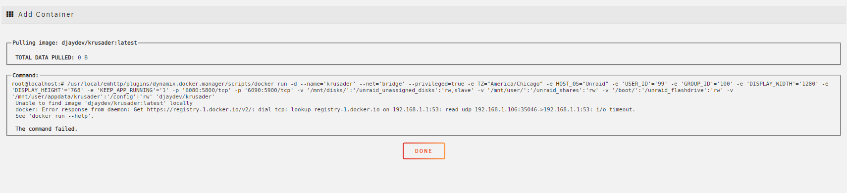

Then I begin to notice, some of apps are not functioning properly. lost all figuration in pi-hole, thus no longer able to connect to internet, stop pi-hole currently fixed my issue with internet connection. plex also very slow after cache drive change. So I moved back to the Sabrent as my Cache drive again, but it seemed I am already too late.

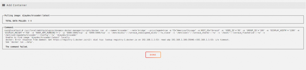

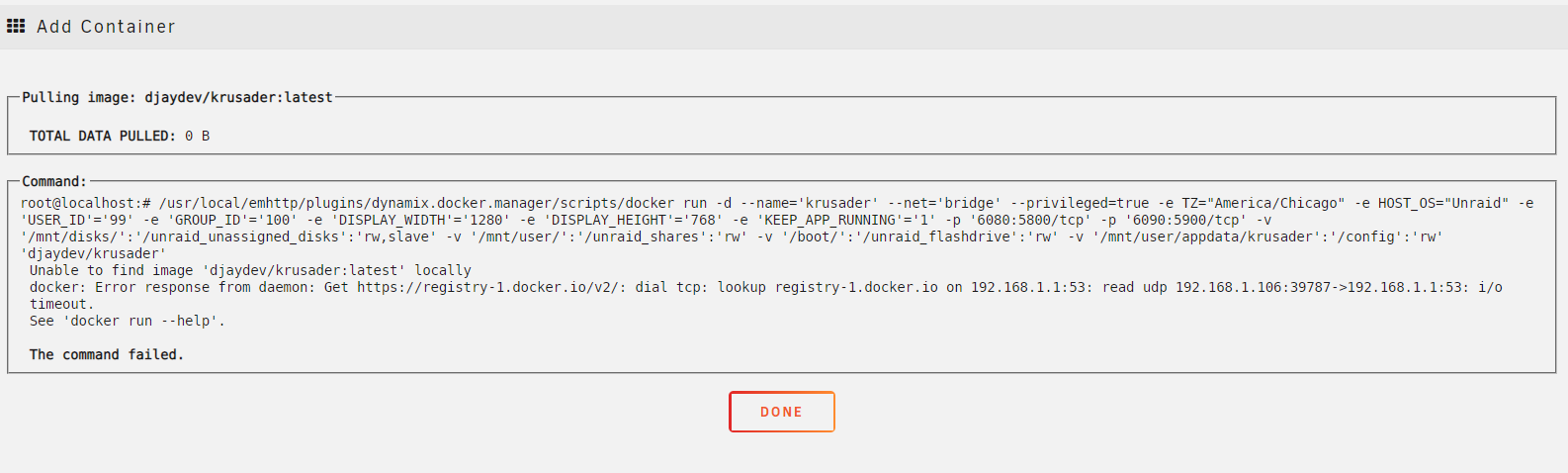

I search through forum, and see I need to download Krusader app to do a proper 'move'.  But I can't install the app. Also tried other apps, most of them won't install anymore.  from the error, they all looking for a image to install locally, but nothing is available.
Did I corrupt the cache drive?  Is it possible to fix this? If not, what option do you I have left?
Thank you all in advance!

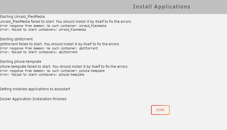

Ok. I deleted the docker image, and recreated it. Then to the Previous Apps to install applications. all failed.
Anything else I can try? Otherwise, how do I rebuild it?
zerg-diagnostics-20201021-2132.zip

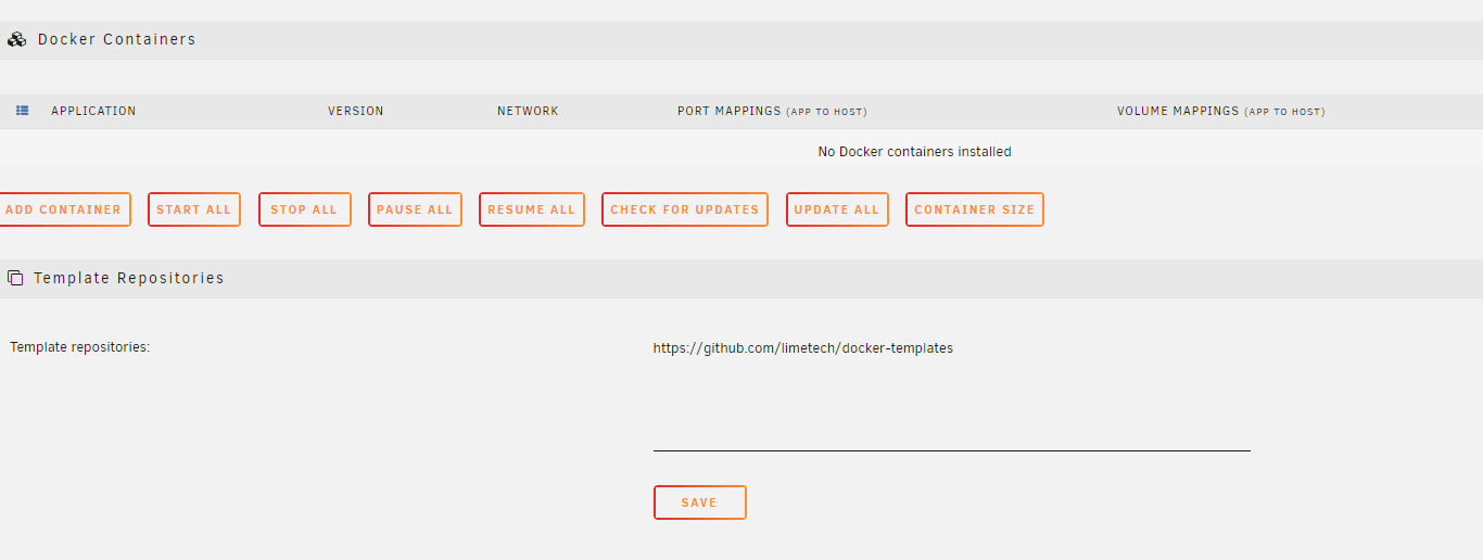

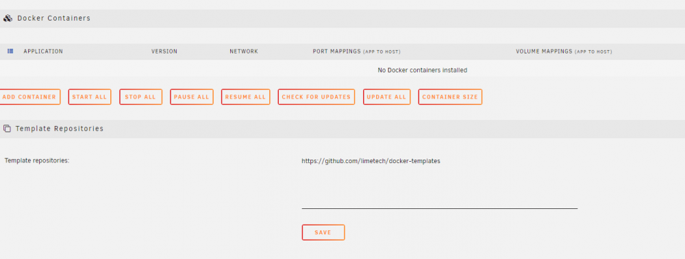

After this, I have no container left, tried to install app manually, same error as my previous reply.

Are you sure your server can reach the internet?
oh, maybe I still have the pi-hole setting in the router, let me get rid of the dns first. be right back.
lol. that's it. all container are downloaded, probably just need to re-setup pi-hole.
Thanks! easy answer, but tough to troubleshoot. Thanks! Guys!
