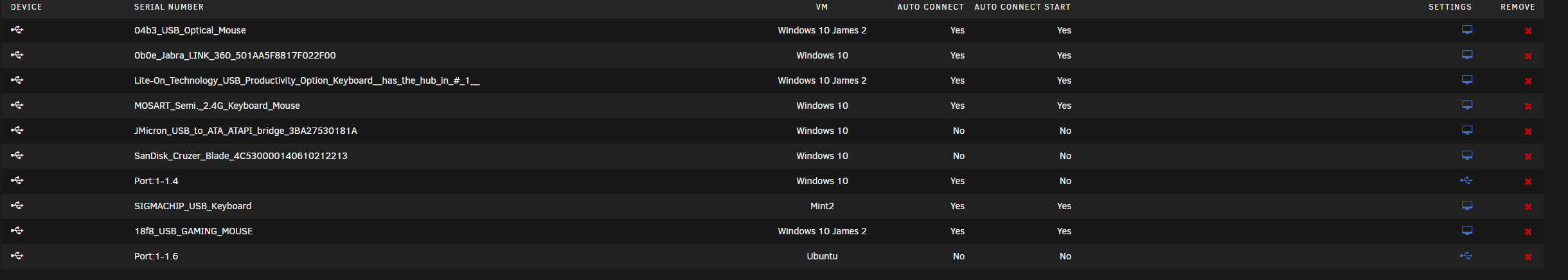

Got it. What i'm actually looking for is to passthrough an individual usb port to VM. What i'm trying to do is build a 2 user rig in 1 and passthrough all needed devices including usb such that should the user need usb ports they can use the ones on the monitor. Issue is your plugin doesn't list the empty usb ports on the monitor unless there's a device connected to them & of which doesn't work with a usb hub.
I don't know if u follow?
Yes understand.
Can you provide a lsusb -t
If you connect a device it should show the port and you should be able to create a map for that port.
Plan was to create a topology view just not got round to it yet.

How would i go about port mapping? I'm new to this☺️
With a USB device
Click on the USB icon and add the port mapping.
When you disconnect the device the port mapping will remain and connect that port to the VM when a device is plugged in if you set the Auto option in the mapping.

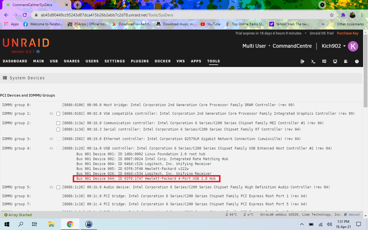

Can you provide a list usb and screen print just so I can see want the Screen hub looks like?
