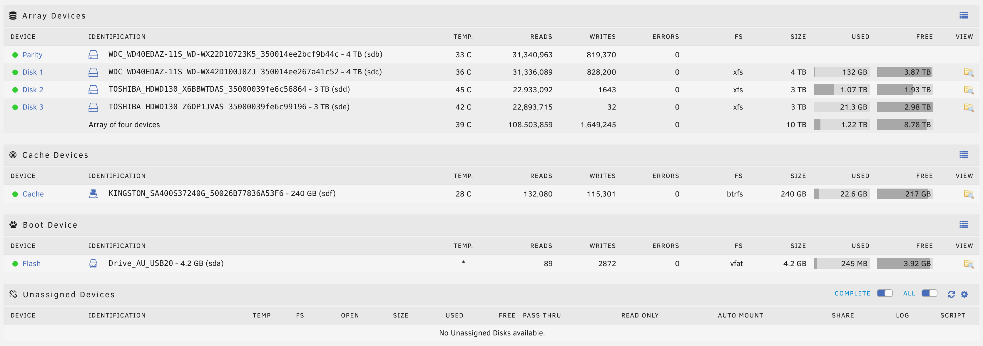

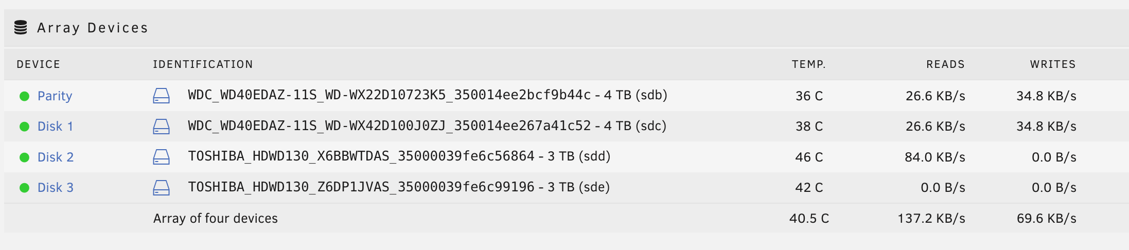

I have a Dell T320, Xeon [email protected], 20gb ram. I have three disks, two are 7200 rpm and one is 5200rpm. Fourth disk is 5200rpm and used as parity. I have a 240gb SSD connected as cache. All are hard-wired via SATA internally. (Older machine, honestly not entirely sure which version of SATA it's running.)

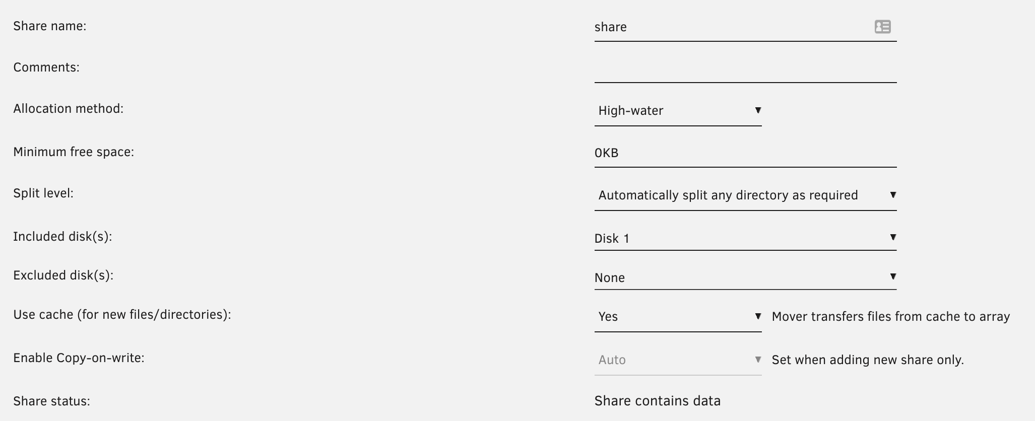

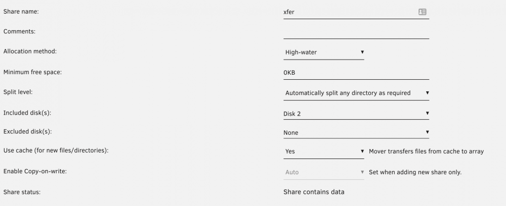

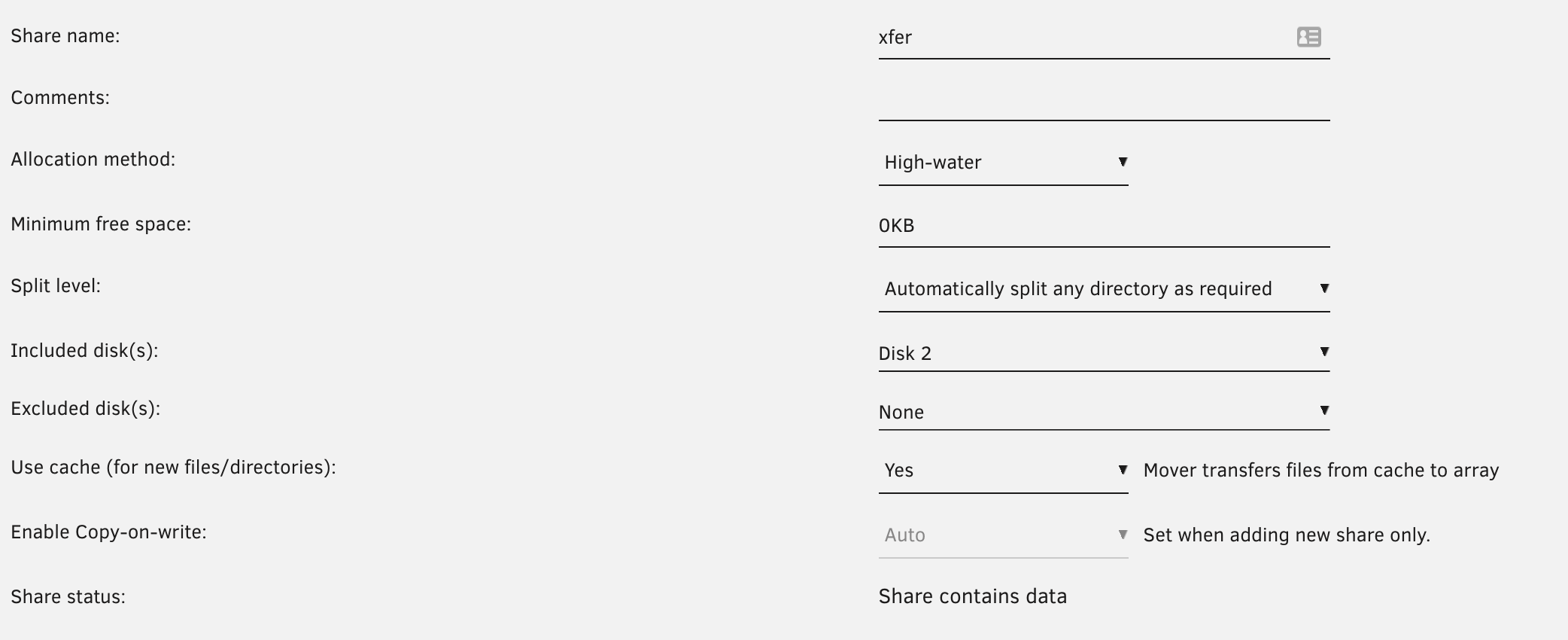

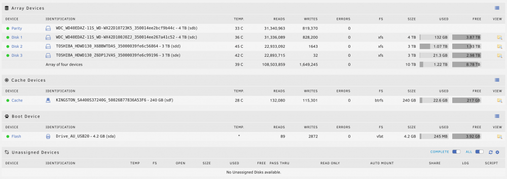

I have two shares, one called "xfer" and another called "share". All data on "xfer" is on Disk 2 and "Share" on Disk 3.

I am moving data via Windows Explorer/SMB between each share. Transfer speeds are varying between 500kb - 5mb/sec.
I'm not sure what my expectations should be in this case, but that seems awfully slow.
What are best practices for transfer speed? Should I not use SMB?

Array disk to disk transfers never were very fast with Unraid, worse since it's not possible to use turbo write, still 5MB/s is on the low side, unless it's mostly small files, if you're using Widows 10 SMB is fine since the transfer is still done locally, you can post the diags during a transfer to see if there's anything there.

Diags show writes going to disk1 at about 30MB/s, that about right for array disk to disk transfer.
@JorgeB thank you!
If that's the case I'm confused as to why Windows shows it going at 850-1200kb/sec right now?

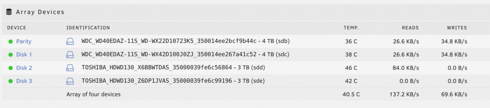

Enable speed stats on Unraid and check speeds there, but Windows speeds should be accurate, Unraid speeds can also go up and down, I can only see the speed at the moment the diags were captured.
Toggle is on the top-right:
Thank you, I didn't know about that. It's showing the transfers in the KB/s range.
Are those large files?
No. Approx 18k files across 6.3gb.
