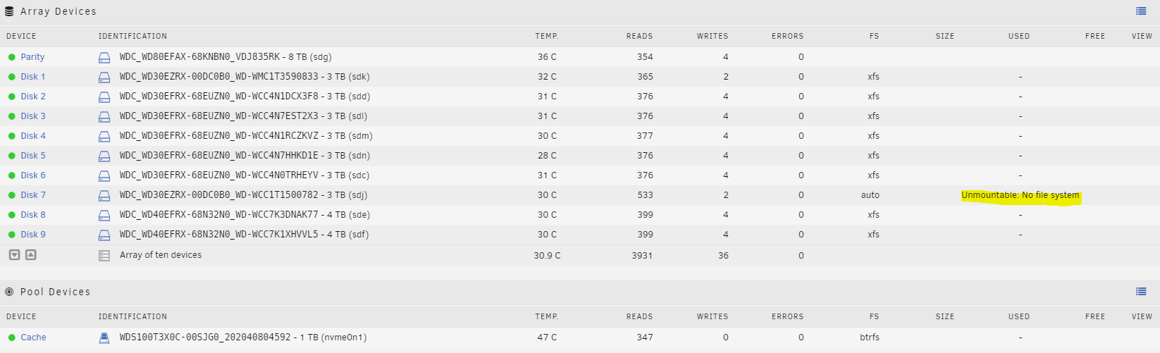

It looks like the file system on that drive has been wiped. It's not XFS like my other drives, it says 'auto'. The data should still be on there though (this is a media server, nothing super important is stored).

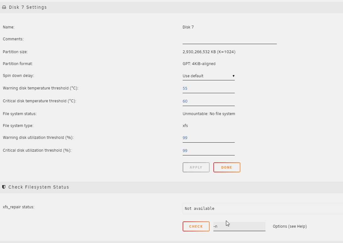

I don't have the option to 'check file system status'. I can see it on other drives that are in my array, but not the drive that I need to try it on.
Did you stop the array and restart it in maintenance mode?
You can also do it from the command line, see other parts of that wiki I linked. You must be sure to repair the md# device and not the sdX1 partition or parity will be invalidated.
Yep it's in maintenance mode, I think it may be because the file system is set to auto.
Can I stop the array, set the drive to XFS, then try a repair?

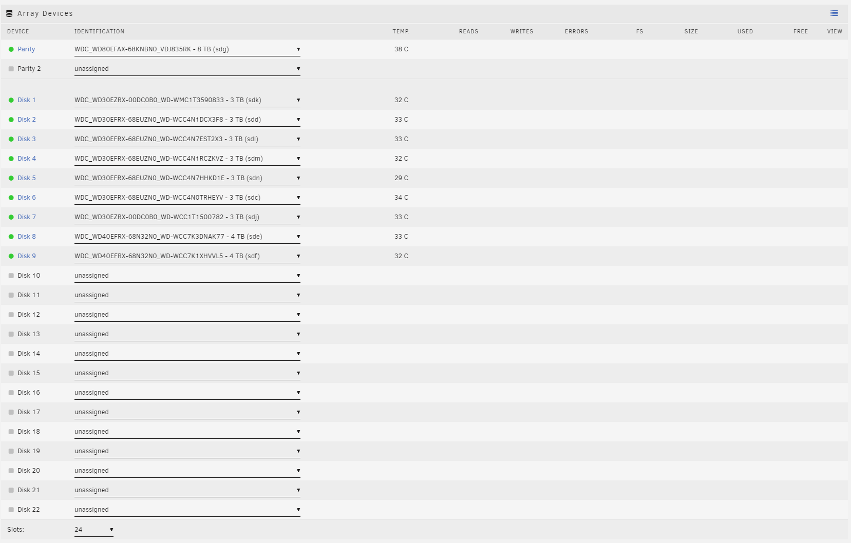

Are those new disks you added in the array now? Did you add them to new data slots in the array?
Did you preclear them? Or did you let Unraid clear them after adding them? How did they get formatted?

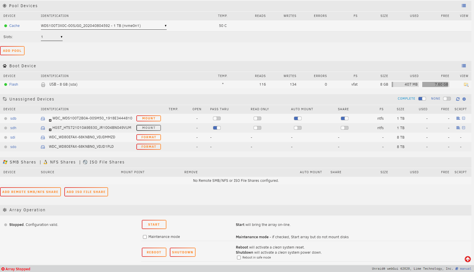

The disks have not been added to the pool. They are just unassigned devices. They haven't been precleared or formatted.
When I did a new config, I chose all existing drives that were previously in the pool, no more, no less.

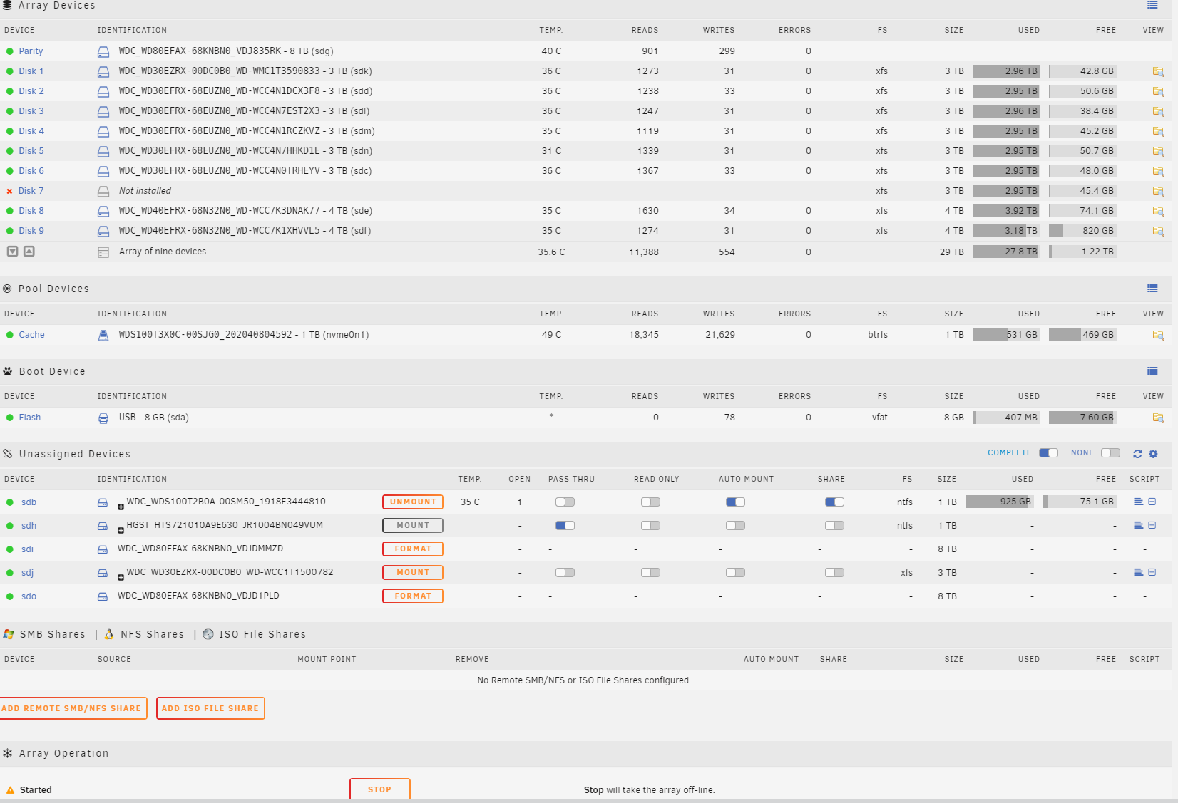

Post a screenshot of Main - Array Operation.
The two 8TB drives under unassigned are the new ones.

Have set to XFS, now I have that option, so will proceed with the repair.
Cheers
When I press the check button nothing happens, looks like the data in the drive may no longer be viable...

Stop the array
Unassign the disk
Start the array in normal mode to see if the emulated disk is mounted. Whatever is emulated is what would be rebuilt.
I'm not seeing that it says anywhere that it's being emulated, but I can browse the data on that drive as if it's there, so it looks like it is being emulated?
Actually when I hover over the drive it says - device missing / disabled, contents emulated. Great.
